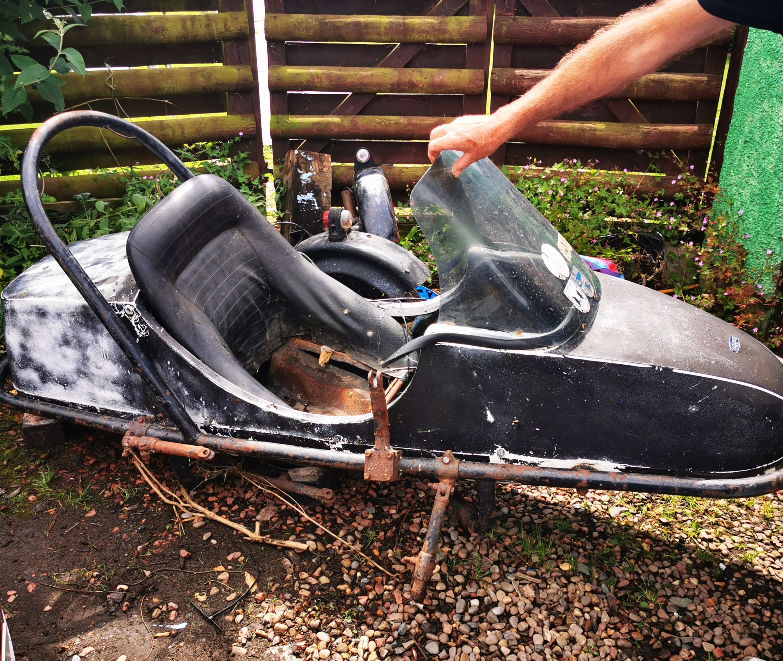

Hi folks looking for a fitting kit or attachments to install a sidecar to my electra x.
Pic is of sidecar as I got it. Its now stripped and painted any advice very much appreciated. D
Watsonia sidecar squire.

That appears to be Squire sidecar, (Or a Velorex) it also appears you only need the four fittings for the Electra X frame.
I suggest sending the picture to Watsonian -Squire tell them what bike you want to fit it too, and they should have the fittings in stock. ( You need to measure the holes on the end of the fittings on the sidecar to determine if the are 7/16th or 10mm)

As the fittings you want me be unobtainable from Watsonian-Squire due to obsolescence your next port of call is I suggest here:-
http://simplysidecars.co.uk/sidecarfittings.html

Your sidecar is a Squire (the clue is the Squire badge) I believe it is a ST1 model having just bought one to fit on my 1960 Meteor Minor I
Squire and Watsonian are now the same company and have a limited amount of parts arable there fitting kits are quite expensive
The sidecar is attached to the bike in 4 places
1/ Top of front down tube
2/ lower front engine to frame bolt Watsonian say they drill engine plates and fit a spacer between the plates
3/ rear foot rest holder as my bike is a 1960 Meteor Minor I have fitted it to where the side stand fits
4/ at the top of the rear shock absorber
