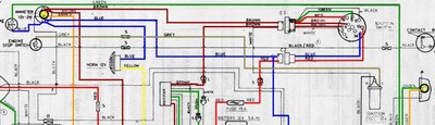

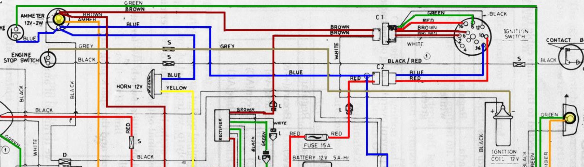

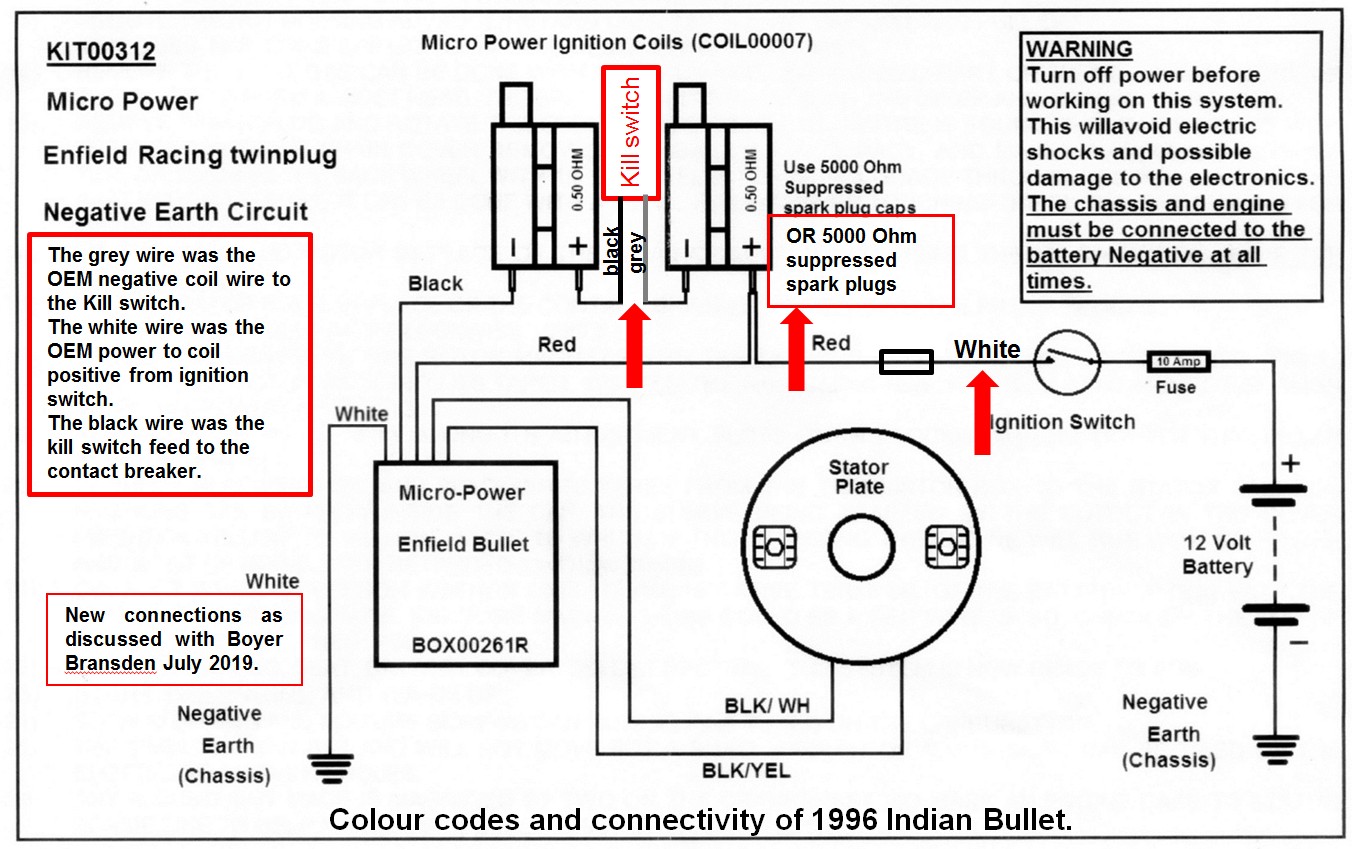

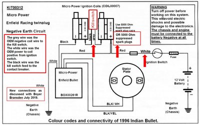

Hi guys. I seek advice on the conversion of my twin-plugged Indian 535cc (1996) Bullet from points to electronic. The BoyerBransden fits successfully in the LHS toolbox and the wires are all long enough to reach their destination. BUT I don’t want to get the wiring wrong. My bike has the usual negative earth, so do I use the original coil leads to connect the Boyer “bluebox” (i.e. positive from ignition switch and negative earthing through the kill switch)? I have posed these questions to them and await an answer but I know that some of you have already done this and could advise.
