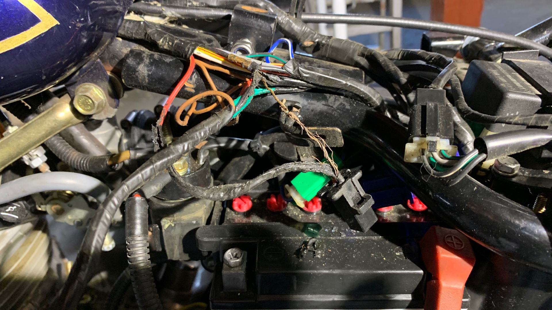

Hi all,
New here on the forum, and I wondered if somebody could help, 'cause we don't have any RE dealers in Denmark, so I'm seeking to pick your collective brains :lol:

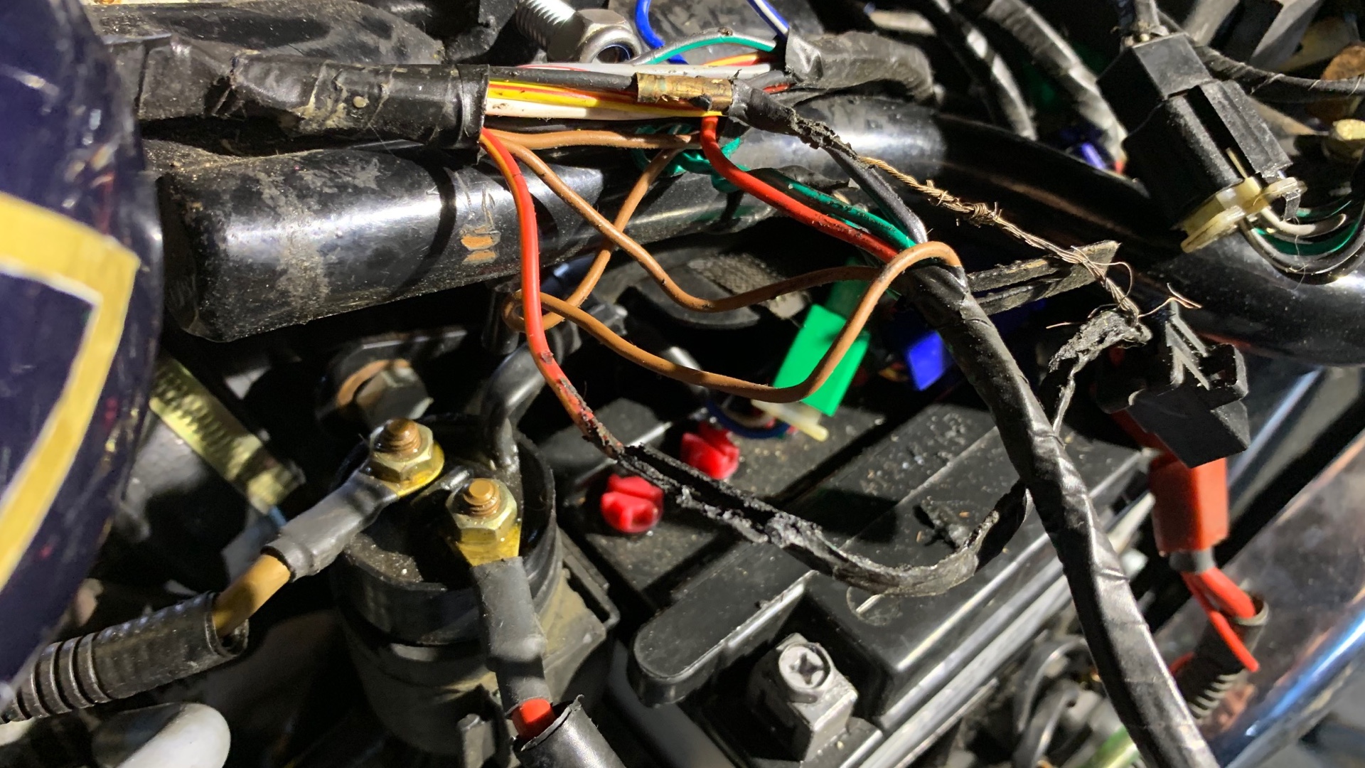

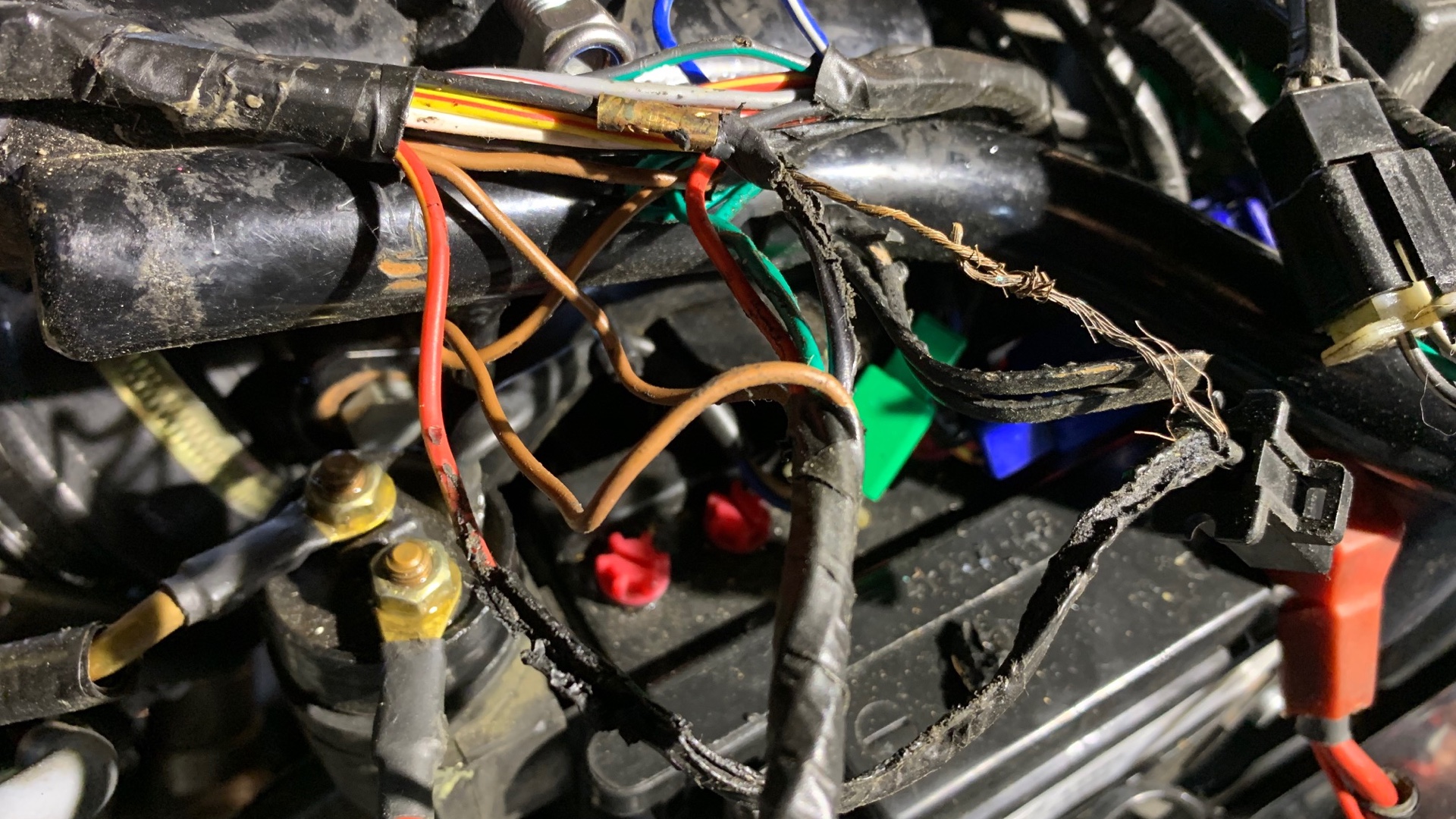

The other day while starting, I noticed the starter motor ran a bit slow, and suddenly smoke emerged from to wires going from the battery to (I presume from reading the diagram) the Ammeter and the ignition key fob.
My suggestion is, that the (Indian made) rectifier somehow gave up the ghost and sent a massive charge via those skinny wires - could that cause such a problem?
I have enclosed a photo of the wires in question.
I have ordered a Boyer Branson rectifier to replace the (assumed) faulty Indian unit, but before I go ahead and mount it, it would be nice if somebody among you could confirm that it indeed COULD be a rectifier problem - or have a suggestion to what else it could be that caused the heated wires ...?
Thanks in advance for any help given - it will be much appreciated
Kind regards
Peter in Denmark

Oh dear! A very sorry sight Peter.
It is possible that a faulty rectifier has imposed a large load on the battery but I think you should investigate a little further before buying any new parts. Can you trace where those wires do lead? Also if you could remove the rectifier, anyone with a multimeter could do a simple check of it for you.
Looking closely at the pictures I think I can see where one of the wires has been joined by just twisting the ends together.
Could be a sign of some previous unskilled alteration.
I will look at the diagram this evening and see if I can make any further suggestions. Meanwhile I'm sure some more experienced help will be along.

13-year old Indian wiring can deteriorate, the insulation on my Electra-X main lead from the battery to the ammeter broke and snapped the wire where it had been flexing around the headstock. Luckily it only cut the power and did not cause a short circuit, but I suspect a wiring fault rather than a reg/rectifier failure, though you might have both!
If the wiring has been botched as ericpode suggests, some time spent with the wiring diagram in the workshop manual and sheck what's on your bike would be a good investment.

Thanks for your replies, guys - much appreciated.
I will dive into things in more details tonight, based on your responses. However, to answer a couple of the questions/comments:
The splicing of the two wires is not just a twisting together of the wires. They are actually kinda crimped together with a brass tube, and the whole thing was hidden in the wire loom (which I have unwrapped) that looked very original - so I suppose it's a factory made thing.
The battery is only one year old - replaced last autumn, and until the wire frying, it has given no troubles at all - in fact I was out on a 20 miles trip the day before the smoking gun hit me, and just parked the bike in the shed for the night but I'll se and the the batt this evening.
I have a voltmeter with Ohm-measuring capabilities -is it possible to check the rectifier off the bike (ie without applying electrical input to it) - just by measuring resistance for example?
I did open the headlight after the 20 miles ride, because the speedo cable had gotten loose at the speedo end - I have checked the wires, and they at first glance seemed ok, but I will go trough them more carefully as suggested when mentioning the ammeter problem.
Well - happy hours to come :-)
Troubleshooting is half of the fun owning an Indian motorbike which mysteriously has found it's way to a country with no dealers, no spares and agent and basically no literature ---- NOT :-)
Hpwever, I have a service manual, and according to that, the two fried wires goes up in the headlamp and connects via the ammeter to the ignition key fob, but I have not traced where it goes from there. The fried wires is the output from the rectifier (the black and red wires from the unit).
Will check the fuse - and also check if it's a 15 A.
Will be back when I know more - in the meantime - keep those suggestions coming :D
/peter

I don't know if it's just me but if you look ate the two wires they only seem burnt at the connector end and the tab from the frame looks like the paint might have worn off in which case the live and earth will be having a party.
I have been doing auto electrics for many years and it's normally a short that causes melt downs
