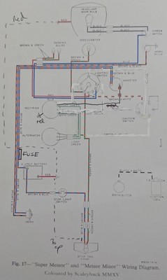

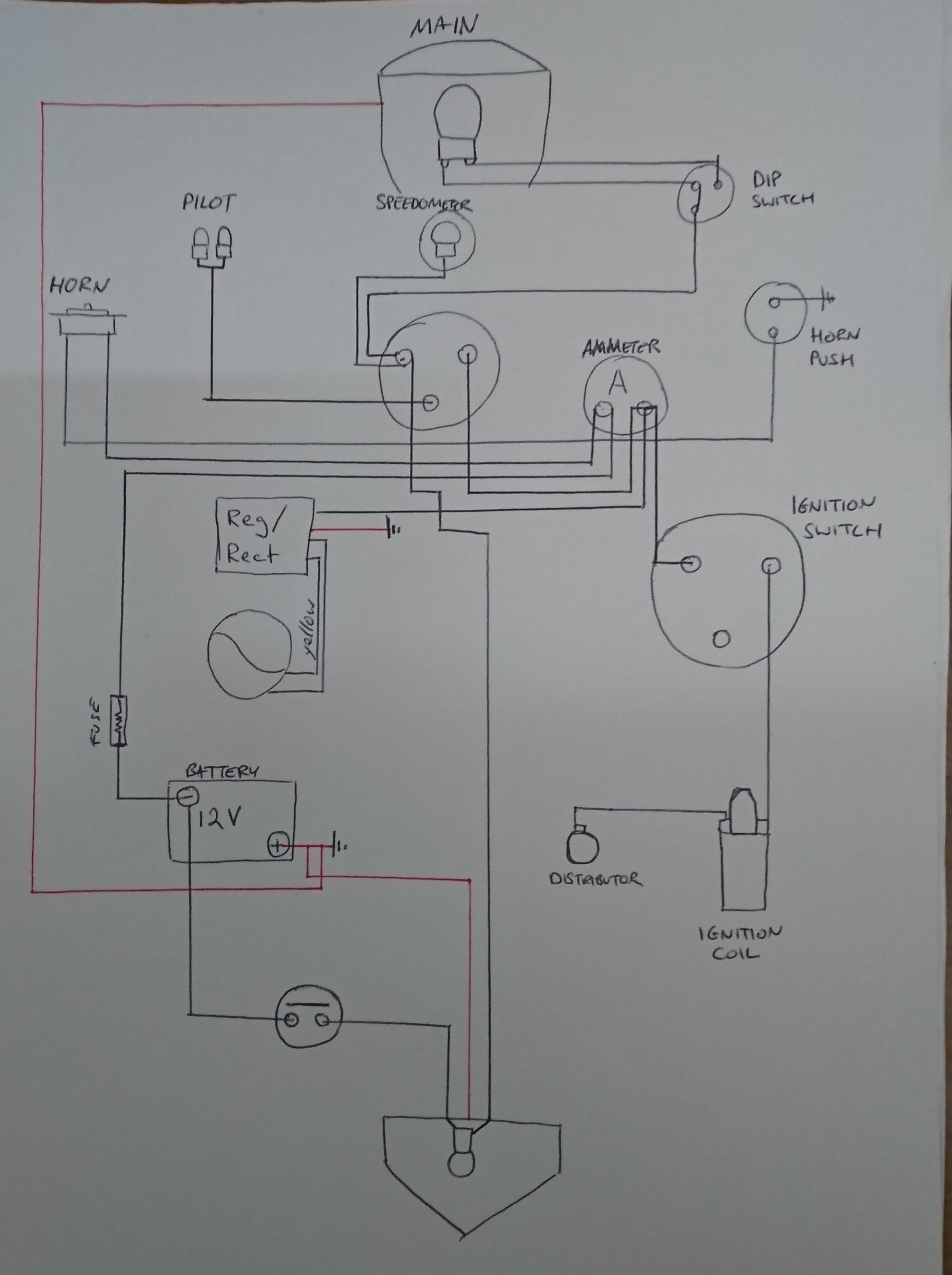

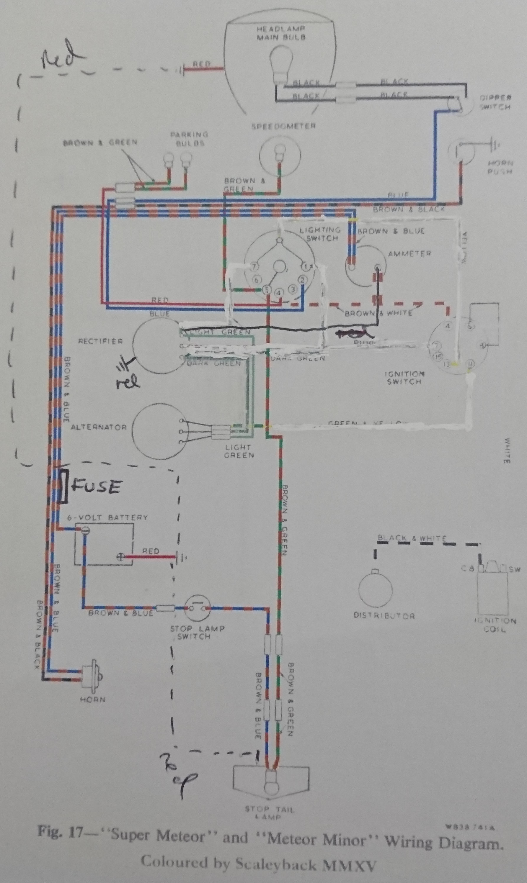

Great! Thanks Adrian and Scalyback for the diagram.
I'm just working on the diagram now. For the extra red wire for additional earth leads from the stop/tail lamp and the headlamp relector unit back to the battery, where should they be connected? Negative terminal on the battery?
