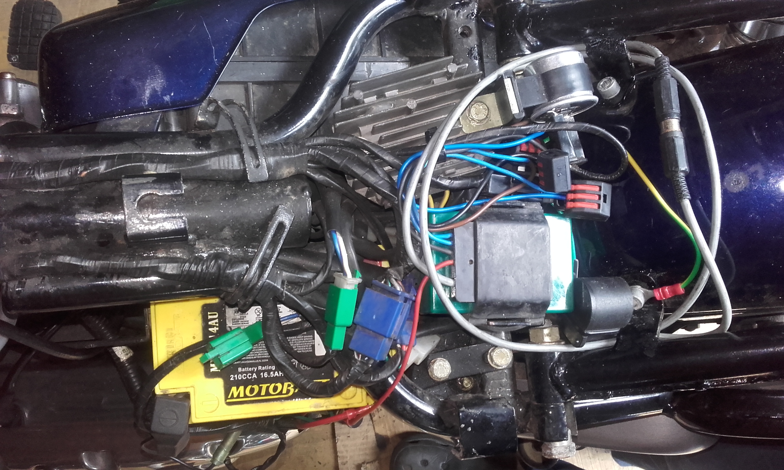

You will see in the pic, have fitted indicator warning buzzer, have just done this while the seat is off, it is not part of the problem.
Have not yet disconnected the flasher warning light yet.
