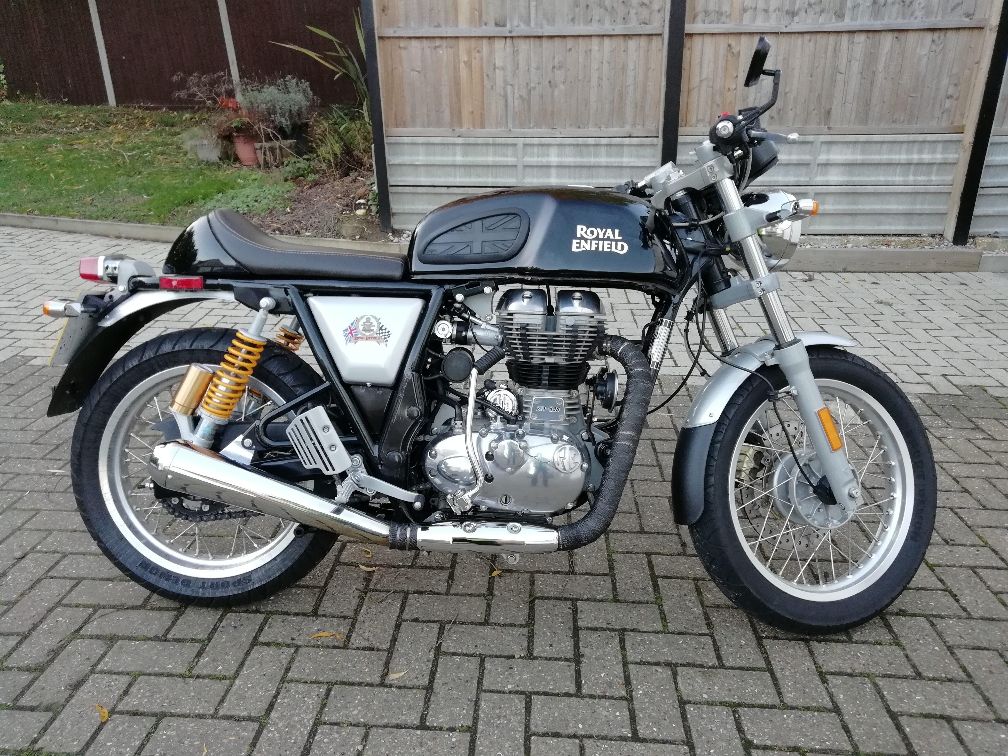

I have a euro 3 bike with stainless exhaust and silencer but that is reverse cone and has a lovely sound .

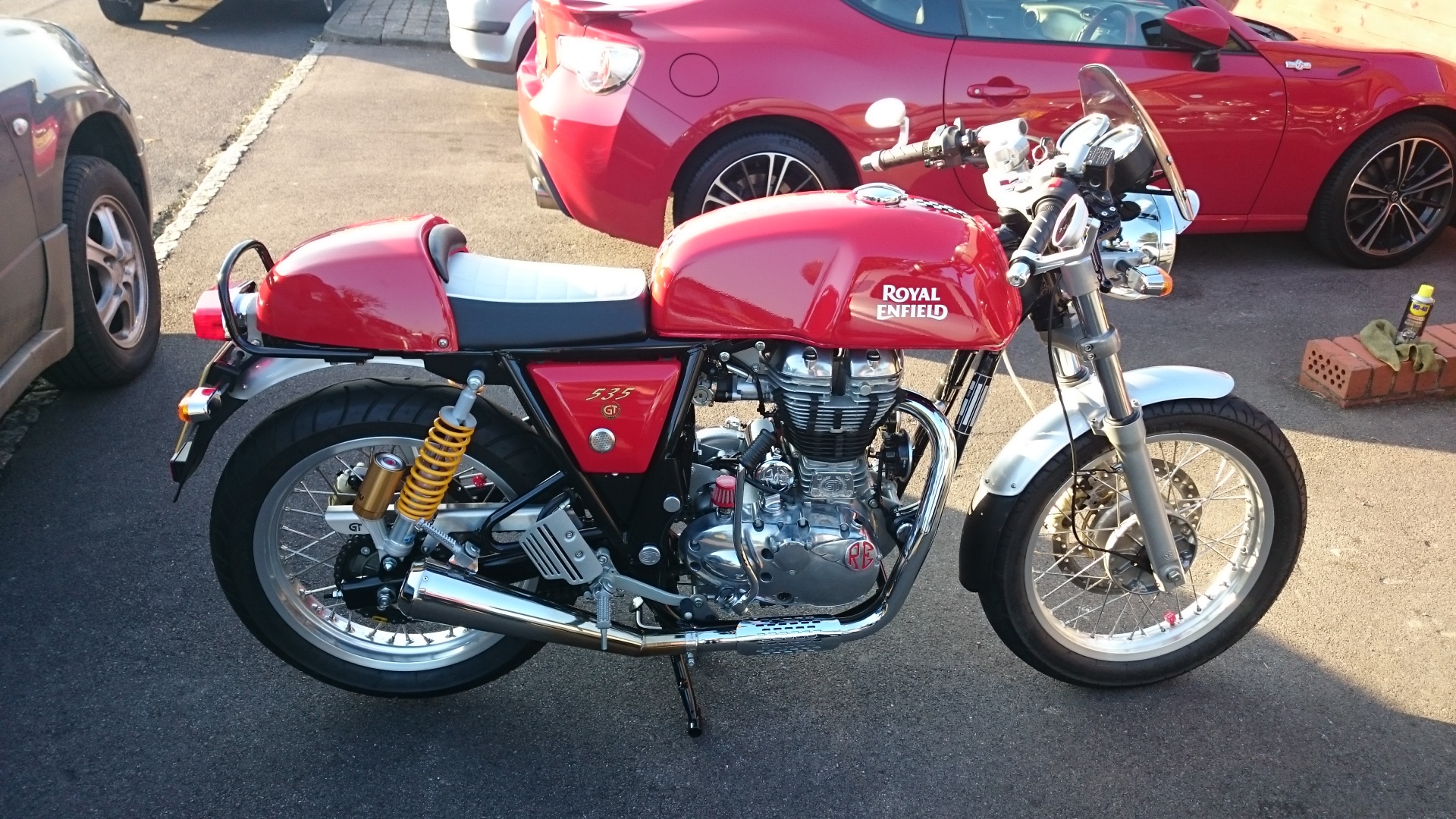

Thanks, your megaphone looks very smaller than mine, maybe I am worrying too much about the noise.
[img]2018-11-11 15.55.20.jpg/img]

I have a euro 3 bike with stainless exhaust and silencer but that is reverse cone and has a lovely sound .DSC_1401_1_resized.JPG

It does not have a Power Commander fitted yet. It has the original EuroIV ECU with Oxygen Sensor (Lambda) still fitted. So performance is presumably being increased over the original stock exhaust, by reducing the back pressure.
Other people have told me that Euro IV ECUs are more complex than the Euro 3 versions and more able to adjust fueling when things like back pressures are varied. I am considering your suggestion of fitting Power Commander but I would like to know if it will still increase power with a quiet exhaust.
