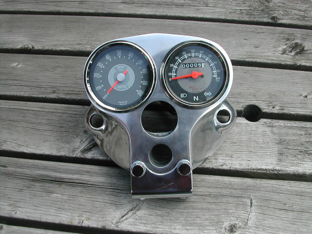

Meanwhile, if you want some spannering while you're at it, and your EFI is an earlier one with threaded fork tops (pre 2012), how about one our hosts' twin-clock alloy yokes to go with it?

A personal opinion, and please disregard it as you wish, but having a full-size rev counter as an external bolt-on extra to the headlamp casquette speedo just looks odd, which is why I suggested one of these from our hosts...
A less expensive solution which I have seen very neatly done would be to replace the ammeter with a 51mm electronic rev counter, needs a few minutes work with a die grinder/flapwheel to open out the ammeter hole in the casquette.
The worst I have seen is a poor Electra-X with twin clocks mounted on Meccanoâ„¢ brackets screwed to what looks like a piece of plywood stuffed into the original casquette. Its owner has been meaning to put it back to standard ever since he bought the bike.
