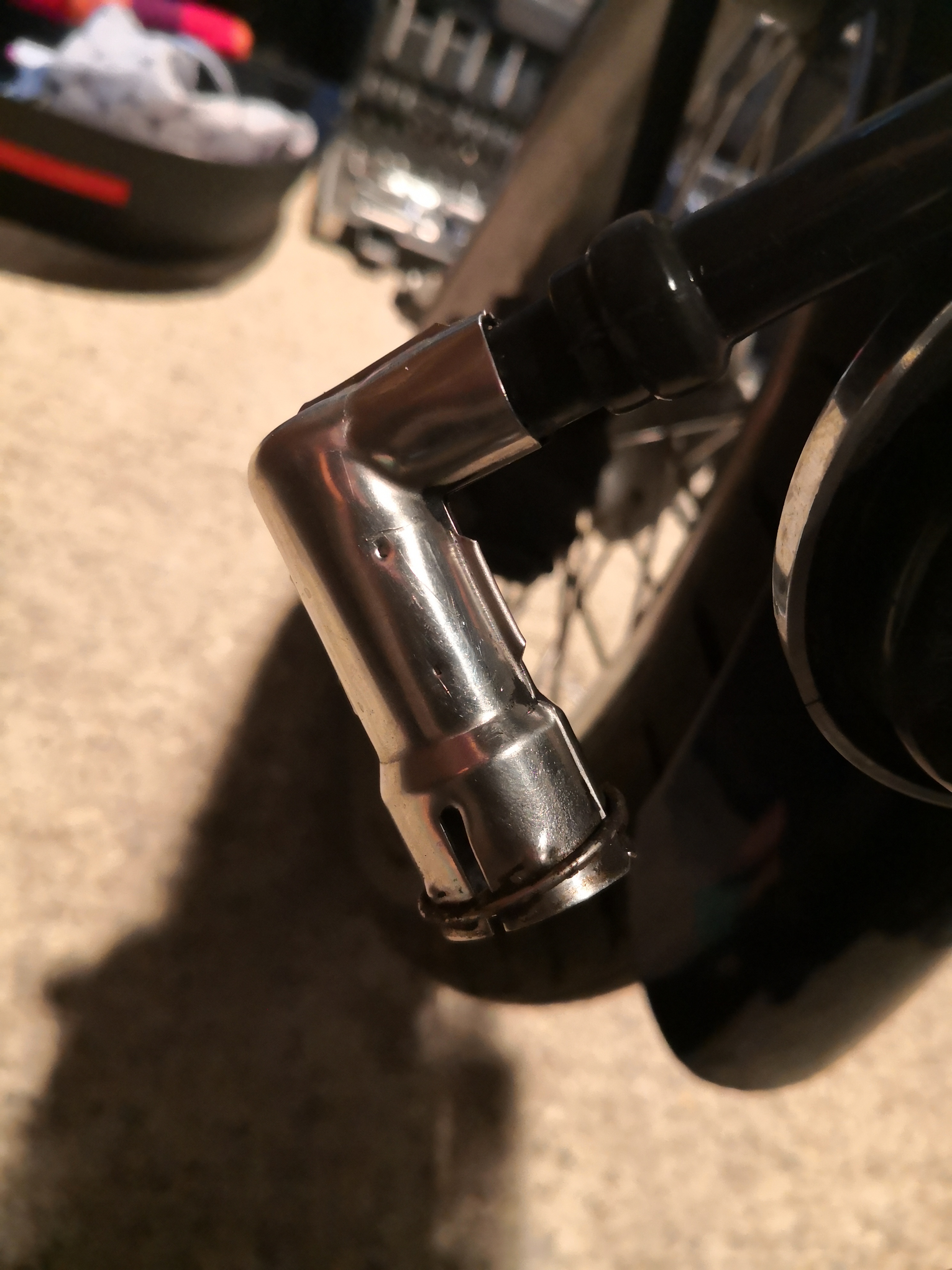

Another addition to the possible causes - does your Electra-X still have its original spark plug cap? Worth replacing with the NGK variety if you (or the previous owner) haven't already done so, the originals can fail. Non-suppressor for resister-type plugs, suppressor for plain plugs. It's still worth doing even if the problem DOES lie elsewhere.

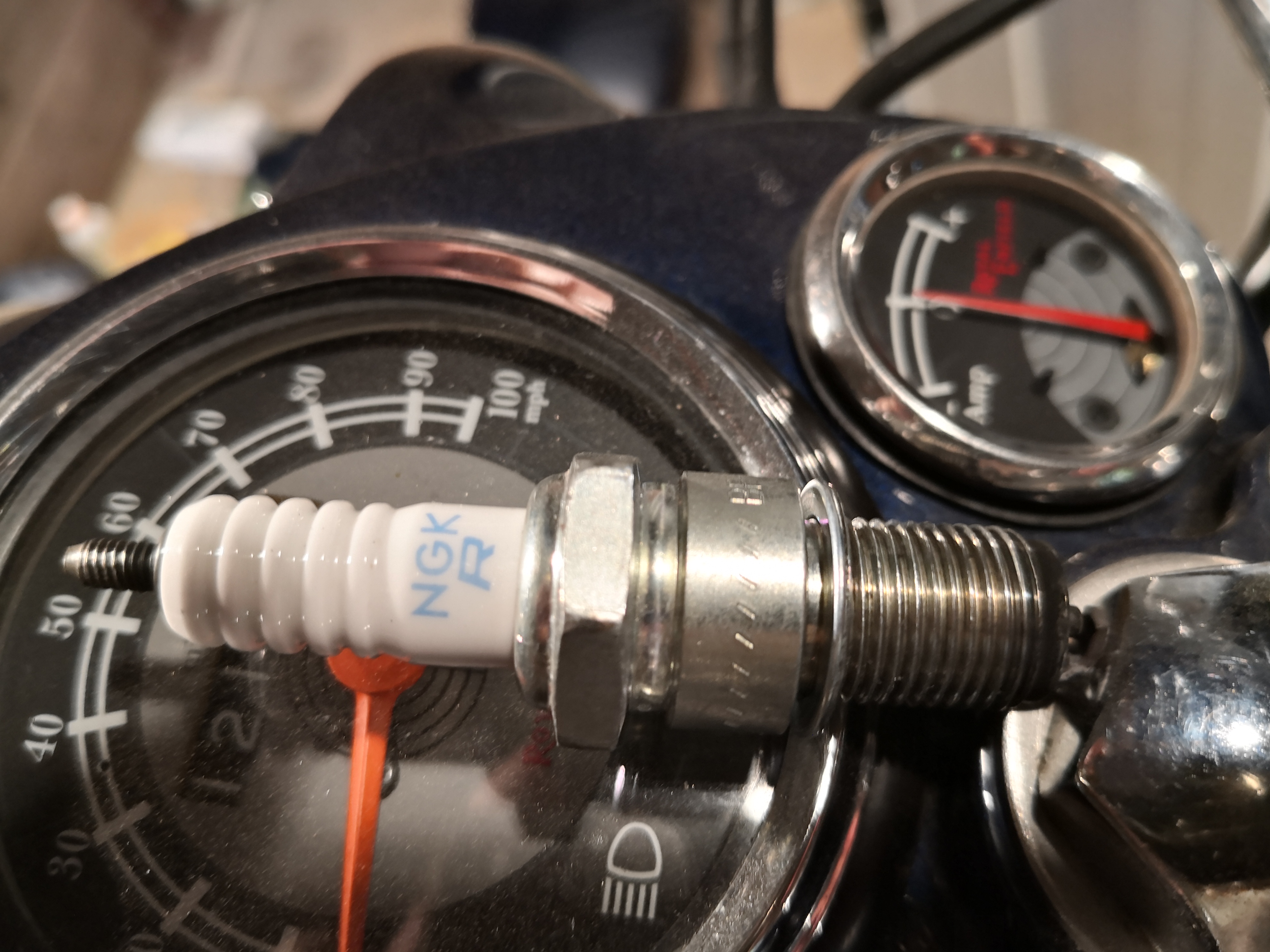

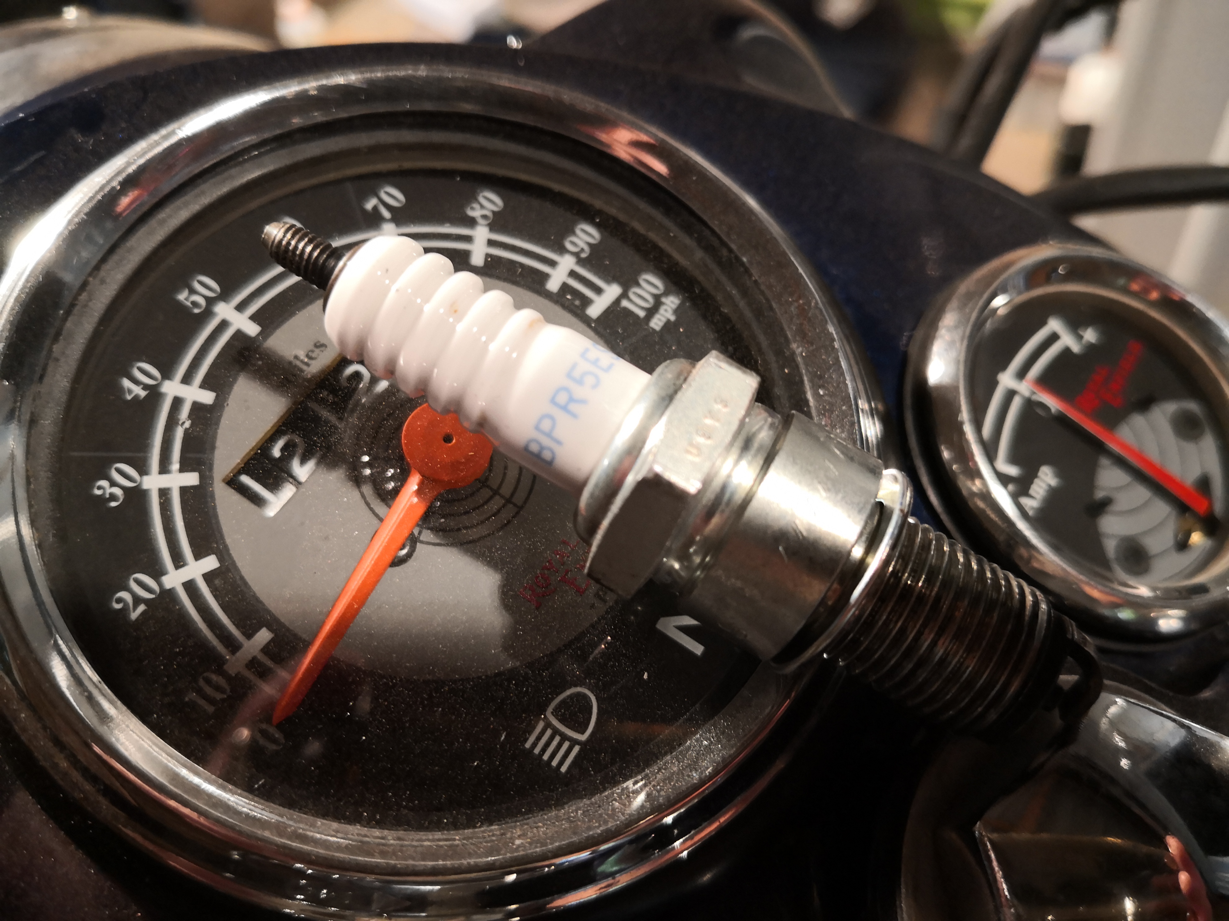

By Enelectrax
#102511
Thanks for the input, though another coil that I've tried isn't the quick fix I was hoping. Did disconnect the sides stand cut off the other evening (as suggested here) though that didnt solve the issue.
Will blast the ignition with wd40 and try another spark plug.
Pics are the cap that is in use and the spark plug in use.
Cheers
