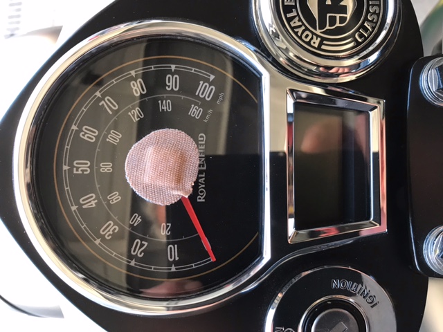

Still have the sticking speedo problem and I'm waiting for a new speedo like everyone else. They say the needle sticks on the glass when hot. The needle seems to be clear of the glass but the black bit it's attached to is not. Decided to insulate the centre of the glass with a round elastoplast plaster. Just been out for a 40 mile ride in the hot sunshine without any speedo problems at all. First time this has happened for months. Will someone else please try this to confirm it's not just a coincidence. (see picture)

Hi, it comes as no surprise, the centre of the needle catching on the glass was a fault on my 1965 indian army bullet original speedo. The inner cable would spiral up and press the needle against the glass . Vince

The fault with the speedo needle is actually easily resolved by switching the ignition on and off a few times until the needle sweeps back to zero. So you are not riding with it showing the wrong speed all the time.
