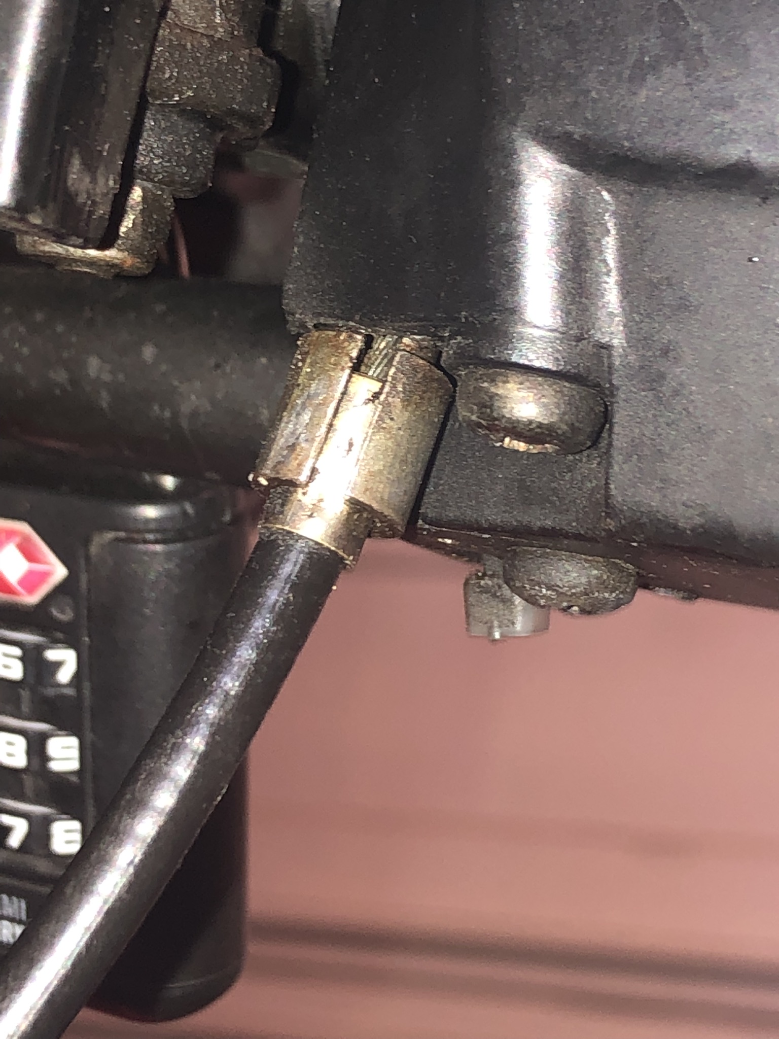

#102412
My bike has the throttle on the other handlebar ;)
Here’s the one on my bike’s decompressor cable:
