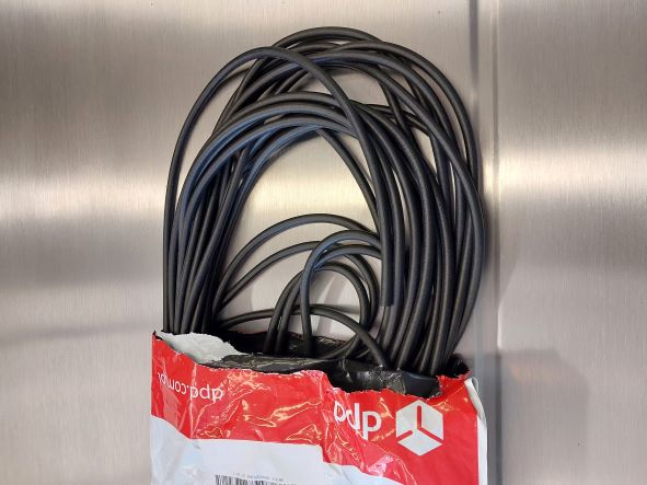

BTW, with all respect to the HM, great shop as they are the chaincase seal they sell is little bit too hard. I am afraid to tighten cover enough to stop leaks.
Instead I am using EPDM rubber string, 6mm diameter, it’s very soft, kind of rubber foam, does the job extremely well and cost about 50 pence per meter, so 1-2 openings and can be discarded.

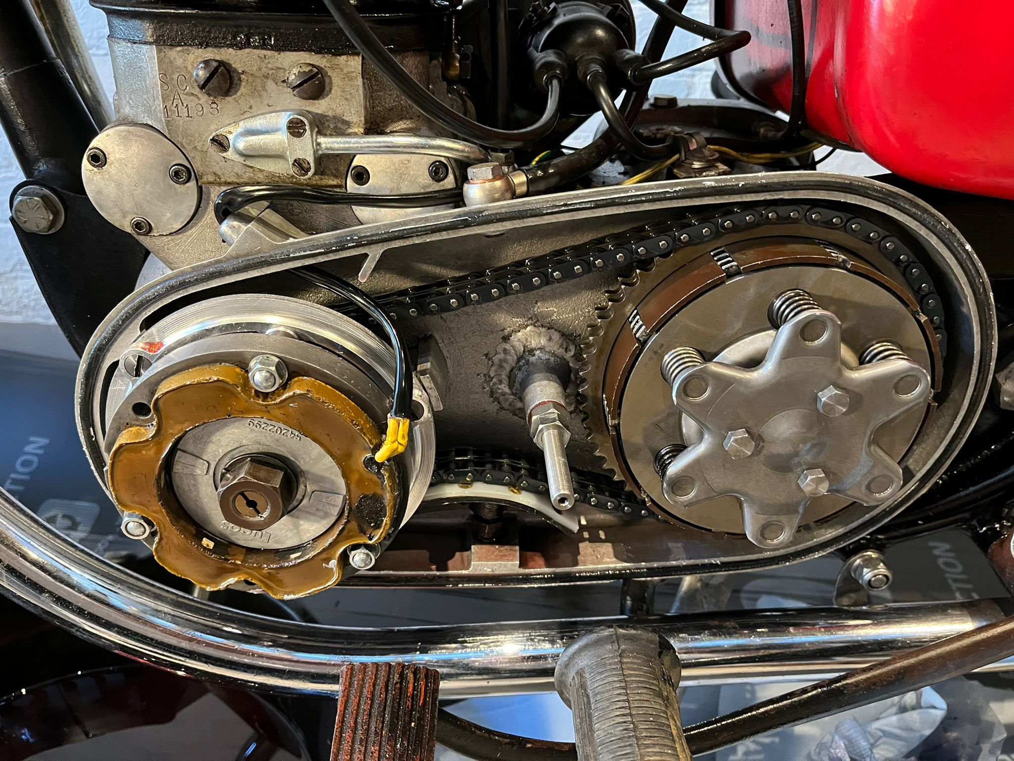

When it comes to the EPDM string - where did you get it from, do you have a photo, what was it like trying to make it stay in place before you fitted the outer case? Mine pours ATF out at the moment so this sounds like it could be a good option for me. I did wonder if the H o-ring was a bit hard and thin for my somewhat warped chain cases.
FYI my chain case breather heads up under the tank, then along under the seat to pop out the back, and with a filter on the end - basically to let it condense out of any airflow and drip back in.
Connie clutch.jpeg (571.07 KiB) Viewed 193878 times

New clutch, new stator, there is something to desire :D
I am buying online, here:
https://allegro.pl/oferta/sznur-gumowy- ... 0521601295
15 meters, 9 GBP including delivery, it's very soft so squeezing with fingers presents no problem, when opening cover, if it stays in the groove-it stays, if it falls -it's get replaced,
No leaks whatsoever.
I used 5mm tap to thread a screw into breather nut. Did a test ride, the amount of oil inside a chaincase hasn't changed so we are in the clear with back pressure. The red stuff is less dense than mineral oil, perhaps this the reason why is so affected by back pressure.

Make sure the EPDM you order is a foam, really, really soft. I did try few different compounds, this is the best.

I couldn't get the EPDM from your link as they didn't ship to the UK. I got some from another source and it was rock hard - I put it on on the off-chance and it was dry as a bone when sitting there - 15 miles up the road and it was a gusher. I've now found another source and this one does say "foam" in the description, so here's hoping.
