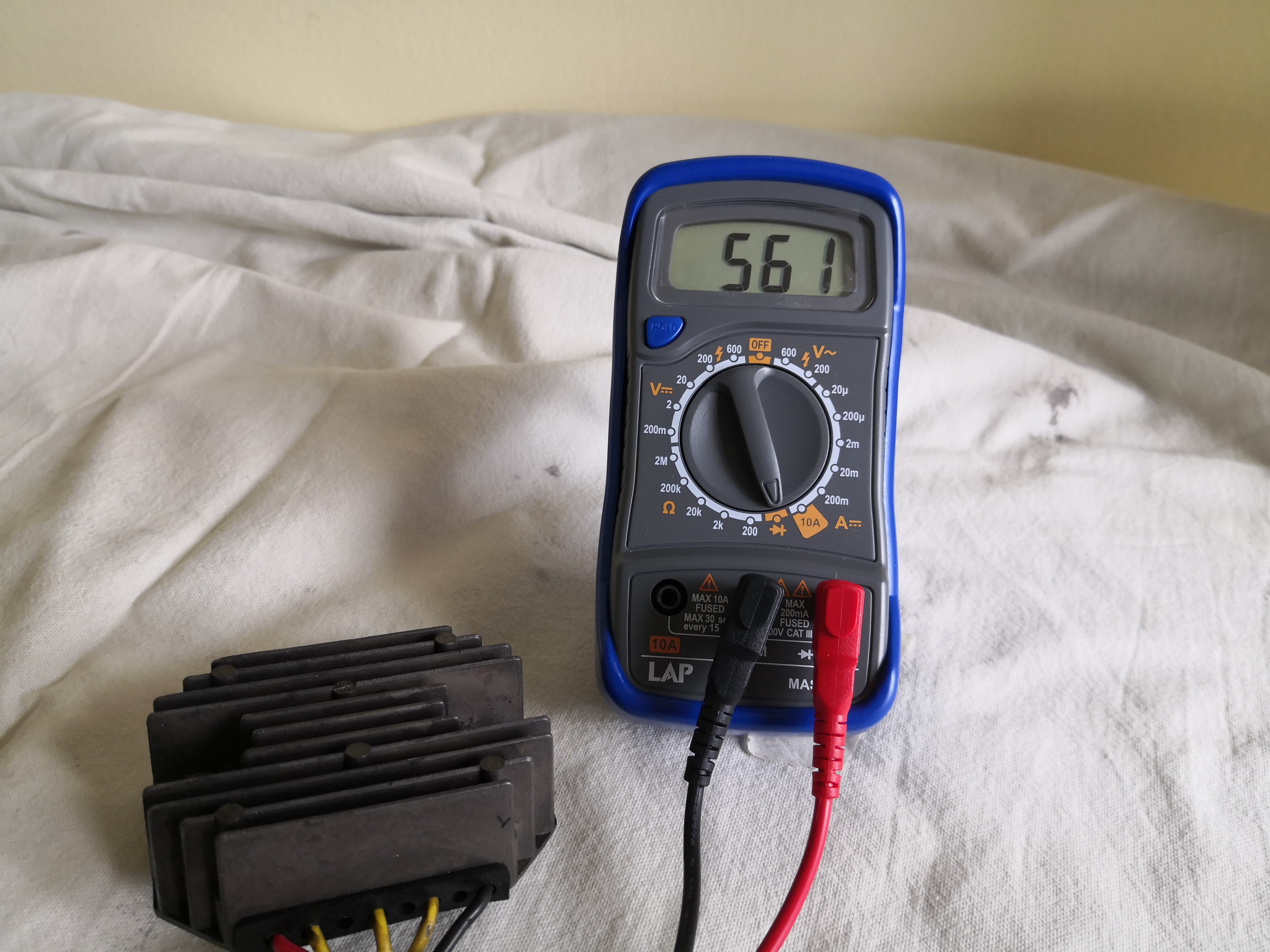

Hello, tested my 3 phase regulator today as I've been have all sorts of electrical issues.
Forward bias test read 561 consistently 3 times
Backward bias read zero consistently 3 times
I just followed a YouTube video to do this can be seen here - https://www.youtube.com/watch?v=-2jWIkhy1fo
Thing is I don't know if those forward bias numbers are a good thing for that Regulator?

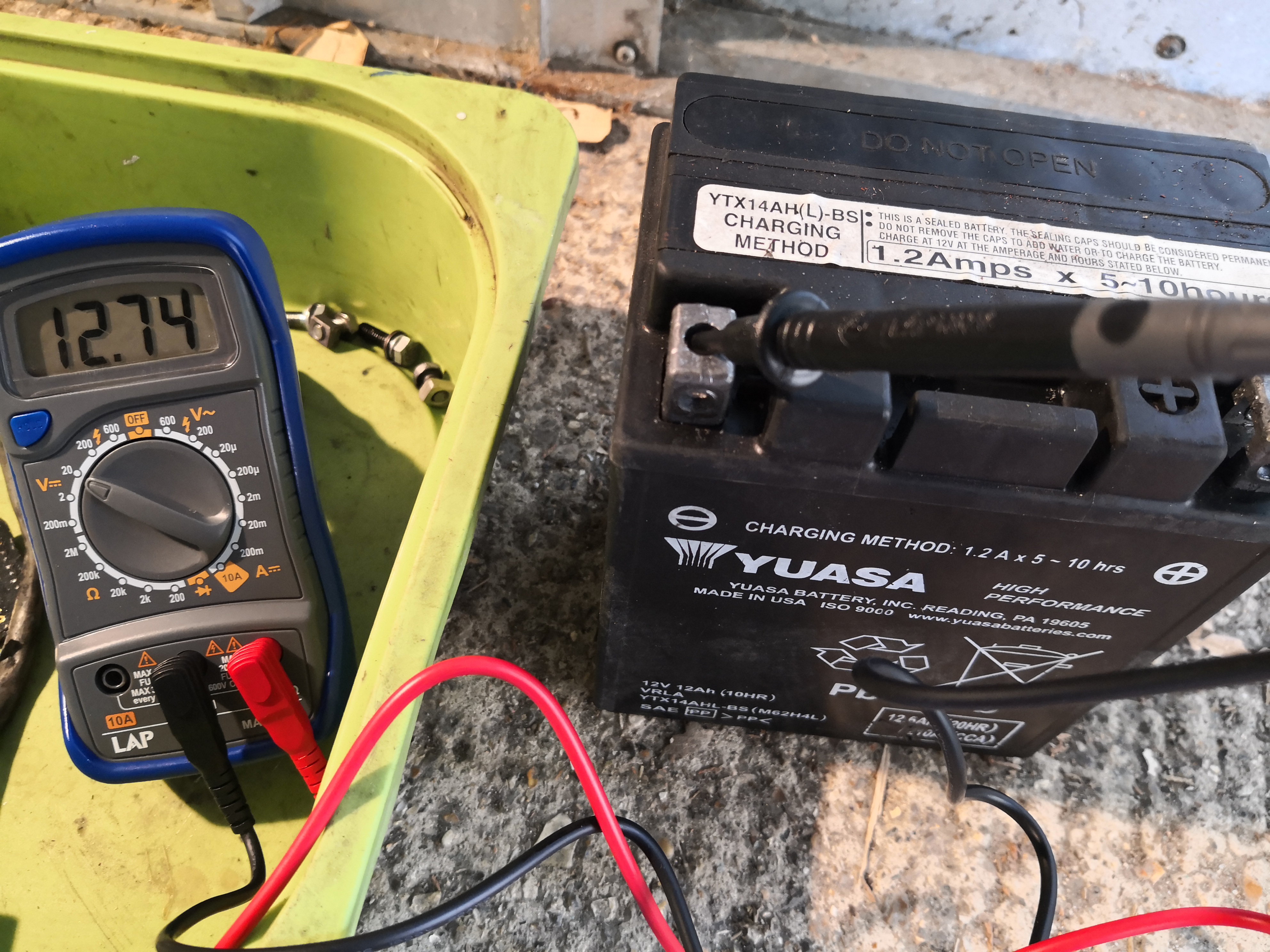

Also tested the battery and reading at 12.74 v does that seem like a healthy voltage?

Battery voltage looks fine
Give the terminals a clean and that should be good
I would put a load tester on it but as you probably don't have one don't worry, looking at the pictures of your wiring it has already had a high load on it

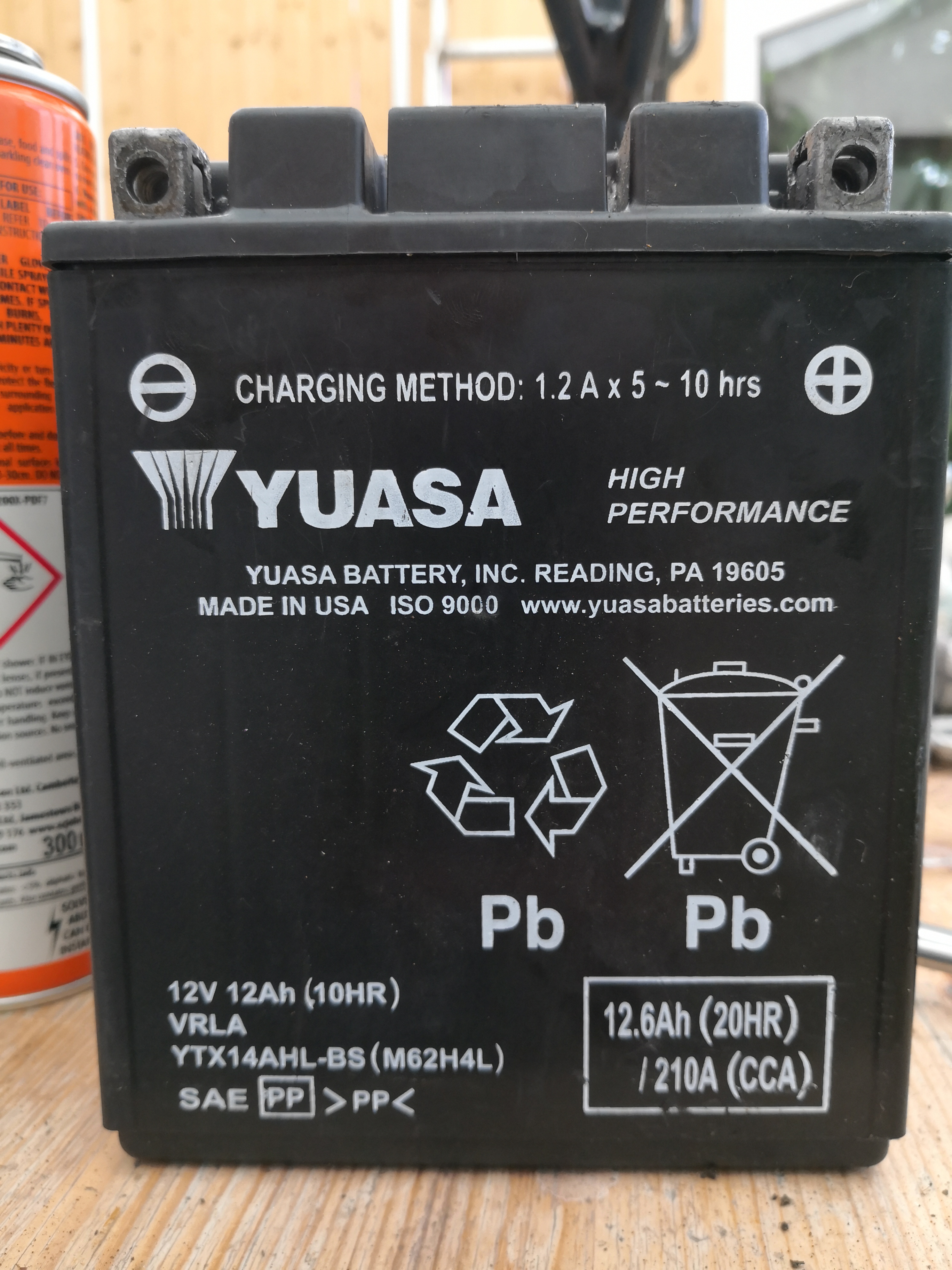

Personally I prefer a Yuasa battery over a Motobatt (I don't like the connections on the motobatt)

Cheers for the info, ok so the numbers just being consistent is a good sign, is there static unseen workings in the Regulator that could cause it to fail?

Not going down the Motobatt route just yet, hadn't considered the Connections.
