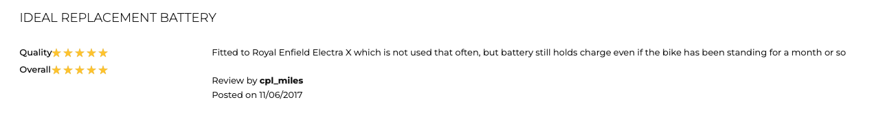

Beezabryan's point about the battery is worth investigating. For the E/S to work well, it needs a REALLY healthy battery. What you can get is a situation where the battery has partly degraded, it will hold enough charge for you to kick start the bike successfully and power all the other electrics satisfactorily, at least with the engine running, but nothing doing when you press the starter button.

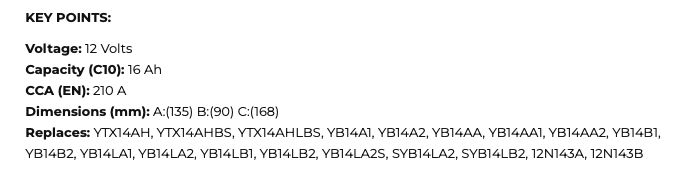

Both the OEM lead acid battery and the one I replaced it with ended up in this state. I finally prized my wallet open far enough for a Motobatt MBTX14AU AGM battery, what a difference that made.
