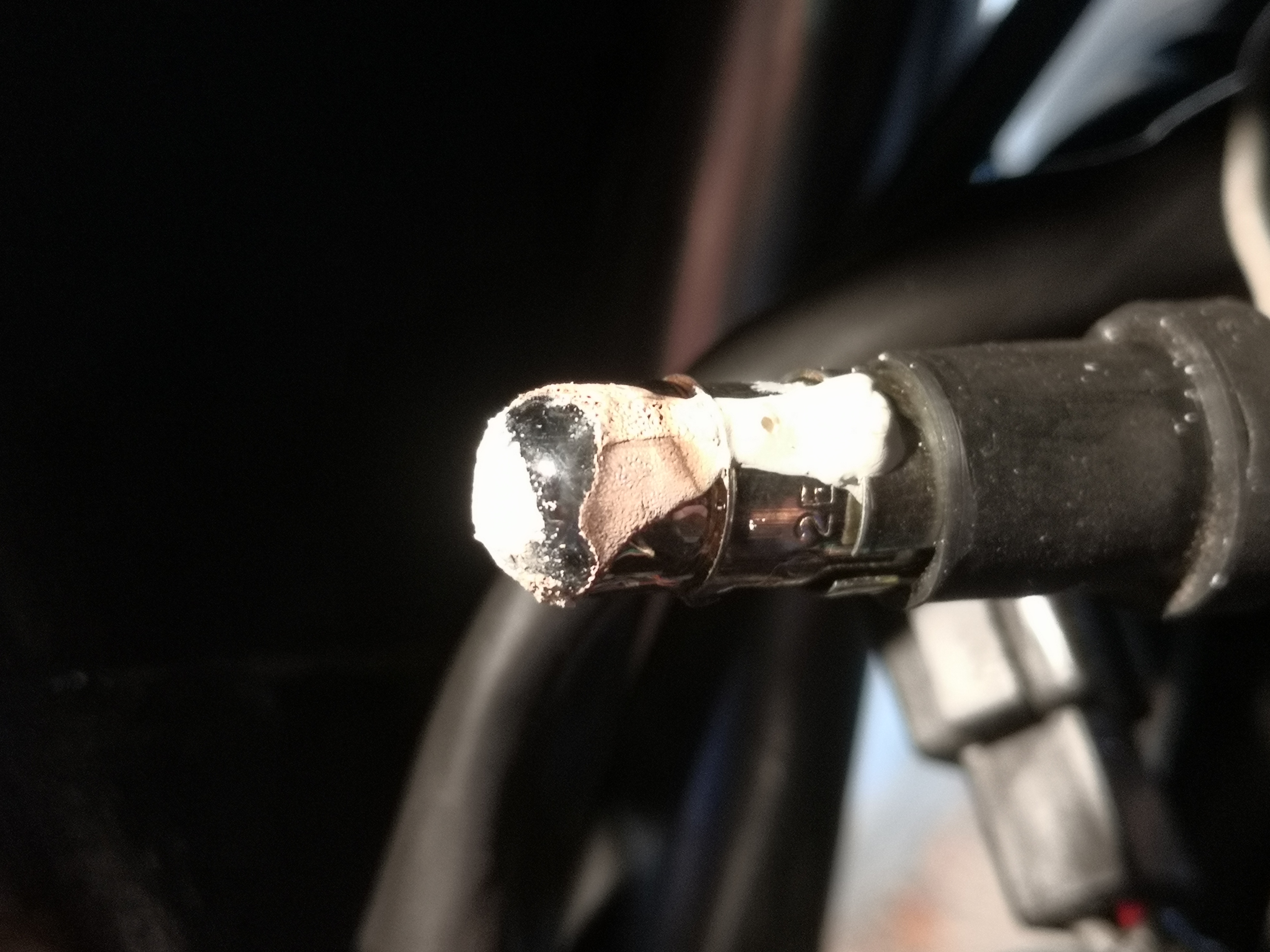

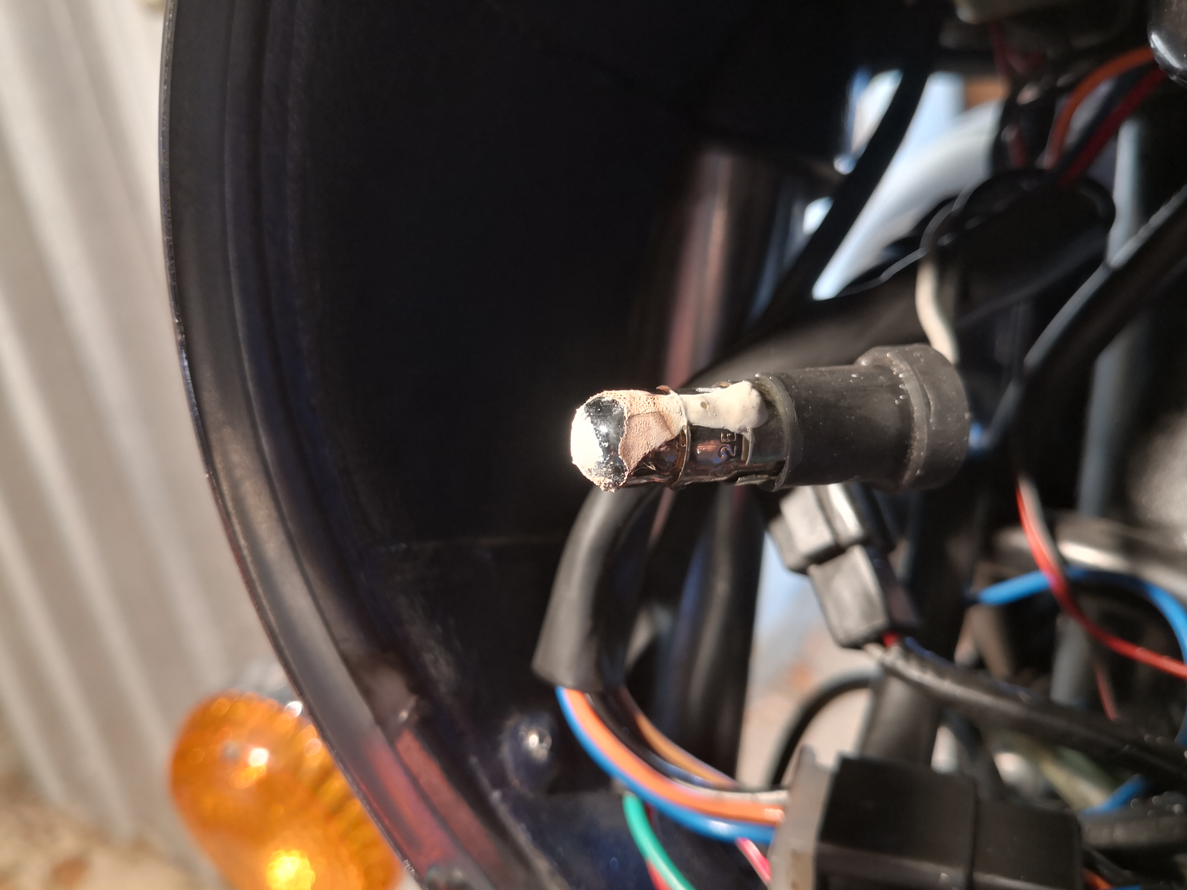

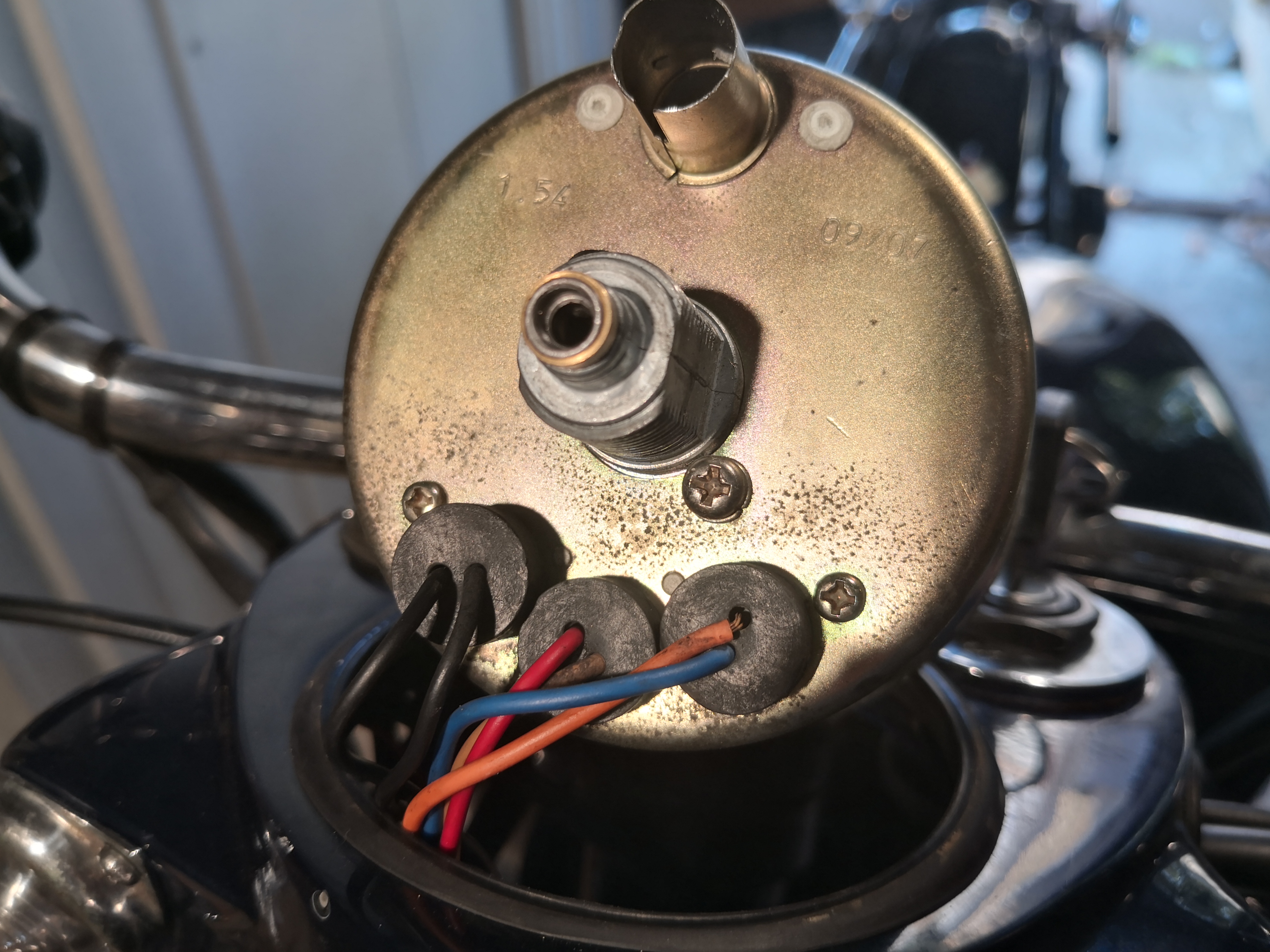

I had at another nose around the bike again today when the heat eased off abit, checking out all the bulbs in the speedo as there is no sign of life, had the speedo out to check all the four small bulbs - speedo Illumination / Indicator / Neutral / High beam . The speedo Illumination light was black almost and had melted slightly the white plastic inside you could just make it out when you looked in but was visible on the bulb (attached a pic). The other three appeared to be fine but I can't conjure up any light not even a neutral light now.
