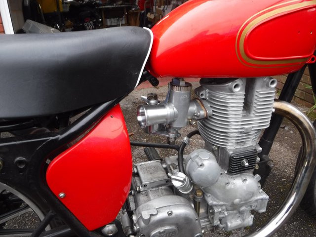

As for cylinder head work, if you're to be trusted with a die grinder and flap wheels (read careful rather than gung-ho!) a bit of patience will give you good D-I-Y results.
Big hole already (standard inlet against Amal 1½" GP carb spacer).
Bigger hole...
Getting silly, now (Dell'Orto PHM38, ex-BMW R90S).
Work in progress, totally deranged.

Interesting that the port work is so straight forward - I use die grinders etc at work so no issues there, definitely something I could tackle myself - and Adrian that looks a beast with that ex BMW carbytooter on it!
