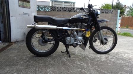

I'm converting my Electra 500 into a green laning bike. It's very much a work in progress. I'm not happy with the footrests they feel weak and flexible. Has anyone improved on them or fitted different? There doesn't appear to be much frame to work with and also they need to stick out a fair way to cover the rear brake.
Any suggestions much appreciated.

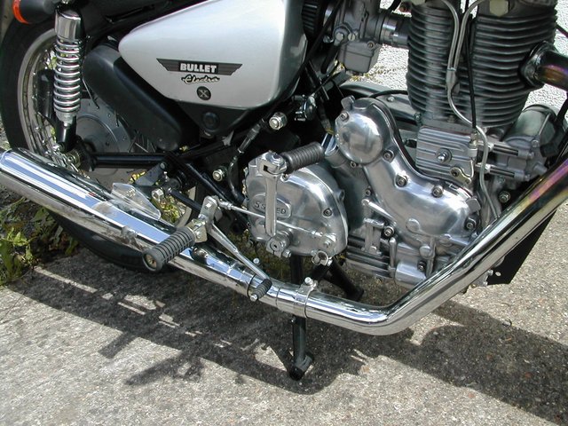

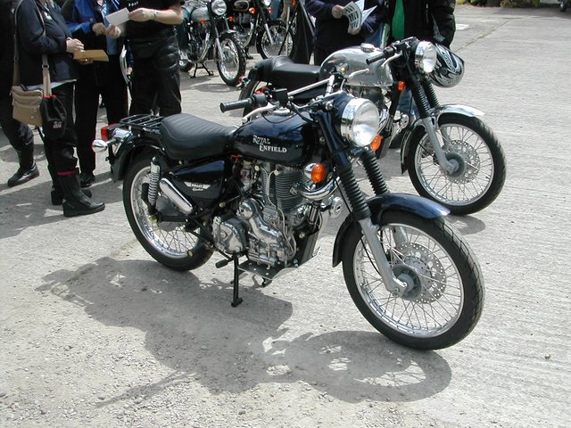

When Watsonian-Squire were the UK importers, their final custom version of the Electra-X was their take on the old Woodsman model, and this had rear-set footrests and controls, which at the time I thought was a bit odd at the time for a trail bike, but maybe not. I had a test ride on one during one of their open days and it felt OK to ride.
I think out hosts still offer them for both left and right foot shift 5-speed gearboxes.
Here are a couple of pictures from the day back in 2008, an Electra Woodsman and someone's cafe racer with a right foot shift rear sets.
That's a very blue exhaust pipe in your picture, is your carb jetted a bit lean?
