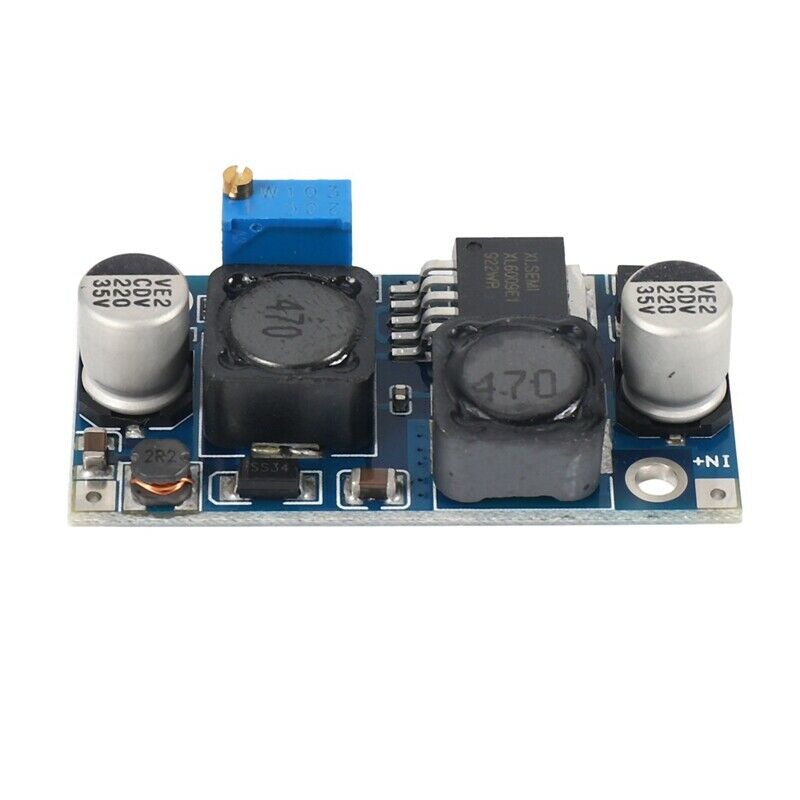

I had exactly the same symptom Rob. I always use the elec. starter and the engine would never fire until I release the button.
Single figure money bought a little regulator board from China, anything over about 3.5 volts at the input gives 12v out. Fed the ignition with this and problem solved.
I expect a new battery would have helped but this was a lot cheaper!

Go on eBay and search for "Boost Buck DC-DC adjustable step up down Converter XL6009"
Or look at item number 20200492062
I mounted one of these in a little box, set the output to 12v with the control and fed the ignition with it. There are many sellers of these, priced from about £3 - £8
