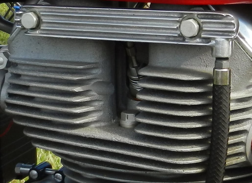

Hi Brothers, Hope you are doing good. Where can we get oil cooler for fury as attached. Thanks for your help.

Hi Selvam,
if that's a close-up from the picture I think it's taken from, the Fury in question is an American restoration, and the oil feed shown (it's not really a cooler, too small) is actually an American after-market accessory, NOT a genuine Redditch part you will find in any parts books. The factory rocker feed line to the Fury would have been the same as the UK 500cc big head Bullet from 1959-61.
https://www.hitchcocksmotorcycles.com/p ... pages/3779
Your best bet for any American-made exotic spares would be Enfield Racing in the USA. They don't list the part you want on their web site, but I would ask them anyway in case they're using an old one as a paperweight!
http://enfieldracing.com/page/28582-Enfield

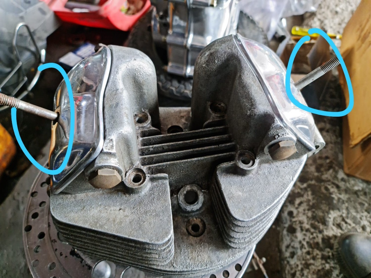

Thank Adrian for your help. Here is my Fury Head.
Ill Check that manuals. Thanks again.
