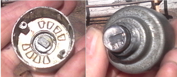

Hi guys. If you have a late-90’s 500 Bullet, perhaps you can help me. My ignition switch (the one set facing forwards in toolbox) is failing (the insides are cracked). I have noticed that our hosts don’t stock the same one again, but I have what appears to be a perfectly good one as spare except I don’t have its key. If anyone has the correct key (code C12 stamped on barrel outer), I’d appreciate a good scan of it so I can get a new one made and hence use my spare ign switch. Much obliged, ChrisD (in Cape Town)

Thanks for the info about taking the barrel apart - very useful IF I can get it out. But, as the images show, there are no circlips or other method of holding the barrel in the lock other than the pin plates themselves - so I cannot remove it. Hence my original question, if anyone has a C12 key, can they scan it and send to me? I am in Cape Town and so far away - too far to come and steal your bike!
Cheers, ChrisD

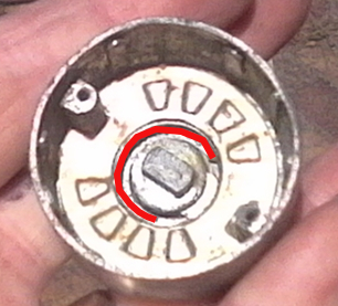

Stinkwheel, thanks for the input. However close inspection shows that the apparent circlip is no more than a couple of pieces of dirt. Under a hand lens, on both ignition switches, there are no circlips. So the only way to get the barrel out is with the correct key. Of course I could do what any Enfield rider would normally do and get a bigger hammer - but then I wouldn't have a spare switch. So, if there is anyone out there who has an OEM late 90's Bullet with the original switch labelled C12 on the outside cover, and it seems like they are very few, I'd appreciate a scan of the key so I can get a locksmith to craft a key. Are there any such users out there? Cheers, ChrisD

This is the retaining wafer that holds the barrel in the lock.
Push it in towards the centre to alow the barrel to come out.
Be ready to catch the internal wafers and springs as the barrel comes out.

Haggis, many thanks for your comment that the end wafer was the barrel lock. I had thought that but it didn’t move with a little pressure. Once I knew it had to move, then a bit of welly solved the stickiness. You’re right, the wafer can take off with alacrity but it landed with a musical note so I could find it. Now, all back together (just one wafer filed down to suit, as the video shows) and all is well.
