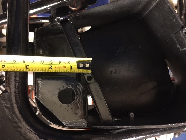

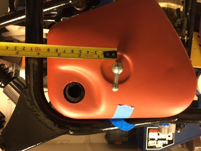

Hi all - wondering if a Crusader owner may be able to help me out here? I'm rebuilding my '62 Crusader from an abandoned project and haven't seen it all together. I'm struggling a bit to see how the left hand toolbox cover fixing works (i.e. the side that has the ignition key protruding through it).
The captive nut for the cover fixing "wingnut" bolt is about 2.5" in from the back edge of the toolbox - see image:
But the hole in the cover is more central - about 3.5" from the back edge - see image:
I've checked the online parts list schematic and the workshop manuals I have and both the toolbox body and cover look right (i.e. for a Crusader) but I just can't work out how it goes together!
Am I missing something really fundamental here, that is going to make me look really stupid?!
Any help greatly appreciated.
Thanks, Noel

I thought that originally, but I have a spare and that is the same. Also, looking at ones for sale on EBay, they are the same as well.
Perplexing!
#99572
It's a bit of a kluj, but you could pop-rivet a small steel plate onto that vertical piece to give you a mounting position for another captive nut in the right position to line up with the panel screw. Don't know if that would cause access problems for what lurks in there, though.

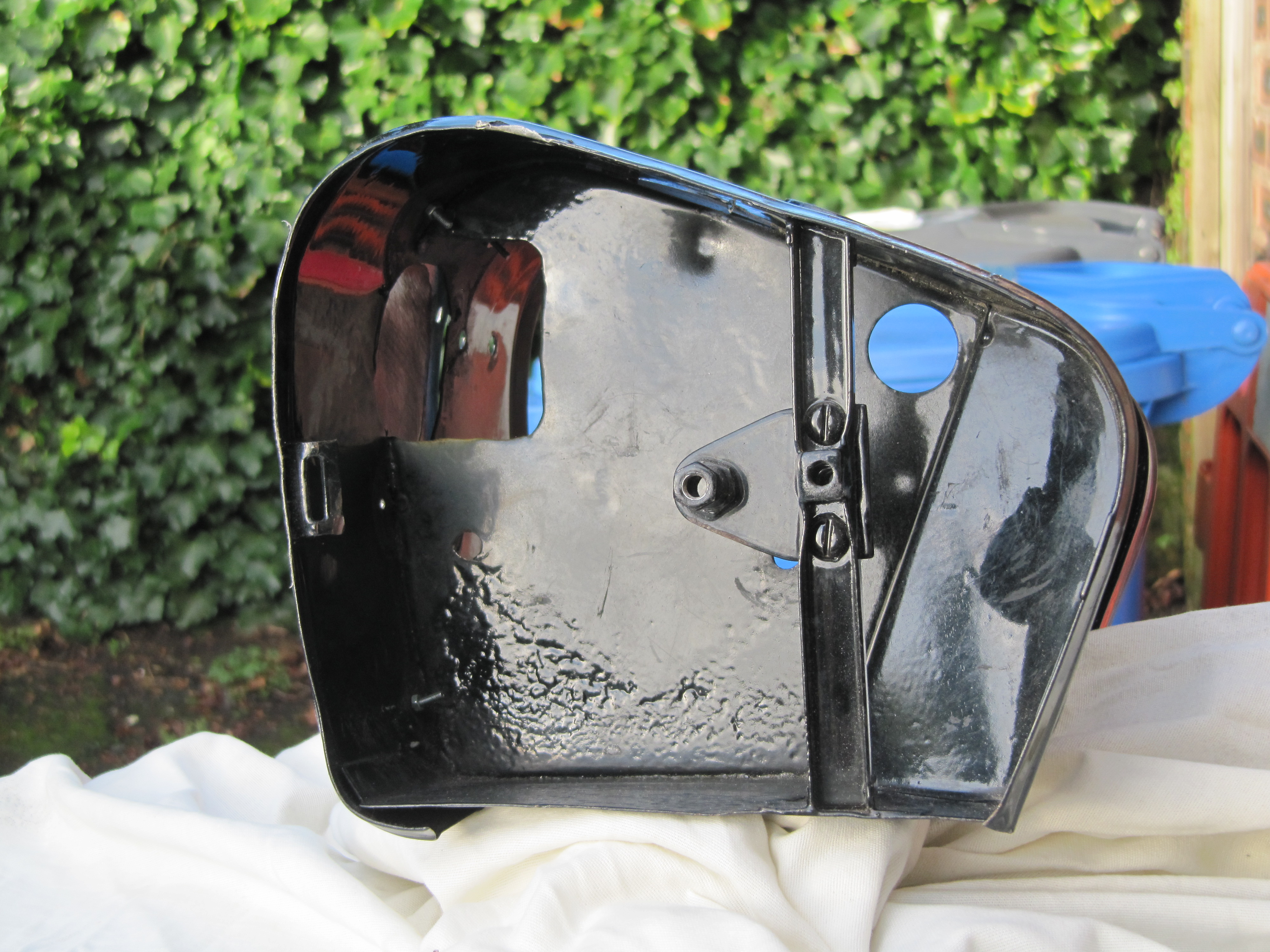

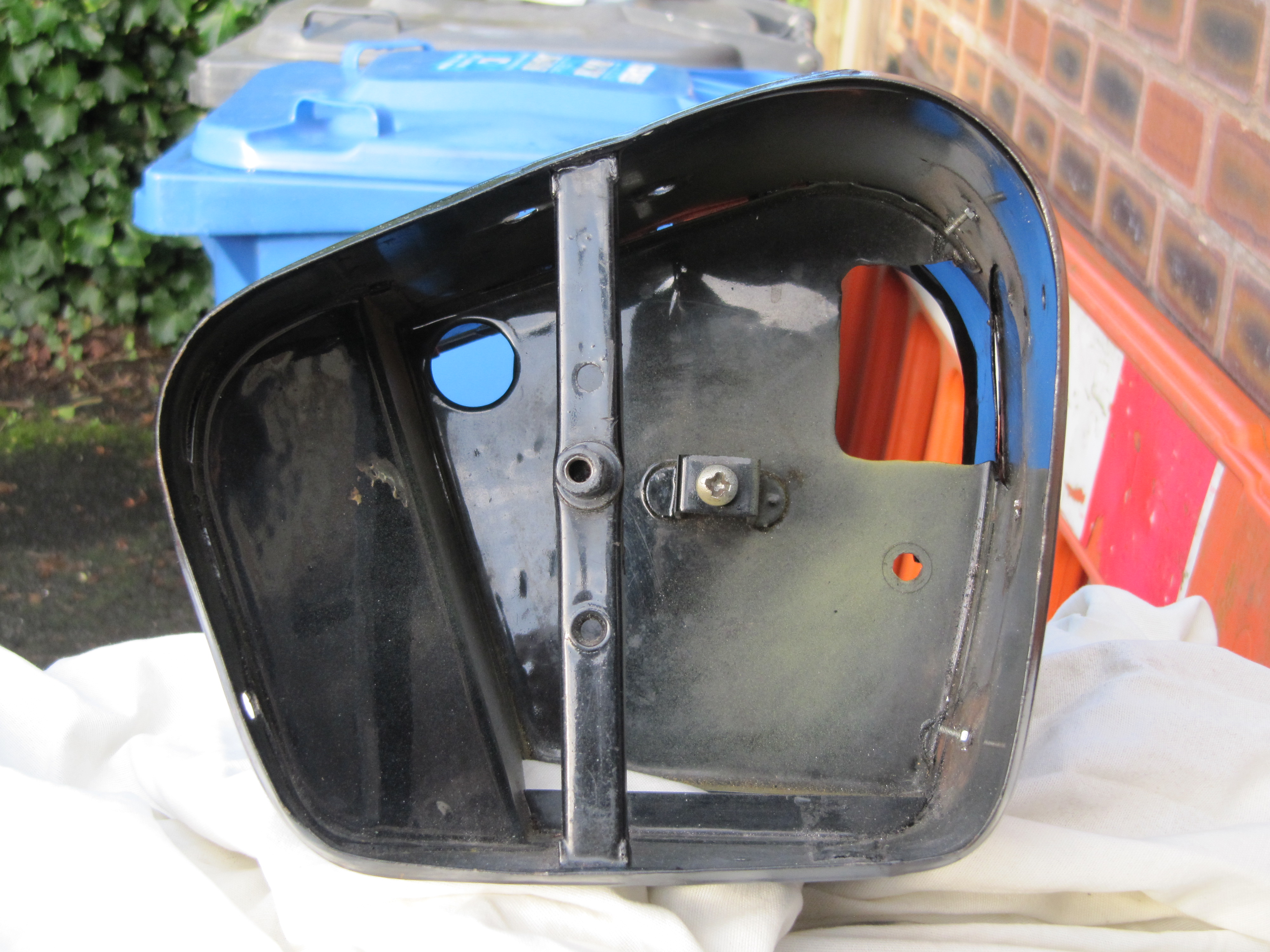

Whisper, ive just looked at my 1965 crusader sport box and it has the outer cover fixing lug, running near vertical from (use the hole on top as a mark line) if you want me send a pic let me know, ive got the box off the bike at the minute. Guru
By guru
#99630
Noel: I have attached two photos , one showing left hand side and the other showing right side, let me know if you receive them and are able to open them m8, if not i may need send another way for you. Guru

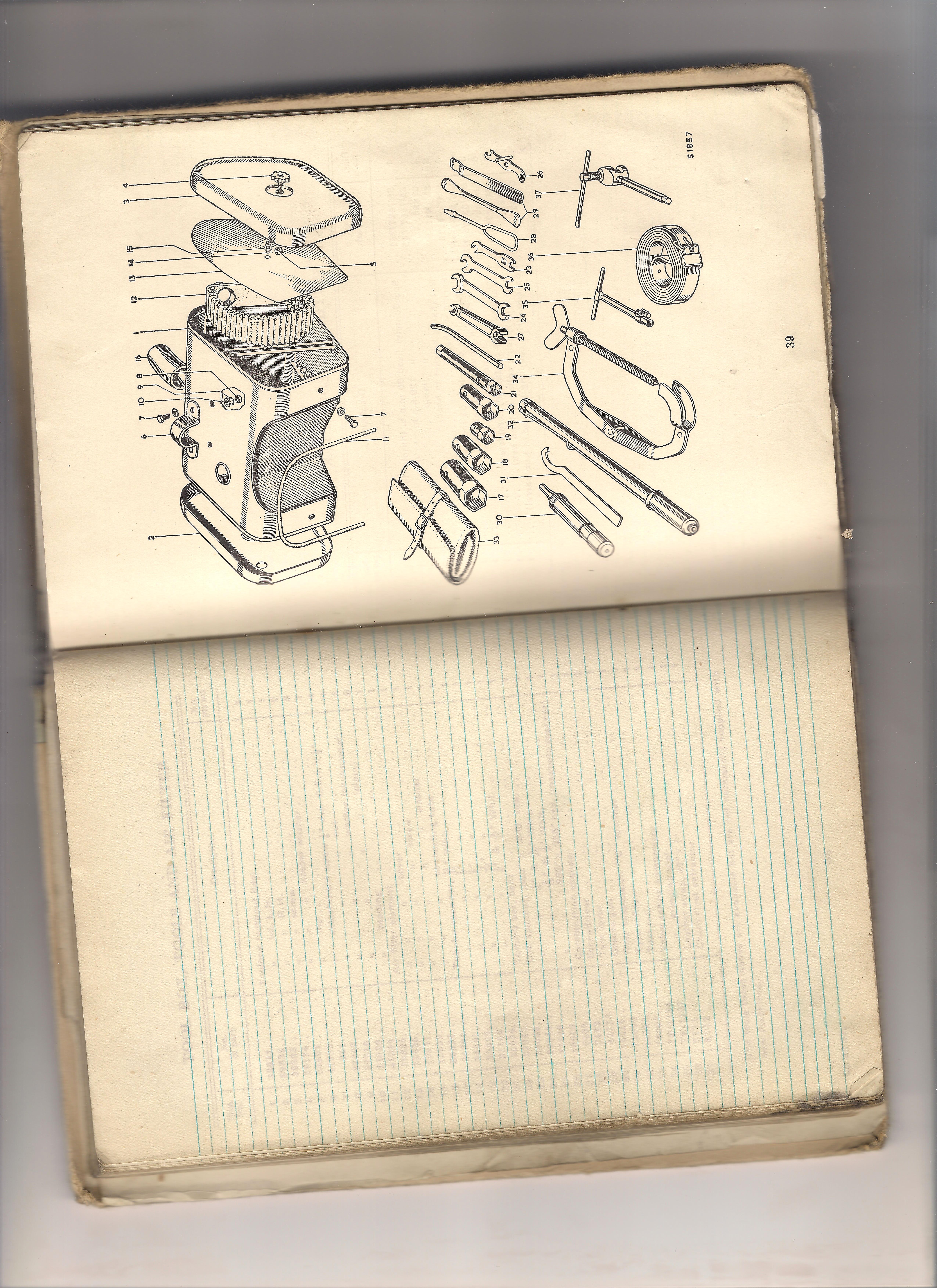

#99633
