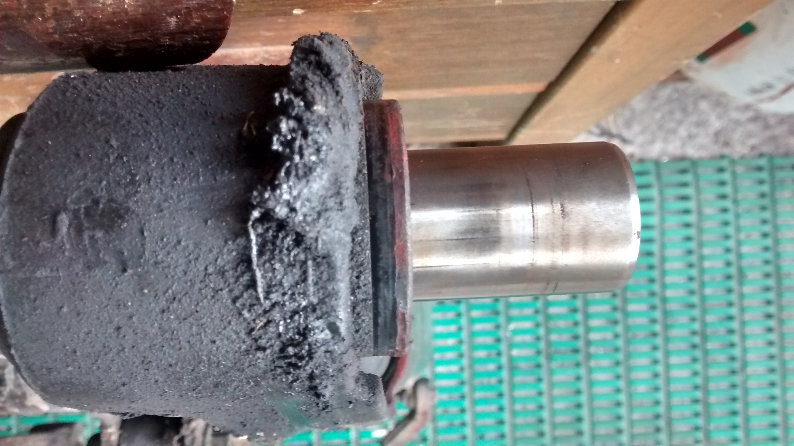

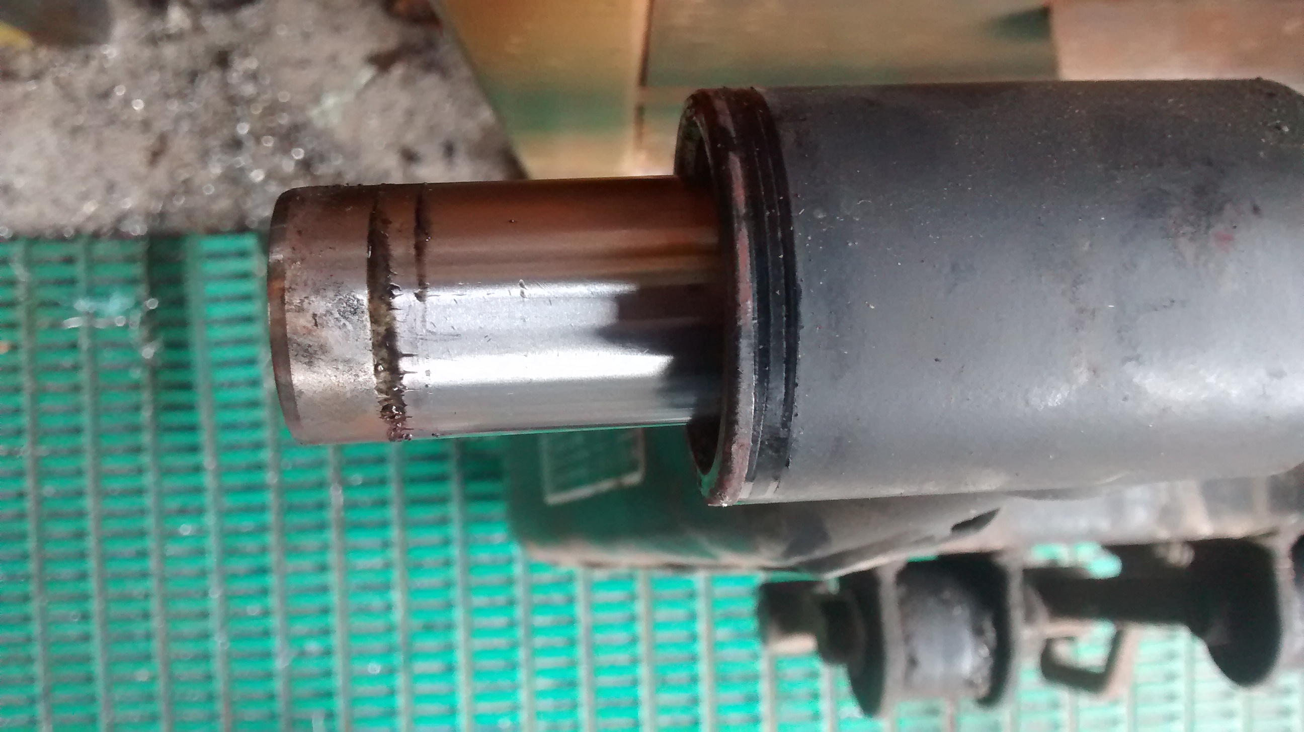

By Andy C
#99425
OK did the deed today, everything looks to have been assembled with no grease, just a hint of grease on one of the bearings.
Pulled everything apart and gave it all a liberal coating of grease before re assembly, including the bolt that goes through the frame.
The bearings are fairly large diameter roller bearings but come on RE assembling them dry.......
