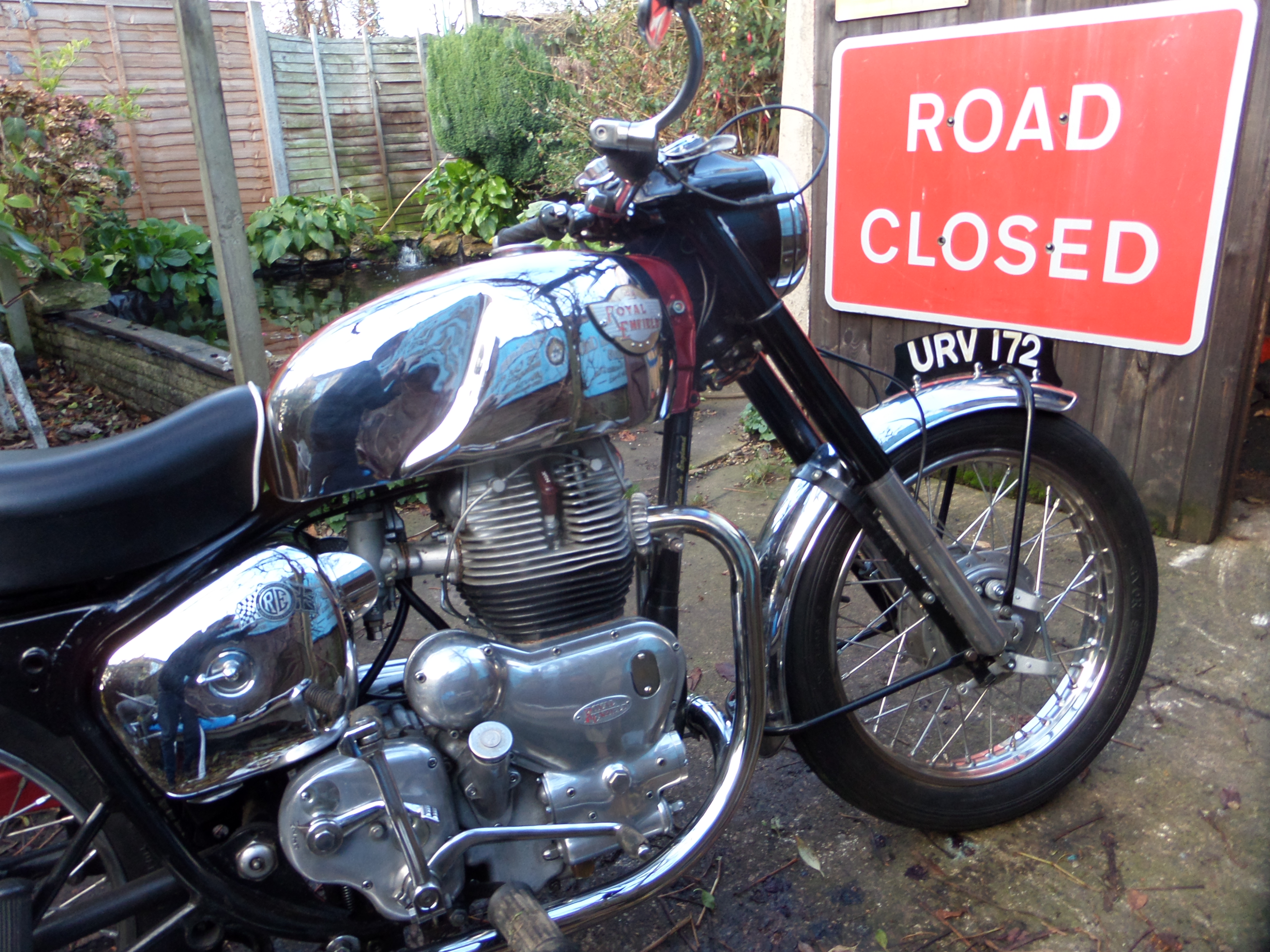

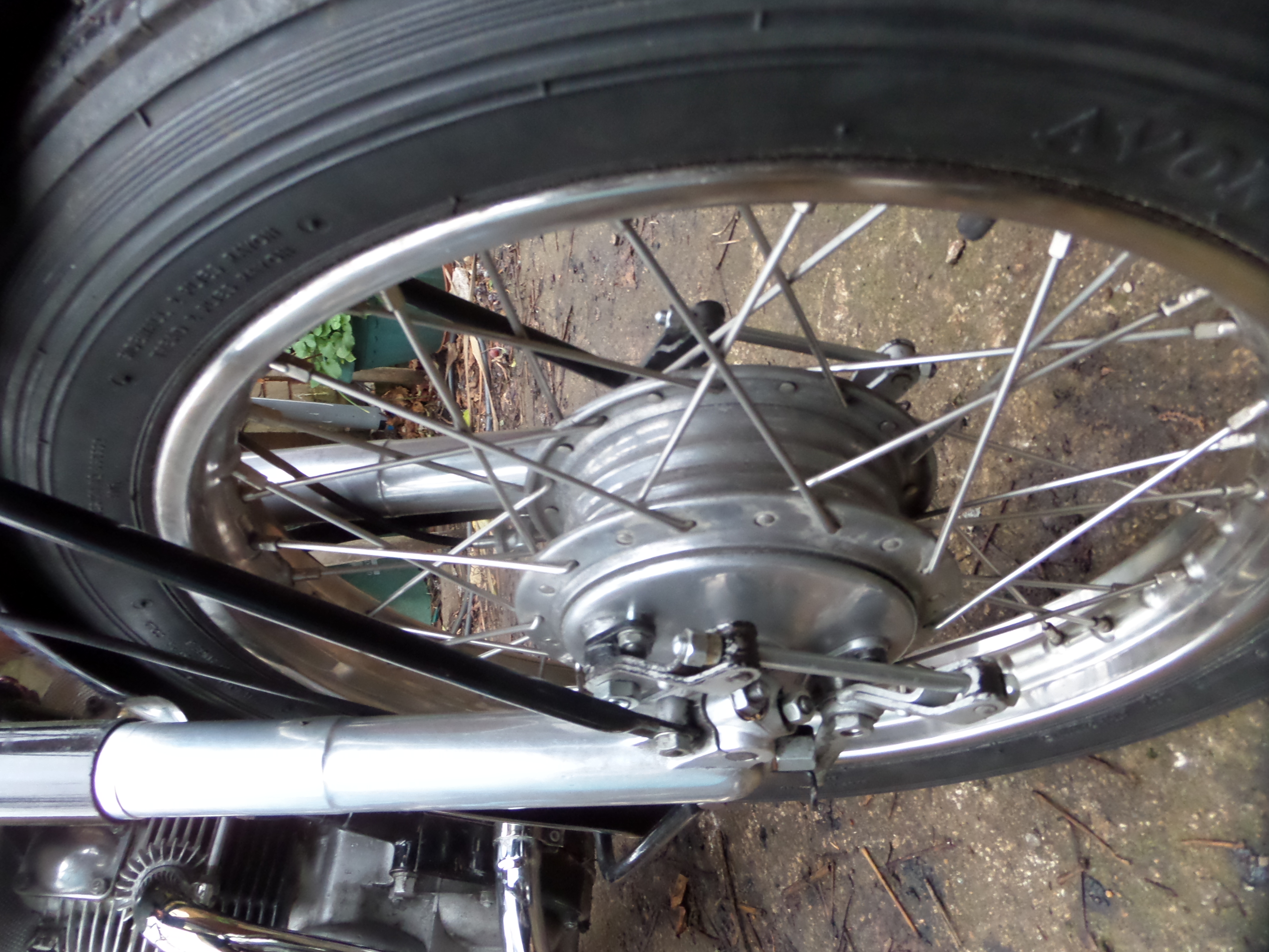

Some of you might be interested in a double sided 6" TLS front brake i recently made for my Constellation. All the parts used were parts from RE's 1960 parts bin. It took a while, lots of head scratching, ups & downs but glad I persevered with it & saw it to the end. The performance is very good - equal to that of my disc braked T140V & much better than the 7" TLS on my other Triumph. A 2 finger pull on the handlebar lever will bring it quickly to a nice controlled stop. A handful of brake lever brings the bike into "stoppie" territory.
