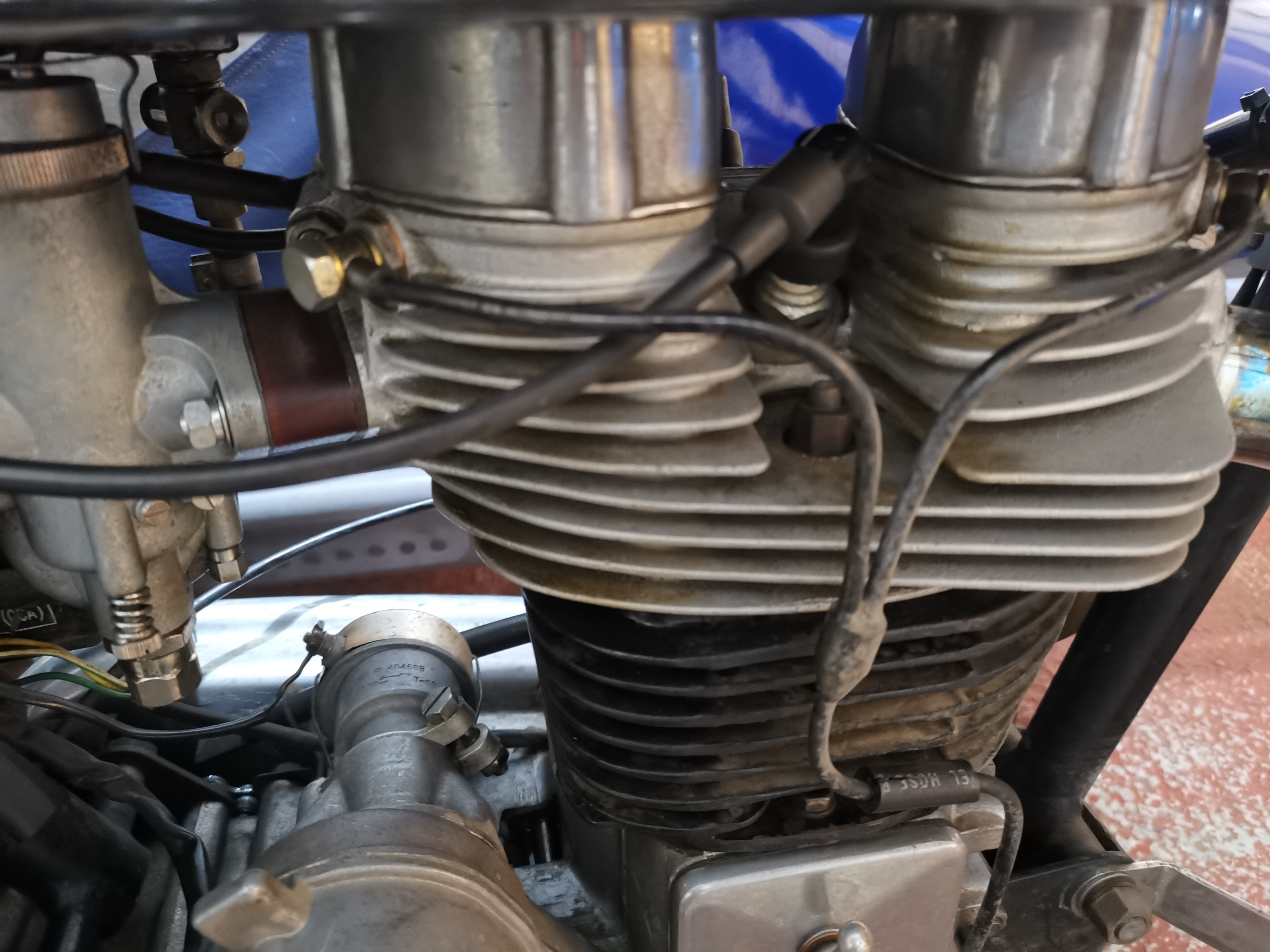

I've tried the valve timing trick, I have twin plugged her (makes a considerable amount of difference) also reverted back to british points/advance unit (which did improve things) fitted a british head and is on a small carb. dropped the primary gearing right down to give the engine an easier life. still pulls healthily with adequate cruising speed.

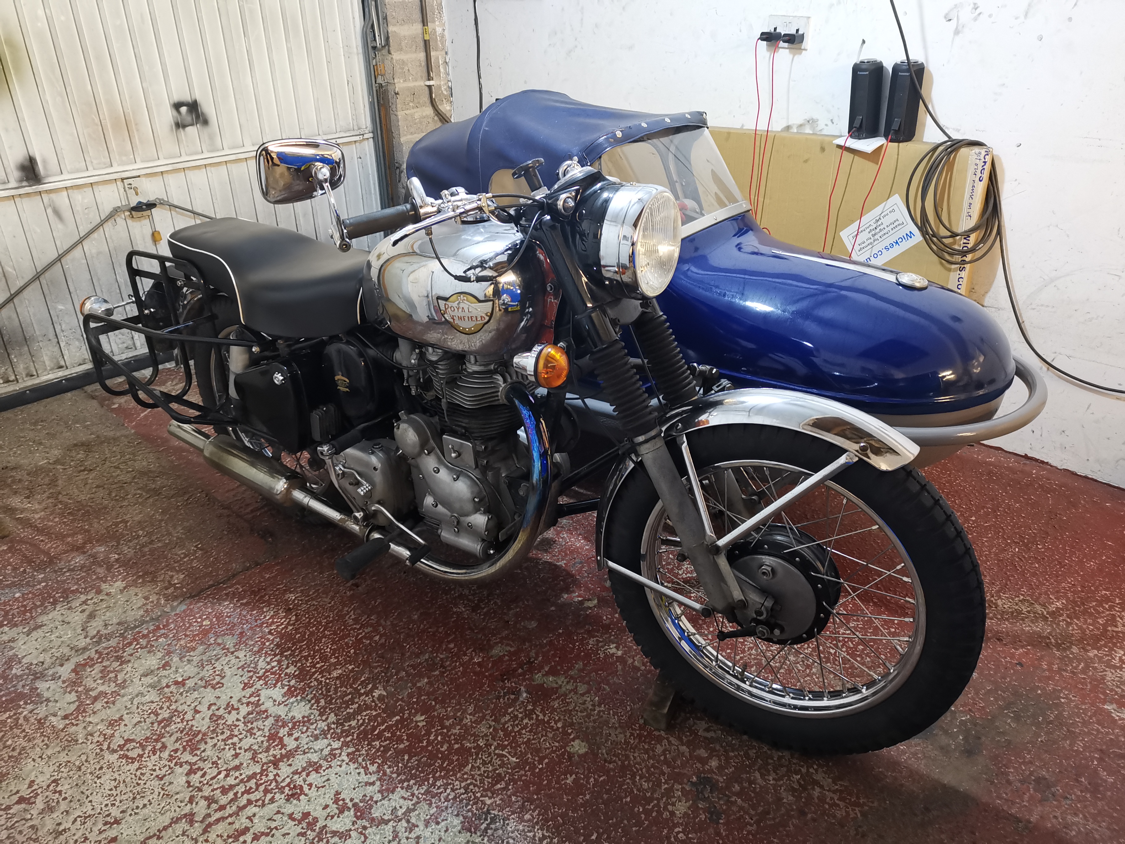

By Mike Barker
#99034
[attachment=1]IMG_20211123_183912.jpg[/attachment]
[attachment=0]IMG_20211124_090802.jpg[/attachment]
