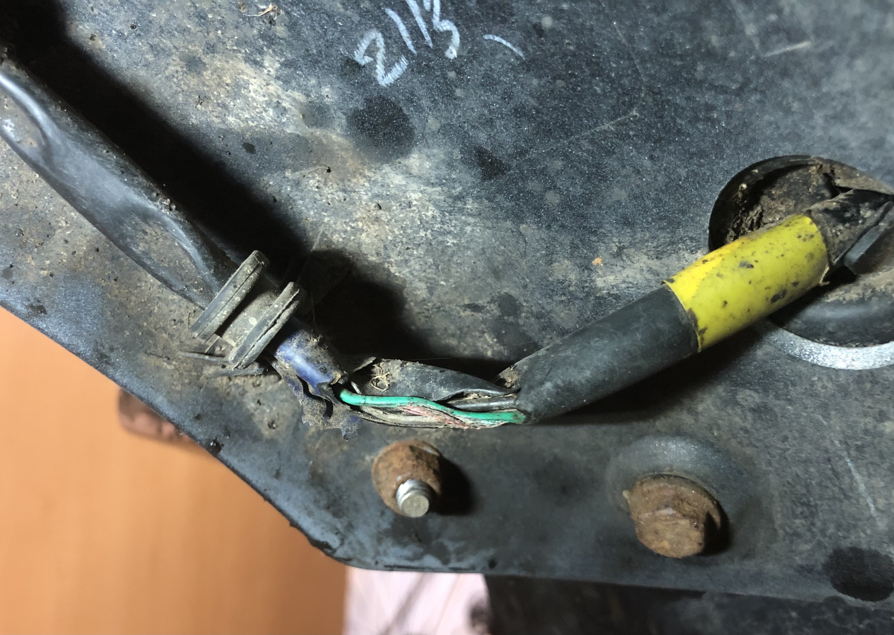

I interesting point.
I found some chaffed and exposed
wires on mine under the rear mudguard just before they enter then rear light cluster.
