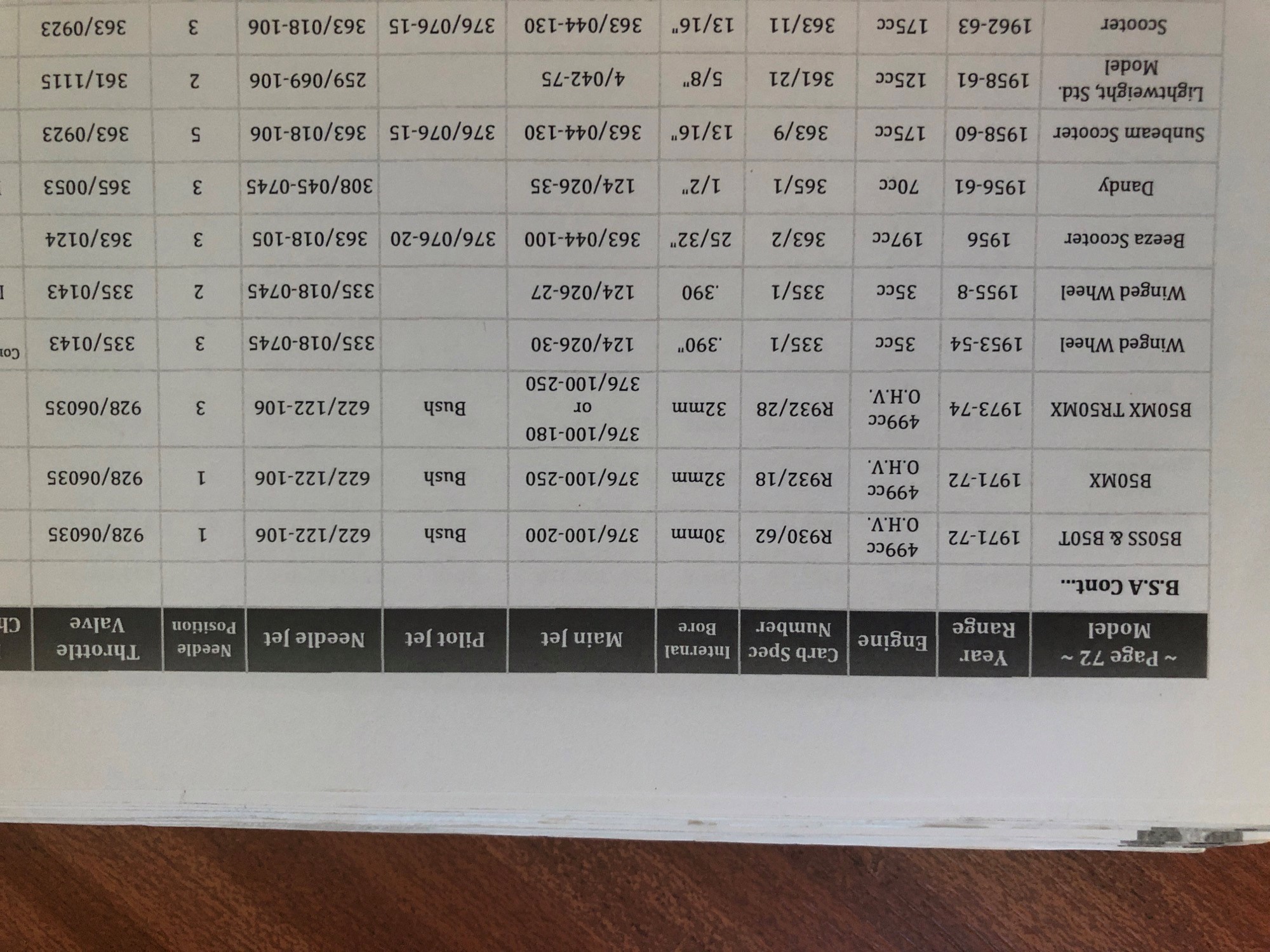

Hello (newbie here)
Can anyone tell me what jets I need for Amal 900/30 concentric onto a 2011 Electra efi instead of injection unit ( scrounged a good carb body ) ...I thought I would like to compare the difference ....Thanks for reading

As I am the proud owner of an Amal reference manual here is the appropriate page,.

Thanks for that Allenfox I will give it a go . This is a 2011 500 Watsonian Trails conversion I have changed the big sprung seat to a unsprung Hitchcock's trials seat with high level exhaust .......( just making it my own....as you do.!! )
