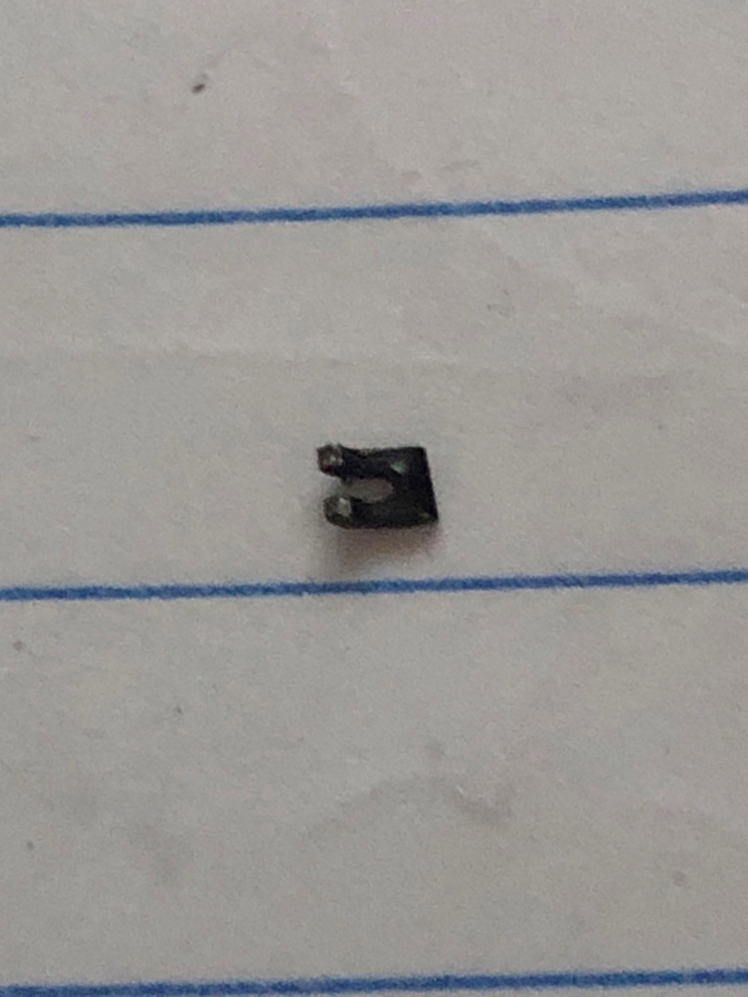

Just found this in the oil I drained, must have been in the sump and on the outside of the mesh, looks like either a bit of a seal or maybe a bearing cage fragment, either way is certainly engineered and not a good thing to find in your sump! Bad photo as very small (couple of mm) but lined paper for scale, any idea anyone?

The oil seal at the END of the crankshaft (the one that fits in the timing cover) is supposed to maintain the feed to the big end, leakage from the timing chest itself past the inner half of the main shaft shouldn't affect that at all. I assume it's fitted the right way round, flat side facing inwards?
Any leakage from the timing chest into the crankcase while the engine is running will be small compared to the amount that's being pumped out of the big-end.
I don't recognise the piece of debris you found in the oil, a piece of bearing cage is possible, in which case it's strip-down time. :(
