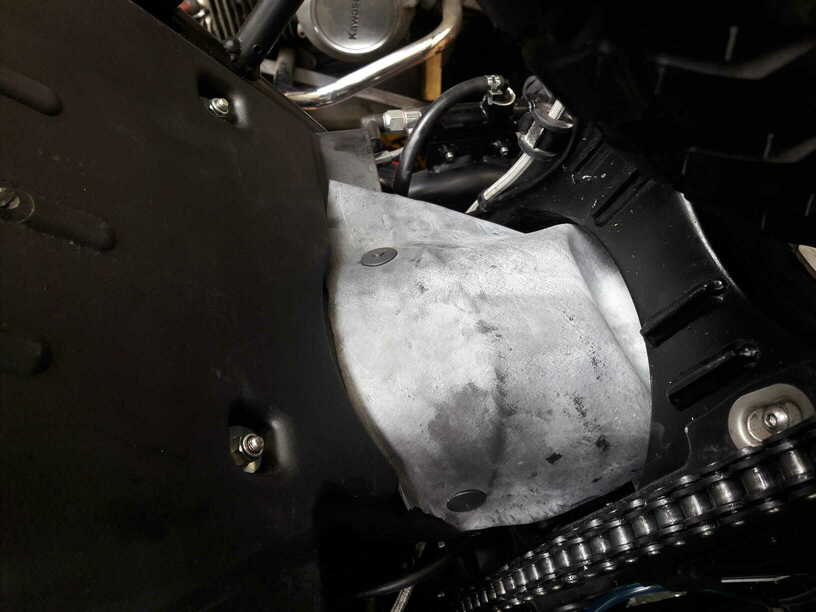

By 410Rider
#99166
Cheap and cheerful, AND works - Old inner tube fastened / glued to short shock cover. Extends down to bottom of shock,
which after 5000 miles is still like new.
Himmi Inner Tube Hugger Sustitute.jpg (61.12 KiB) Viewed 2704 times

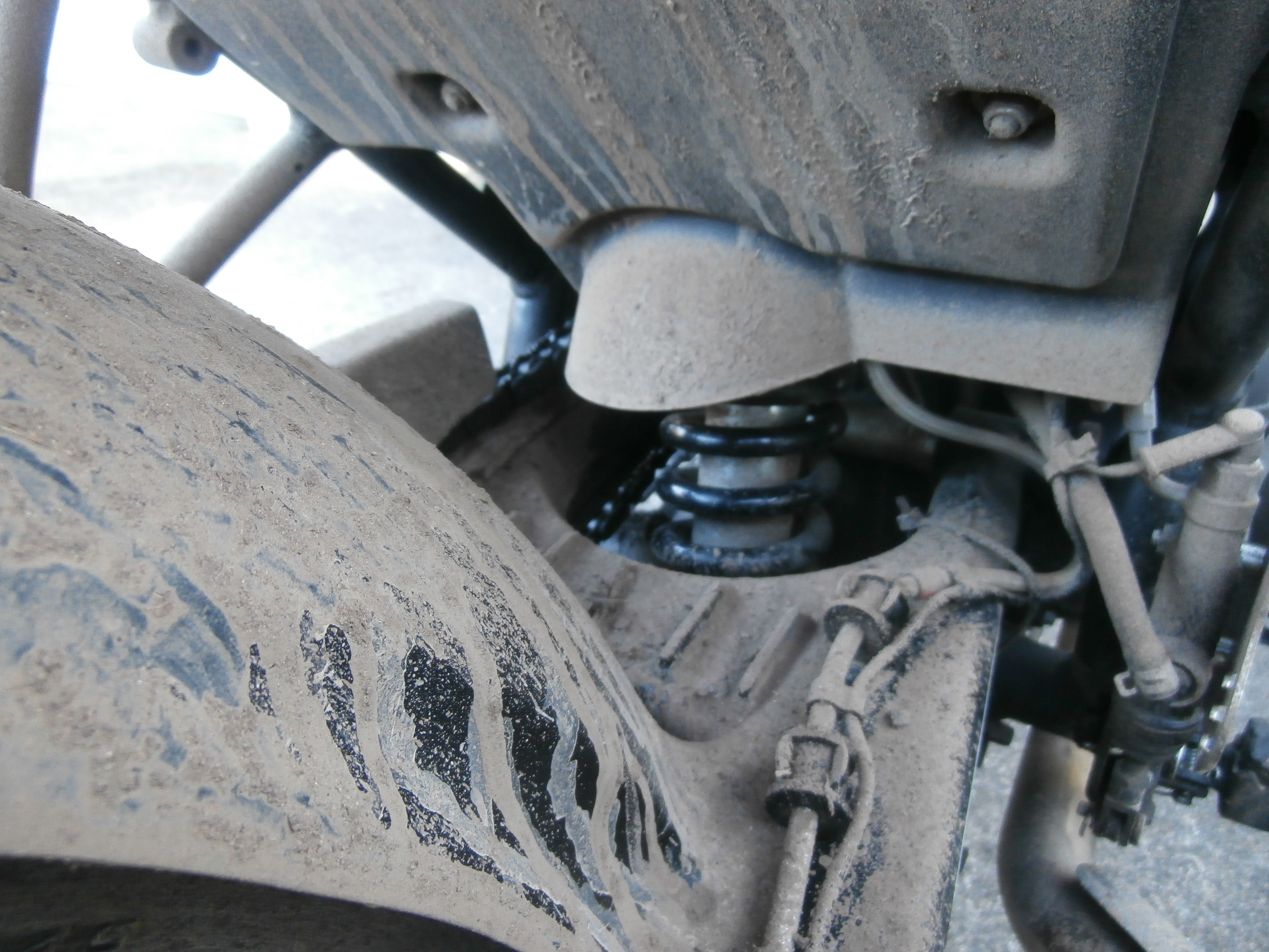

By Andy C
#99190
Pic of the rear of my Him. before I washed it.
Full hugger fitted - to be honest it would be better if it extender further around the rear wheel, but it certainly does a good job of keeping the shock cleaner and stops crud accumulating under the rear of the bike.
