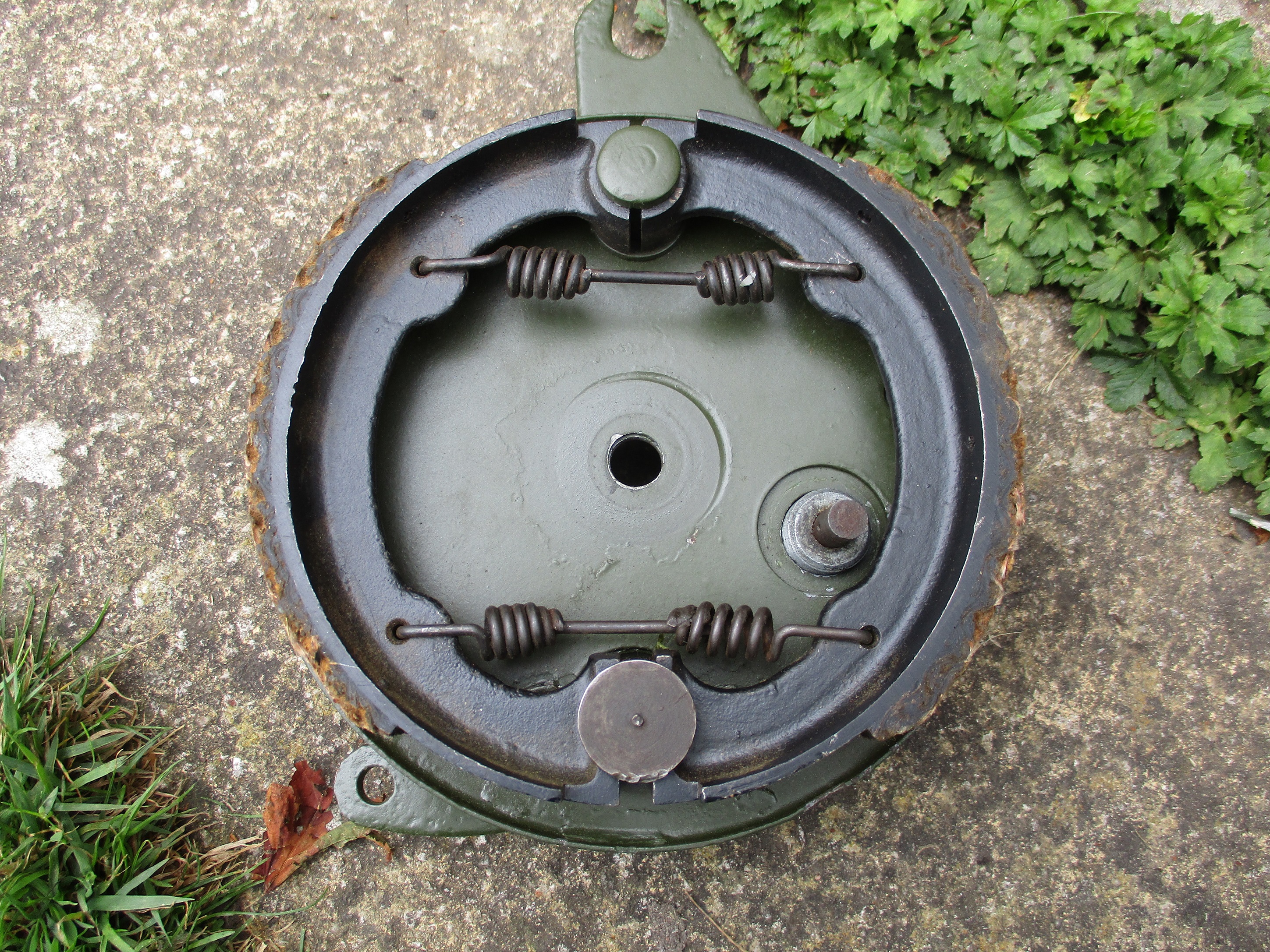

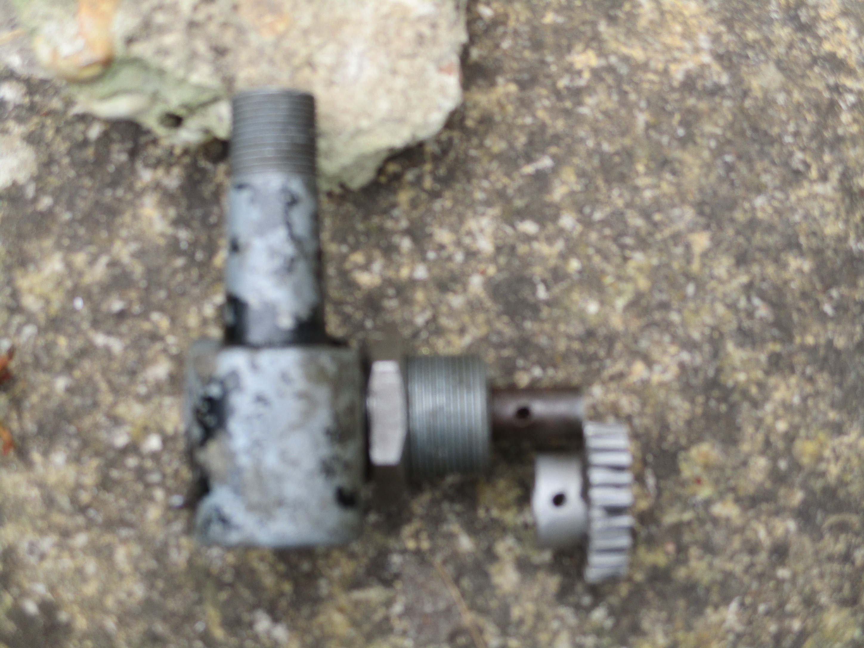

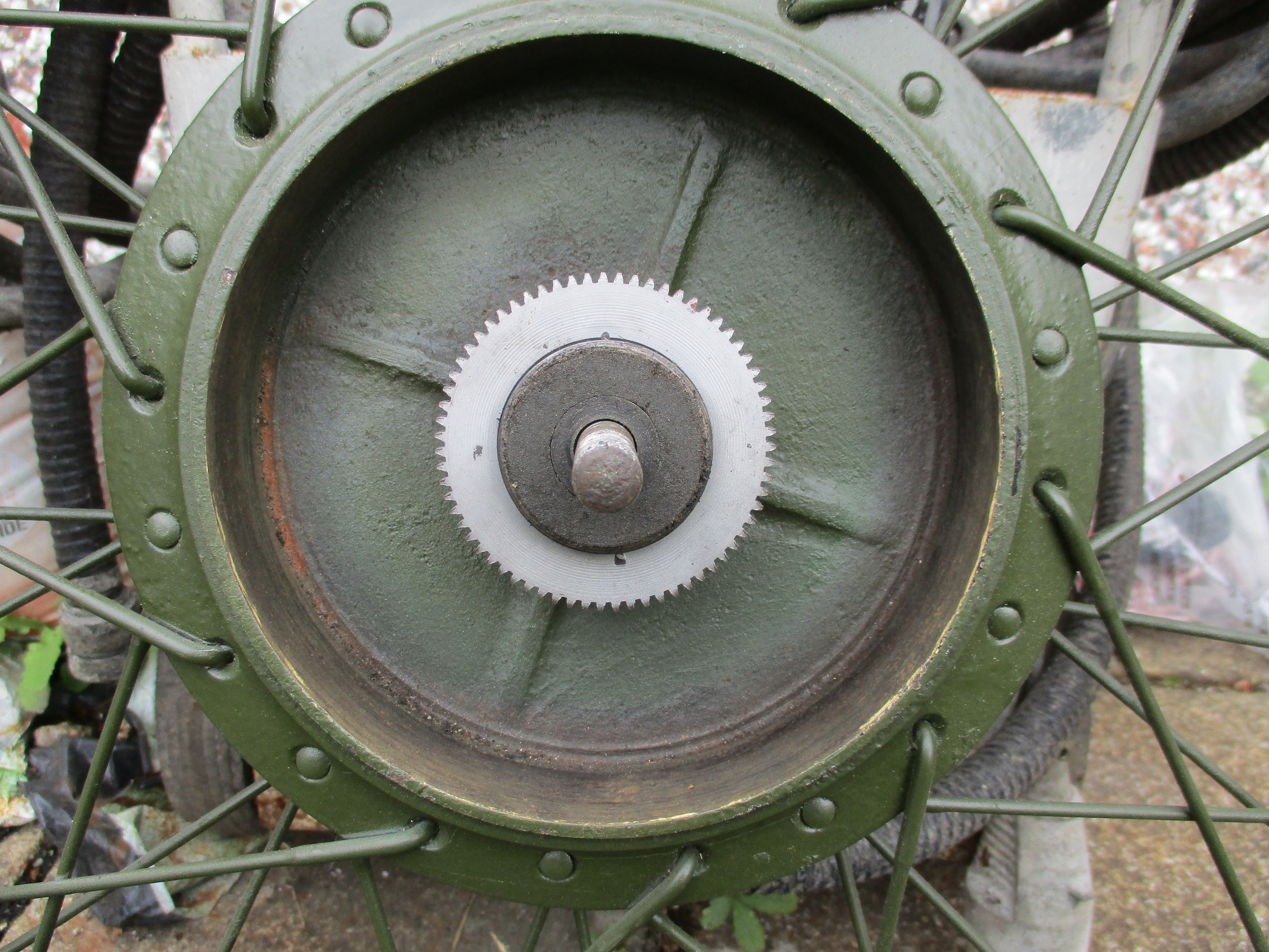

Having thought I had resolved my speedo gear issues on my CO( thanks to people on this forum) I discovered that my drive is wrong. The problem is I am not sure why it is wrong . I have been told that the rod that the cog fits to the drive comes in different lengths. Can any one advise ? I attach a few pictures to hopefully also explain what I am saying. Thanks Richard

Hi, from memory the housing is threaded into the backplate to the required depth then held in place by the locknut, that is how its adjusted. Vince

The pin is a rollpin,easily obtained (google) and cut to length,have you removed the nut before inserting the drive?that should give another 1/4" that the gear should enter the backplate and may then engage .
