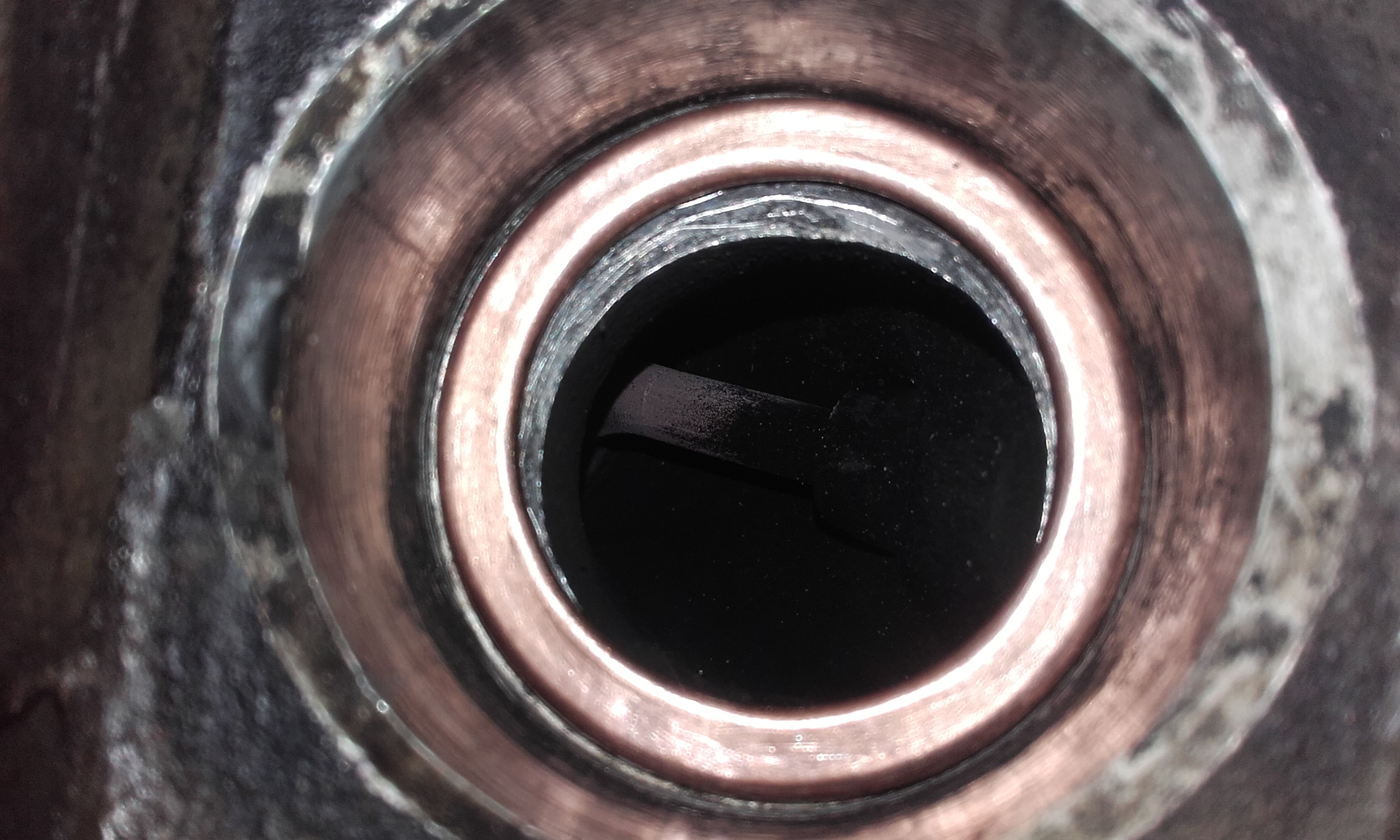

looking at the exhaust port, there is a crescent shape which i am looking to grind away to match the exhaust pipe . Would doing this spoil the port shape and exhaust gas flow?

I haven't seen an Electra-X exhaust port that WASN'T a badly finished mess. My guess has always been that with the narrow bore of the inner exhaust pipe (part of the factory lean-burn set up) there wasn't much point spending worker's time (and therefore company money) having a nicely finished exhaust port. Once you fit one of our hosts' full bore unobstructed exhaust pipes there is more point to it.

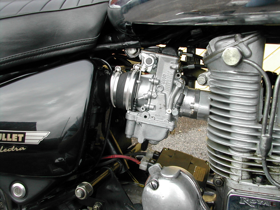

As far aftermarket carbs are concerned, you're spoilt for choice, any properly jetted 4 stroke Amal, Dell'Orto or Mikuni of the required size will do the job, even one of the el-cheapo Chinese clones of the Kehin PWK if it's set up right, and you're not limited to 34mm.
1. That inlet is also very easily ported to 36 or even 38mm,
2. Larger carbs can actually work very well on street bikes. My stuff is on Dell'Orto PHF36s, at the moment, but my old Electra-X also ran very nicely with a big Mikuni TM36-31 pumper carb - once I'd managed to squeeze it in under the tank.
The current Electra-X based project has a number of options in the 38mm carb department...
and with a bit of work... :shock:

Just noticed mine is the same as yours, well on the wonk!!
I see you have a copper ring as gasket/seal, I have always used the flat fibre washer but do have some copper rings, which is best?
#97860
Looking at the photo of the exhaust port, the step looks quite badly aligned, but at least it is the “right” way, I.e. it doesn’t form a narrowing downstream and might even be beneficial at low gas flow. What does the other side look like? Is there a step going the “wrong” way? If so, I would want that blending in.
#97861
Most of them look like this. The sooty black crescent-shape is the area that should have been opened out, so it clearly does not even match the opening offered by the more restrictive original exhaust pipe.
#97869
That’s more like it! Why couldn’t the factory have done it like that in the first place?
When I first gas flowed my 350 I concentrated on the inlet side and didn’t do much to tidy up the exhaust port. But the next time I had the head off I did some proper gas flowing. Opening it up and smoothing it made a lot more difference than I expected.
#97870
Well, they COULD have, but like I said above, the small bore inner exhaust pipe of the Electra-X and other lean-burn models meant that there wasn't really much point, just leave the exhaust ports rough and save a few rupees labour cost on every bike.
