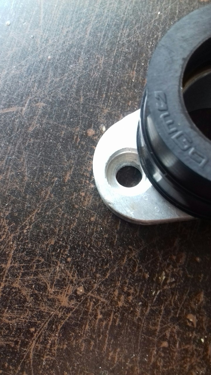

I want to mount a manifold and because of the thickness of the connecting rubber there's no space for the nut, so i am searching for 2 hex-bolts with tje corresponding thread..
The nuts are non-metric.
Does anyone know which of the English-treads is used for the inlet manifold?

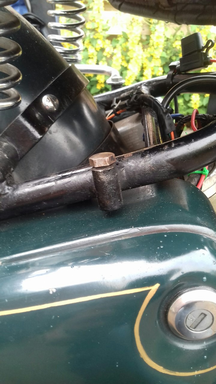

Another thread pattern used by RE in unexpected places was 26 tpi, British Standard Cycle thread.
A place you can check on an Indian iron Bullet is the threads in the vertical frame studs holding the rear brackets of the seat. Try the existing nuts on there to confirm if that's what they are.

You will REALLY struggle to find socket head cap screws with a cycle thread. I have two suggestions. One is to by some other 5/16" bolts with a different thread and a long plain section on them. You can cut off the threaded part and buy a cycle thread die to make your own fasteners.
The other is to fit M8 thread inserts to the head and use M8 fasteners.

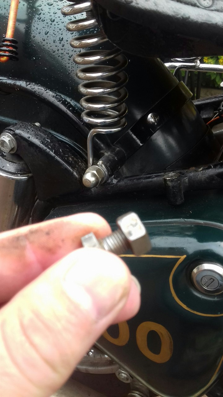

jawa-enfield wrote:Anmd TPI, is BSC and CEI?
i will look..
Yes, the translation says the thingies for an allen key are hex bolts and a hex key is the same as an allan key but that doesn't work out.

5/16" is 7.94mm so too close to drill and over-tap an M8 without making a real mess of things. So then you'd be looking at M9, which is probably just as difficult if not more difficult to obtain. If I was going for a metric conversion, I'd use an M8 timesert type thread insert where you drill the hole oversize, tap it and screw a threaded insert into the hole to take it back down to the desired size.
