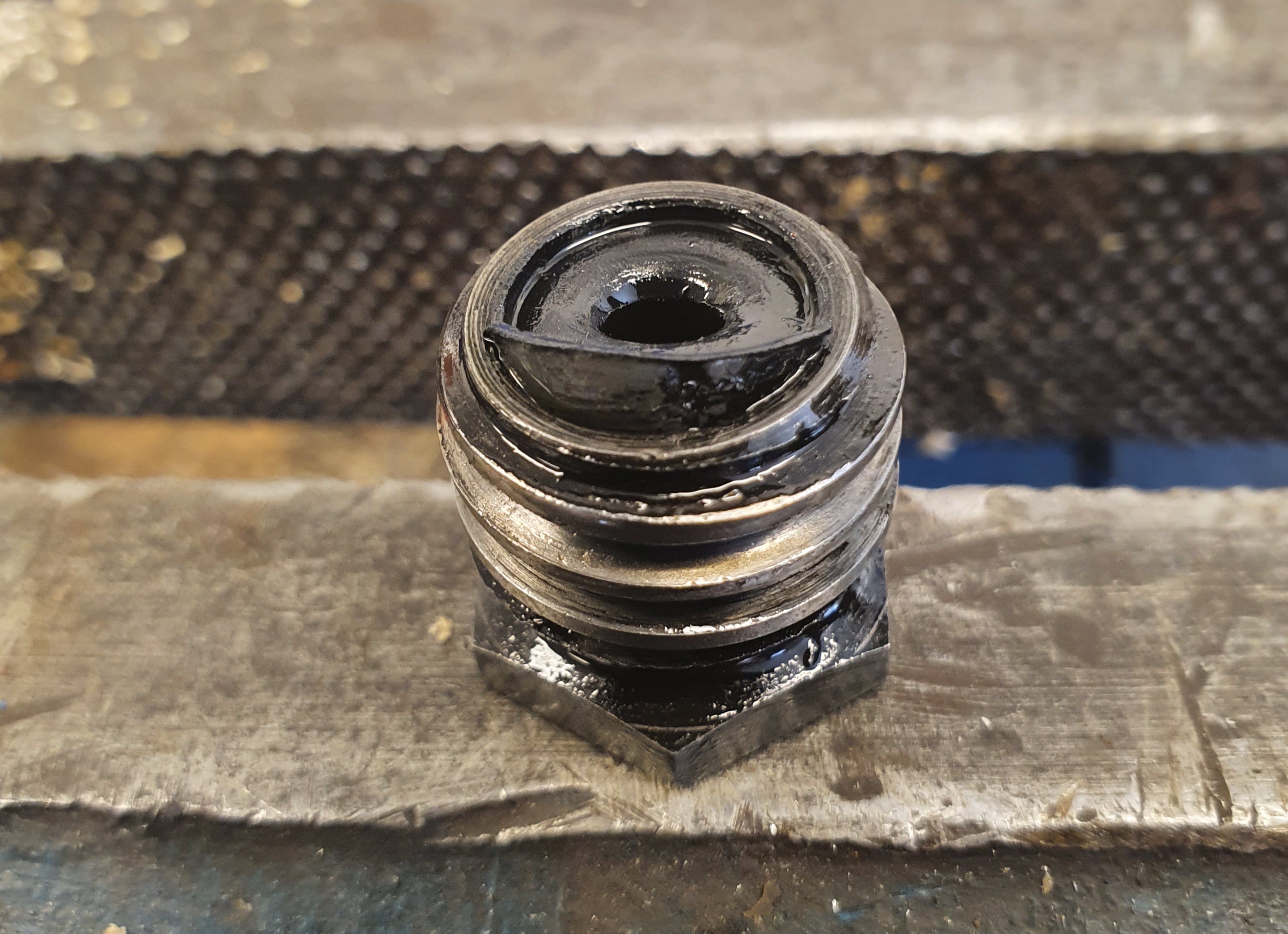

One thing that I spotted now after winter was that the oil leaking to air filter box came from the timing side throu the (new)PVT-hose filling the catch tank. That was why I suspected the drive nut for the oil pump.
Sadly I have no time today to continue with the bike but I can share a pict of the faulty drive nut.

You'd almost say that had been forced back out by pressure.
If it was me, I'd check that you can flow oil through the crank by removing the quill bolt, pushing a pump-type oil can aginst the new seal and pumping oil through the crank. It can take a bit of force with a floating bush crank but you chould be able to push oil through (an oil can is able to produce more pressure than your feed pump so if you can't, there's a problem). This would have the added benefit of delivering a bit of oil into the crankcase to prime the scavenge pump.

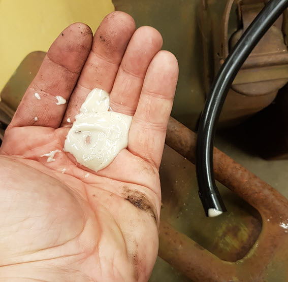

The first is from 2019 and I have removed the crank house vent hose and cleared it.
Wonder why this is not working :shock:

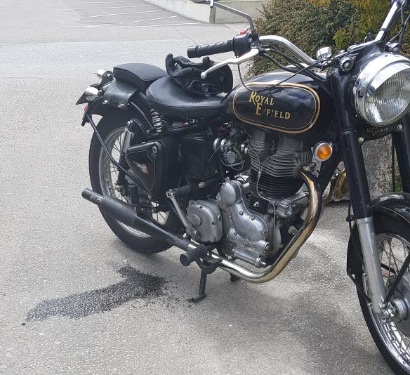

This pict is from 2020 after a 20km ride - WITH NEW HOSES!
This is what I got back to after lunch. :twisted: :twisted:

Yes, that's precisely what my Electra-X did. If that is after fitting new hoses, there's still the question of what's in the catch-can itself, did you clean that out too? A main breather which is blocked ANYWHERE will result in oil being pumped out the timing chest and ultimately into the air filer box on the factory system.
Like I said in post #96620 , THE WHOLE FACTORY-FITTED BREATHER SYSTEM NEEDS TO GO. Replace it with something simple which is not prone to clog up.
