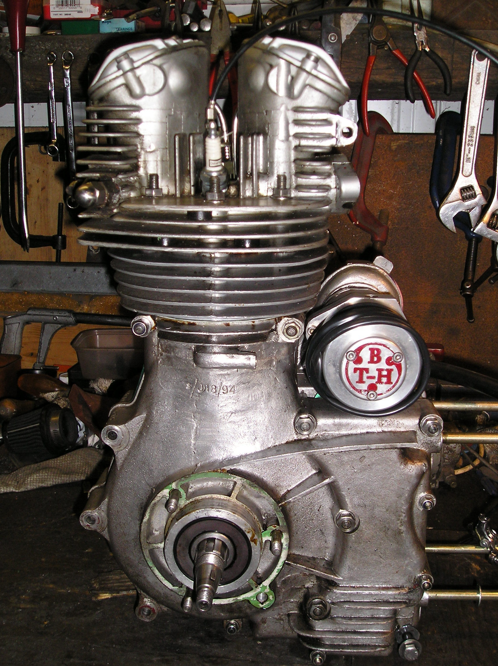

The OTHER option is to strip the engine and machine the right-hand crank case to take a full set of timing gears and a nice magneto, the rest of the electrics can do what they bl**dy well like, then! :D
