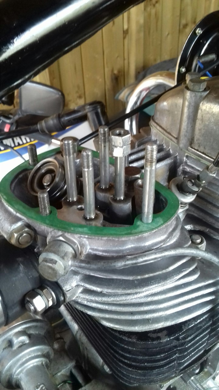

Because of a loose locknut this happened.
Diagone of damage; bend pushrod, so ordered a new set.

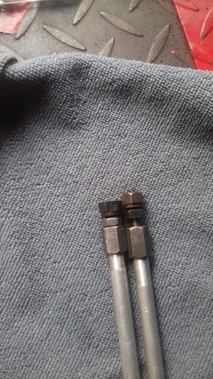

But..
1; the new ones are more bend then the old one? As if the thread for the adjusment possibility is not drilled in straight.
If you twist them, the adjustment part swings like a hula-dancer..
2- There is not enough thread for adjustment?
I do have the samrat-rockers..
Comparison with the old one..
How 'normal' is this?
I contacted the supplier and am sending them back..

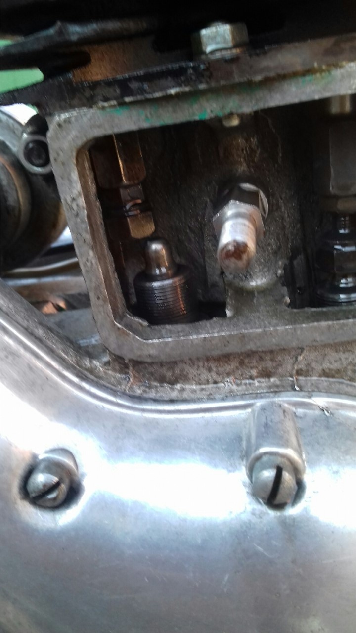

Whilst fiddling with the pushrods, i discovered that when the tappets are adjusted at TDC of compression stroke, and i turn the crankshaft a little further, the tappet clearance increases?
..so adjusted them again, turning the crankshaft looking for the point of most clearance..
It now comes to mind, that this is 'precalculated' and the zero p[lay at - exactly TDC is correct, so i should do it again?
#96200
Yes.
Remove the spark plug and check when the piston is at TDC. When correctly set, the push rods should rotate, but there should be no up and down movement.
Personally, I used the kick start with one hand to roughly find TDC and turned the push rods with the other hand and then just felt when it was the right position and adjust as necessary.
Of course if they are way out, then you cannot do this. You need to watch the rise and fall of the inlet push rod and you’ll roughly see when it is at the top of movement.
#96207
Okay, not sure i understand.. I do remember setting the tappets of my BSA m21, that was not at TDC but when the other valve just opened/closed (long time ago).
To be sure i understand;
1 The tappets should be rotating freely, yet no up/down movement at TDC-compression stroke.
2- Yes, it is correct that they get more play when the crankshaft rotates further, (i did not screw it up)but the factory has given the upper method for tappet setting as it is easiest done?

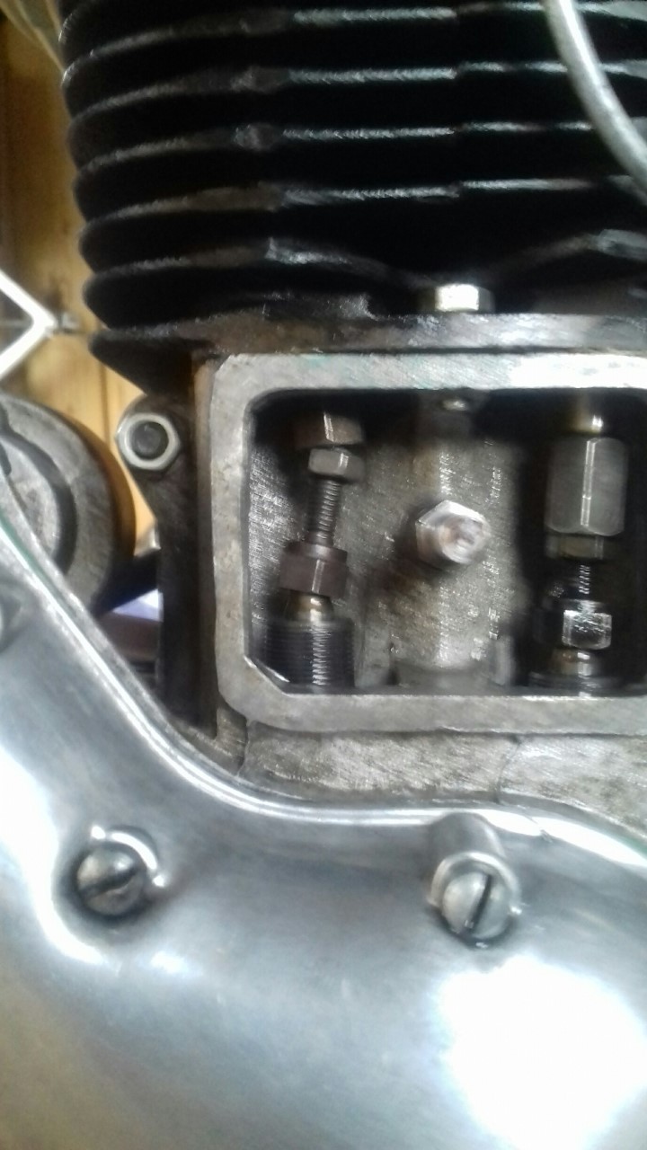

#96210
Hi, turn the engine until your are at maximum lift on the cam. Rotate the engine one revolution you are now at the bottom of the cam , adjust the tappet. Repeat on other cam. Vince
