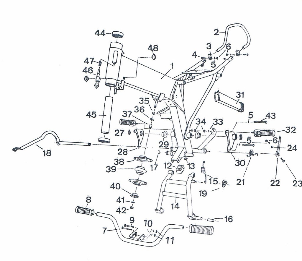

Maybe they should fit one of those big rubber frame mounts like they used on MZs.

I think not.
The MZ mounting is meant to isolate the engine vibration from the frame. Basically the engine can vibrate without transmitting this vibration to the cycle parts.
The Enfield head steady is meant to rigidly connect the engine to the frame so that the engine's vibrations can be damped by the mass of steel that it is connected to. The standard Enfield head steady is inadequate for this purpose, hence the benefits of making and fitting a stronger structure.

You can not use a MZ-like rubber mounting for a RE as the frame is not self-supporting and needs the engine as a stabilizing element. Have a look at a MZ frame - the upper tube is very massive.
If you have the engine removed and you will sit on the RE the bike the frame may bent.
It is a good idea to have a double head stay as the frame may twist due to torsion with only one stay mounted.
