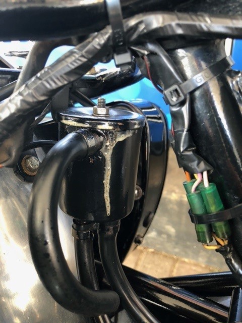

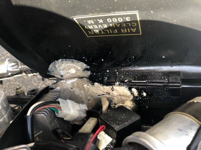

My 2008 350 has just done this and the 'snot' was suddenly everywhere! Also just after a good clean and polish :-(
Exactly as other have said and the whole system was just full of it, stripped and a good wash out with paraffin and fine, I think we need to check the catch can regularly, first time mine has done it in a year so a bit random but maybe it takes that long to fill up? My oil looks fine so guess the emulsification is like foam that builds up.
You do get a bit of oil in the air box as the 'air' has oil vapour in it so will build up a bit and needs the odd wipe out but a sudden increase seems to mean system needs a clean out, look at the photo of the inside of my air filter box!

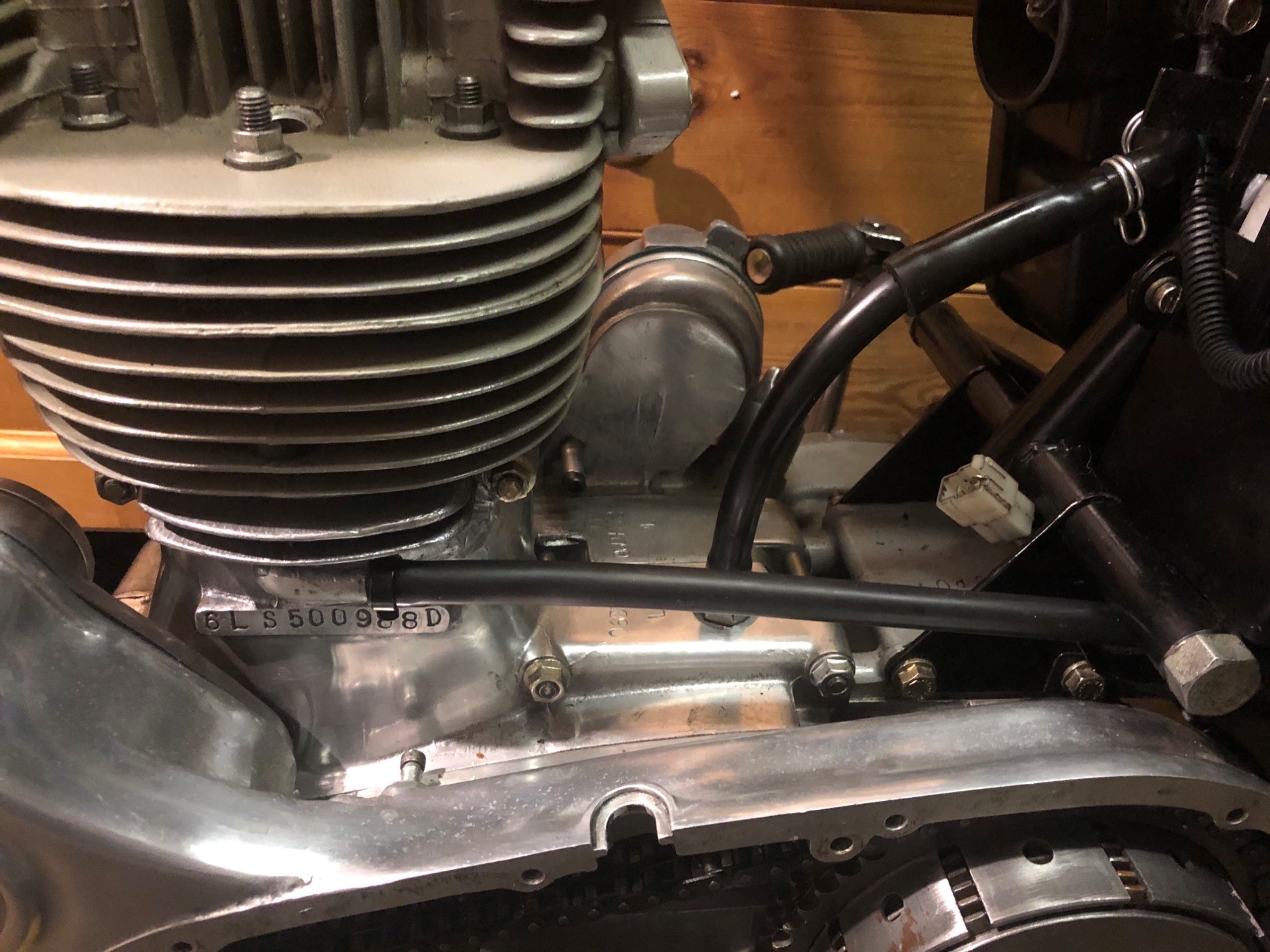

Hi Adrian, yes done this on my 500 AVL as part of the rebuild (and advised by you), crankcase port opened up and off to back of bike (not finished in photo) and oil tank staying at air filter for now as interested to see what difference in venting pressure with crankcase port opened up, if oil does go into air filler I will have to run alongside the other one . Not running yet but soon.
If you vent at chainguard dos it not risk an oily rear tyre, or am I overthinking it?
