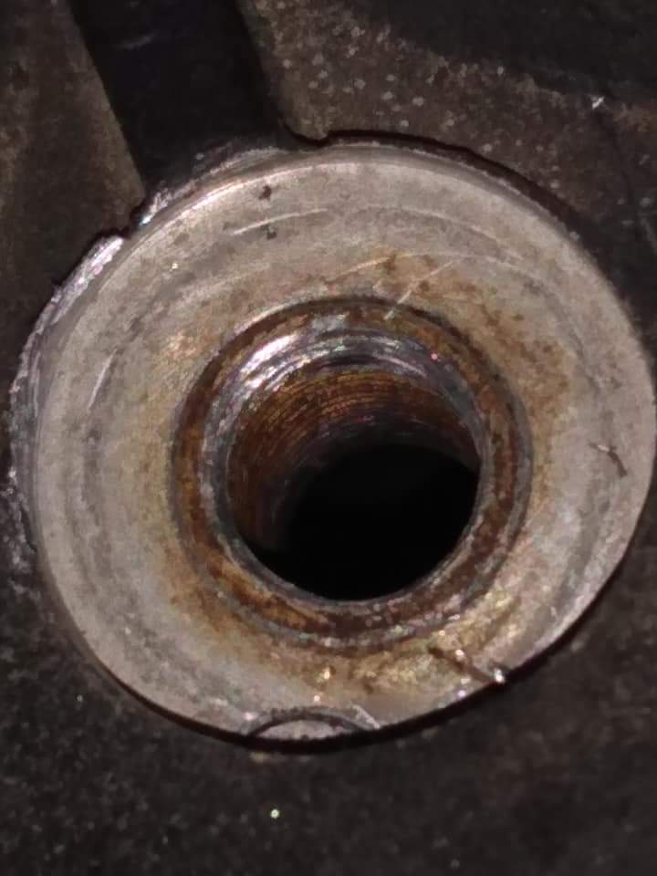

Crossed threads evident near top (changed this plug many times previously no problem). Damn!
Tightened in with a spanner to try and start the engine, one or two metal shards but removed using magnet from piston head as at tdc. Have ordered a back tap tool to fix better later so plug goes in with fingers. Am thinking of ordering a heli coil to fix permanently when remove head to do so, have spare gaskets to do this.

Dave, it is difficult to give advice when you don't know the experience of the person asking, so sorry if I am stating the obvious, no offence intended!
You can use jump leads from another vehicle to test for/eliminate battery problem; as far as the metal fragments are concerned, if they are attracted by a magnet then they simply didn't come from the cylinder head.... are there any stripped thread on plug which I suppose may explain them??
If the top couple of threads were crossed, but you have managed to get plug in correctly then I wouldn't worry too much, there are plenty of good threads if the plug is turnable by hand and goes in smoothly once correctly started. I think there is a tendency for some to overtighten plug and stress threads, just a gentle nip is sufficient. A damaged plug will wreck head threads in double quick time though, so always check.

#95604
Just to elaborate on plug situation
I have attached a photo of the damaged plug threads.
I had to use a spanner to get the plug all the way down, it won't turn with fingers at all. The good news it will come out as turned wrench back an forth as went in.
Am hoping to fix the threads when the back tap tool arrives then later effect s permanent solution with a heli coil at some point.
It's unfortunate that this had happened at exactly the same time as adjusted valves ( took it out to check piston height) will leave alone until recheck valve clearances and test.
