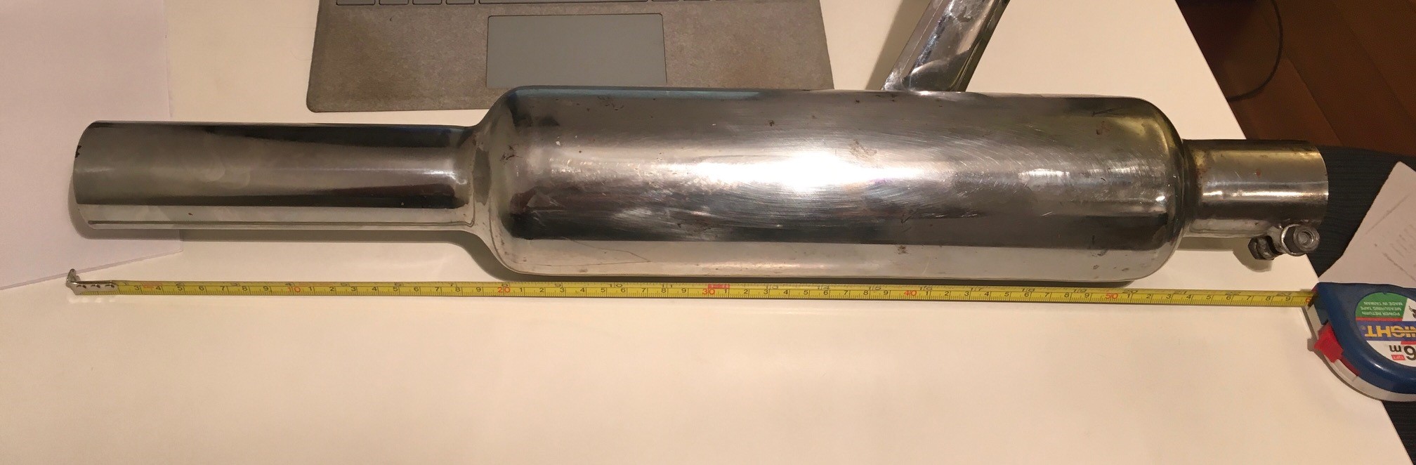

Hi all,
I joined the Enfield fraternity recently, bought a 2001 Bullet 500. Great looking maching but since I’ve had it, I’ve struggled to get it to run right, so hoping the wisdom of the group can help.
Air filter as per attached.
Exhaust: short pipe (Jidori?) also as per attached. Pretty noisy. Looks adulterated but being unfamiliar with these bikes, I don’t know if a baffle might have been removed (that said, I can’t see how!). Muffler length 23”, 48 mm opening. I don’t believe in loud pipes, Ibut rather in getting on with my fellow man and woman! Any ideas for a quieter pipe gladly taken. Tried a £7 DB killer, no change, if anything made it a bit more shrill.
Amal Mk1 Conc carb R300/930. Main jet is 220 (the previous owner had a 300 at one stage), needle jet: 107 - as far as I can tell, both genuine Amal. Pilot jet- confused on this point. I think some Mk1s have pilot jets that screw in, other are pushed in and hidden somewhere and only come in one size? Either way, I can’t see one.
Slide is 3.5 - but also marked 928 if that’s relevant? Would it be shorter than a 930 slide...?
When it's running, it goes ok. Inconsistent in starting. Of late not at all.
Never idles steady - always have to hold the throttle at traffic lights in case is splutters and cuts out.
Mechanic (who’s knowledgeable about old bikes) says I need a bigger slide (4 or 4.5) to lean it out. From your info, I’d have thought the problem is on the pilot circuit. Unfortunately, that’s the one I’m confused about how it’s jetted. He’s a good guy, but doesn’t have much time to go down this rabbit hole and parts aren't readily available in Hong Kong, so up to me to figure this all out.
Other than that, combustion chamber is pretty coked up. Within a 100km the new spark plug is filthy black, so it seems I’ve running very rich.
Any advice greatly appreciated. Happy to buy a whole new carb and a sensible spread of jets and start at square one if that’s the answer and ditch this mess. Just need recommendations on jet sizing from someone who knows these bikes.
Would changing to the original exhaust need different jets? Again, not a lot to choose from locally, so need to order this in from UK/India too.
Thanks in advance!
