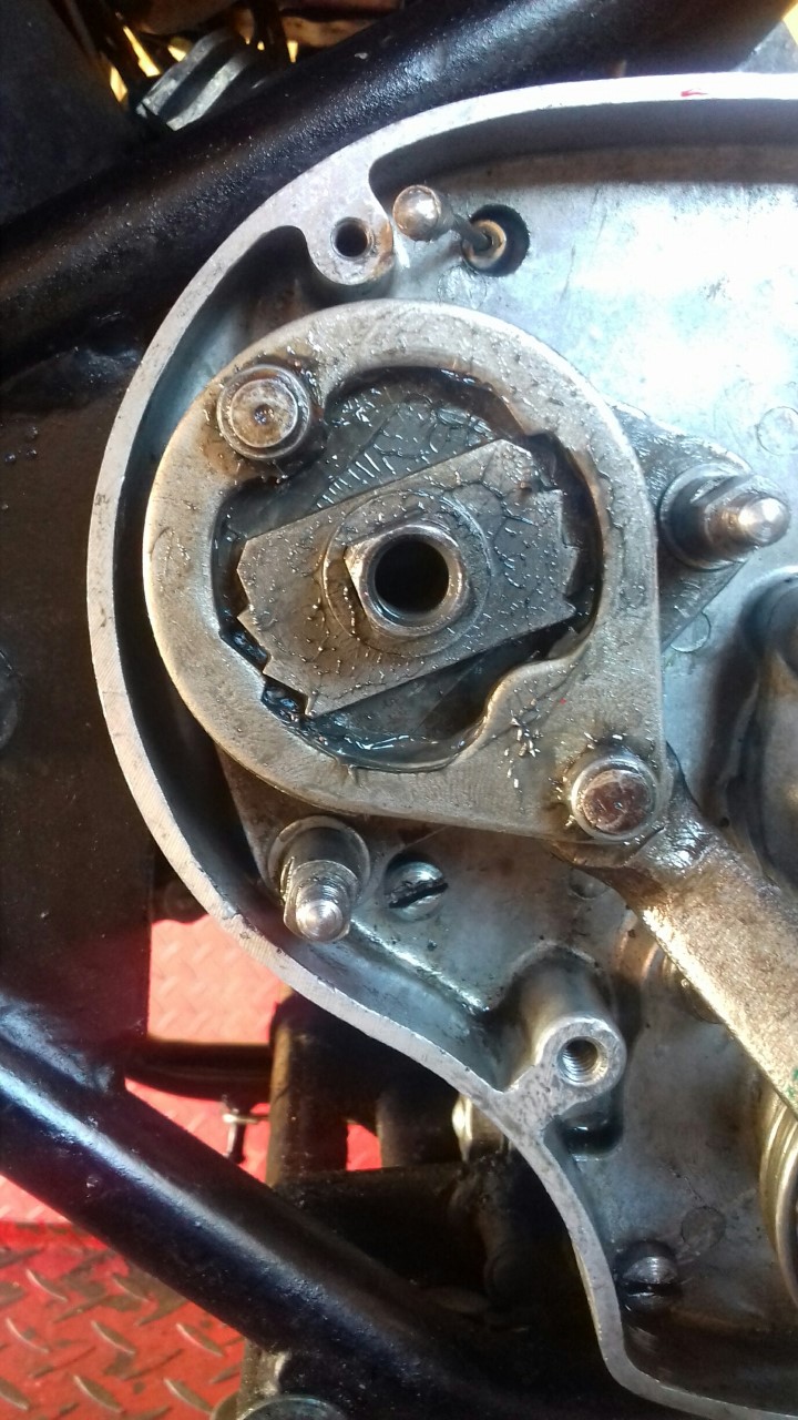

#95480
My 4 speed had a similar problem when I rebuilt the gear change mechanism. I followed the diagram in my workshop manual which meant I fitted the ratchet plate upside down because the diagram is wrong.
Reversing it cured the problem.
It should look like an upside down Christmas tree with the top chopped off. Rather than a right way up Christmas tree with its top chopped off.....

Thanks all for reply.
Someone asked me if the primary chain is not too thight.. i tensioned it with a little play as in the manual.. should i try slackening it?
Here's a pic of the ratched.. it is right this way isn't it?
Both springs are in working order and the mechanism has plenty (..) play to rotate freely.
Indeed i also had with the diesel, when mouned the gearshift pedal a notch too hight, touching the neutral lever. This is now not the case with this bike.
Can a too thight detent plunger (which by thge way, can rotate in its case, the notch/dent is not so good..)be at fault? Then it should keep into gear more and not less?
