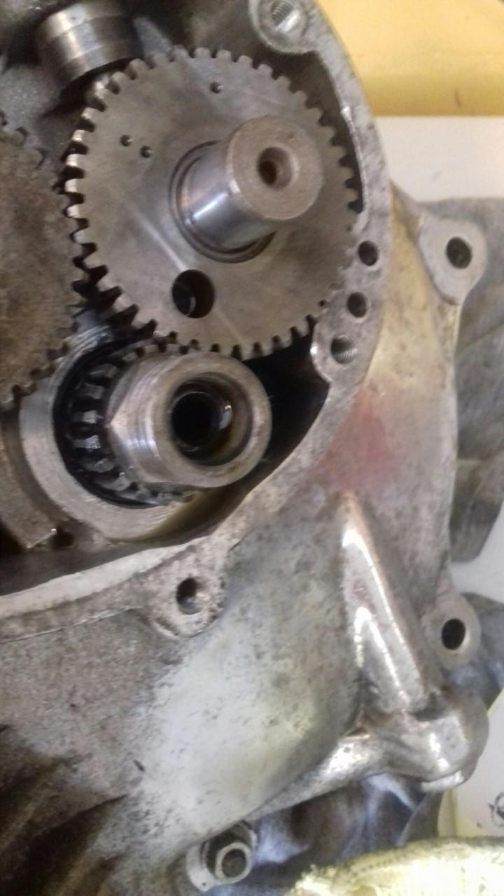

I have a (stupid) question about the oil feed quill on the right side of the crankshaft, the exploded view confuses me.
Do i need to mount the (cork) oil feed ring AND a rubber bonded seal in the worm nut?
https://accessories.hitchcocksmotorcycl ... ges%2F1618
My worm nut does not have any rubber seal in it. I though that's where the cork quill goes?
Would be tankfull for convincing replies; Halting the building off of the bike... :D

Is it just a quirk of the photo, or do RE timing gears really mesh so badly?
You buy just the worm nut which has rubber seal bonded inside it if you are not happy with cork version.
I hope it’s a quirk, because it looks like it’s not touching at all!
