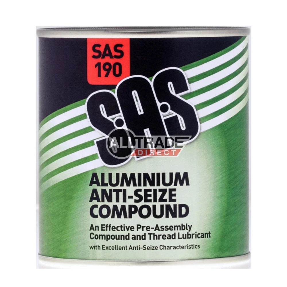

There's an aluminum version of copper grease that we were using in the RAF a quarter of a century ago.
