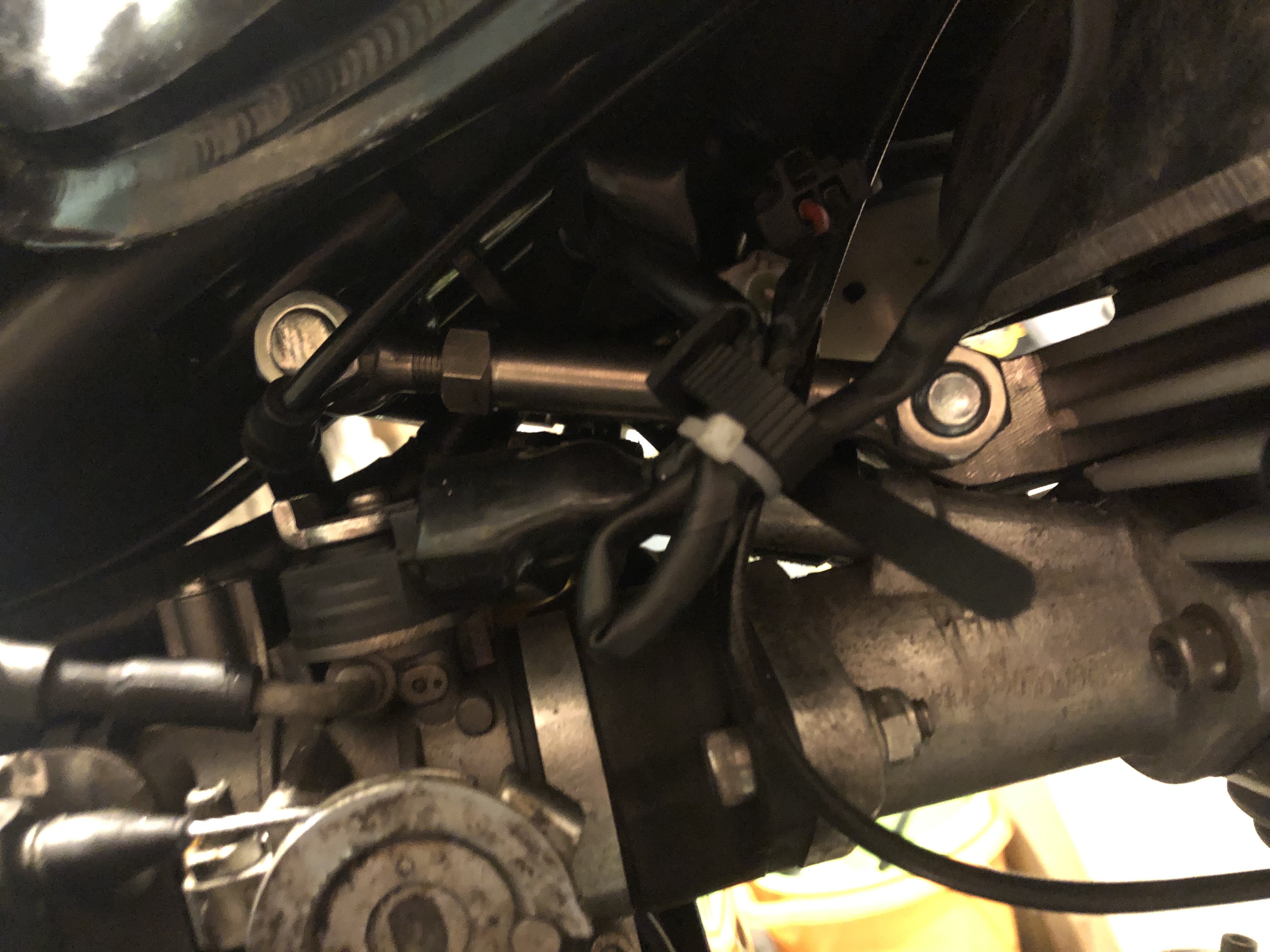

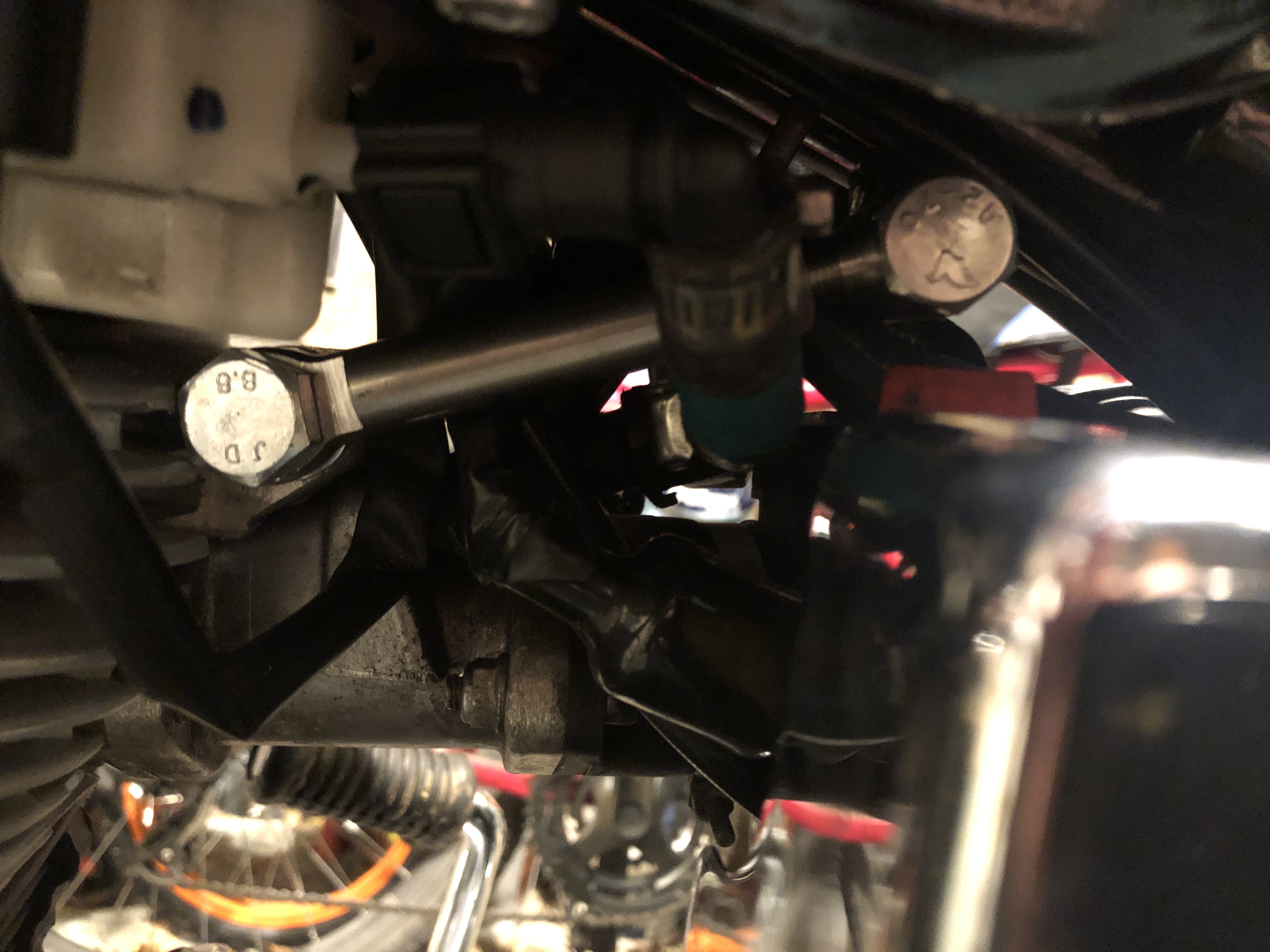

I did the Double Adjustable Head Steady modification to my 2018 C5 a few days ago in an attempt to reduce vibrations, and I am pleased to report that so far (only a few miles done) it has made decent job of curing vibrations, probably by about 50%. The new head steadies were from Hitchcocks.
The original Modification is detailed here:
https://forum.classicmotorworks.com/in ... ic=29706.0
The only difference I made was to drill out the front engine mount from M8 to M10 by using a 9.5mm drill bit and honing it by hand to get a tight fit on the new bolt. I used a 70mm bolt for the front mount and 80mm for the rear mount near the seat.
Some pics below
By Haggis
#95008
You have it on opposite way round to mine.
Smaller bolt goes in the cylinder head so no need to drill or ream anything.
This is the end the top hat spacer goes in so it fits the smaller bolt.
By Mann
#95009
I tried them both ways round and found this to be the best way on my bike, with the top hats in place on the head side and an M8 bolt it felt like there was some play, hence drilling the mount to M10 and not using the top hats.
The head was not aligned to the frame at all well and I had to shim the mount with washers so that the head steadies fitted snuggly.
Seems like each set up is a little different. I am pleased with the result.
@Haggis, did you use 1 or 2, and has it helped with vibrations?
