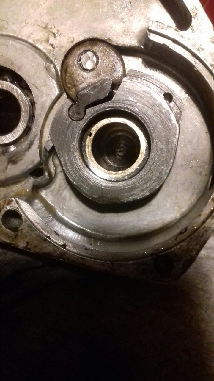

Hi, 4 speeder with new bearings, bronze bush ist all the way in, Kickstarter bus is reworked and layshaft end goes all the way in. cannot get the cover (not the end cap)on, there's about 3-4mm space between the parts. The obstruction is somewhere on the layshaft..
Installed the close ratio sprocket, also all the way upon the collar,
Can anyone guess what is going wrong?

Sat Jan 16, 2021 5:30 am
The kickstart assy looks like this, but still the pawl rattles in the sprocket.. i do not know why, i did not change the pawl, i did change the sprocket (close-ratio)
How is this pissible? It has worked with this pawl and assy!

Hi, 1. check you have the mainshaft dog the correct way round.2 check the oil thrower is engaged on the mainshaft shoulder. Ensure you have the correct one on the inside of the cover, it should be flush with the gear. Stick it on with grease. 3 the pawl should be flush , it looks like its standing proud. The half moon stop should hold it clear of the ratchet. I would check to see if the new gear has the same clearance as the original. 4. is the layshaft fully engaged at the back of the gearbox. Vince

The pawl should be 'flat;'? okay.. strange thing is that it worked like this for many years, so i have to make a new dog that presses the pawl further down.,
