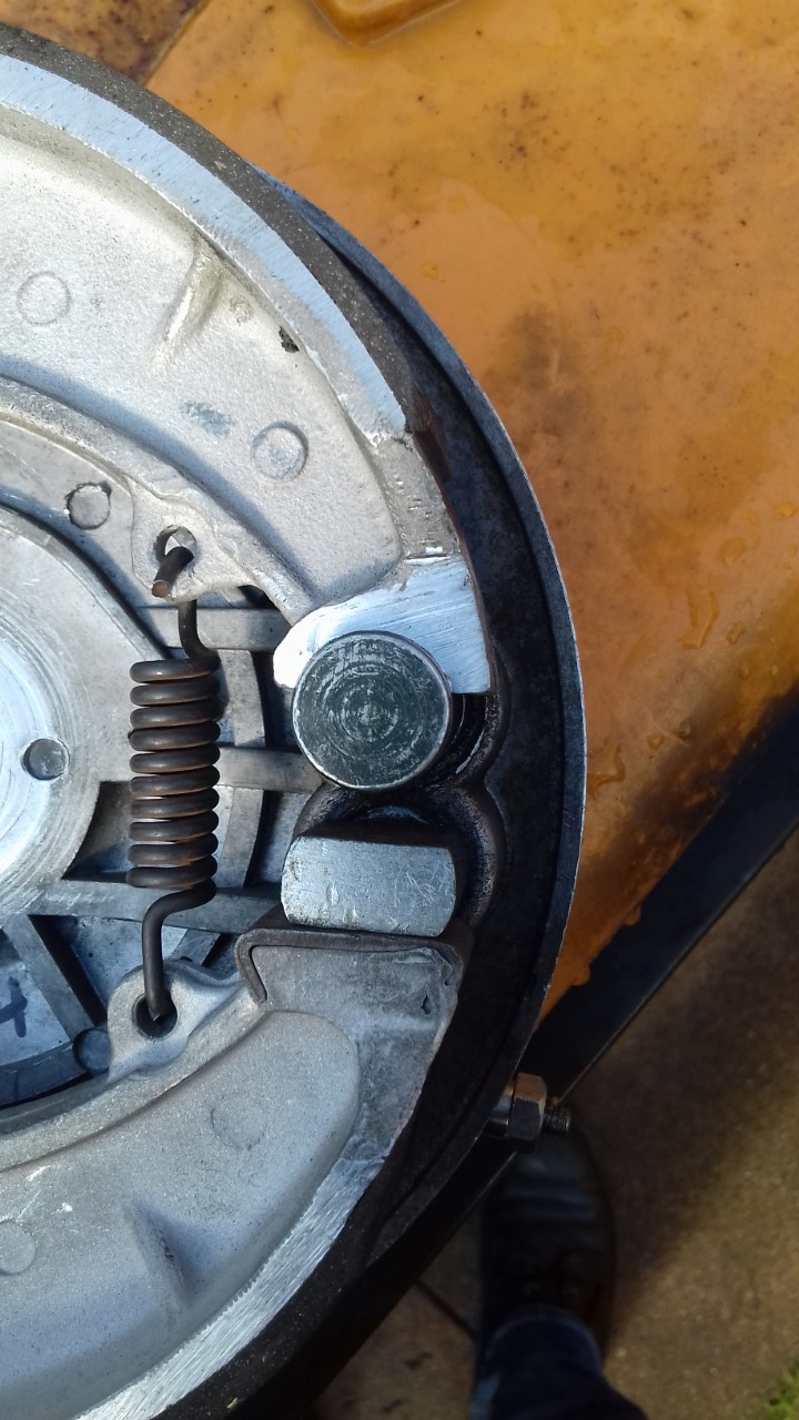

I honestly must mention, i reworked the brake cams on an lathe to ca 50% original width for more stopping power. This also means evenso more strain on the pivots. Would it be too much?

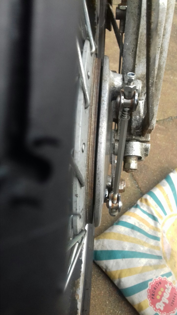

An other thing, do the old style brake plates need a different spacer? I cannot remember anymore. But when i mount the older model brake plate, i can see between the brake plate and the hub! I cannot remember this was original the case..

reworked brake cams, and space between old style plate and the hub.

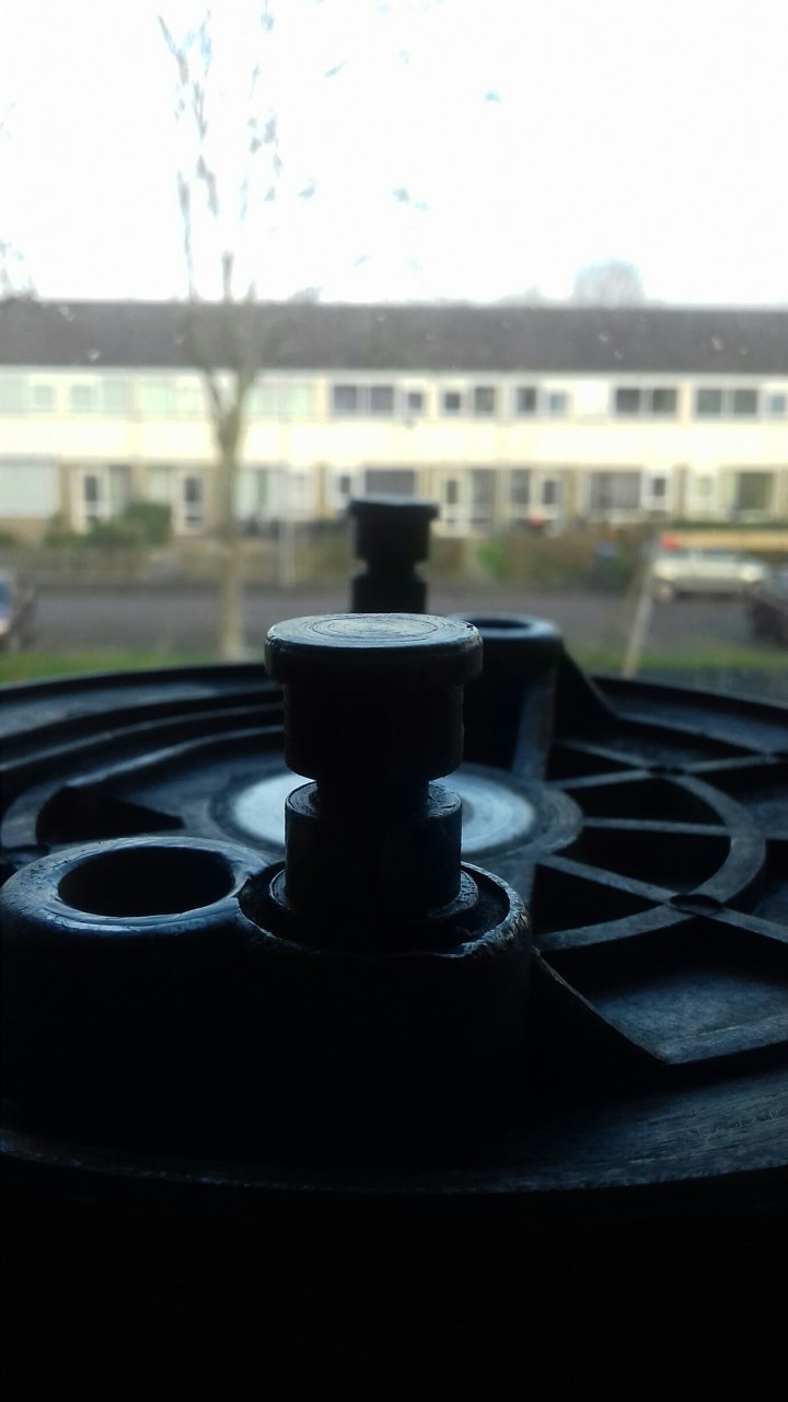

I keep wondering, the bend pivots are caused by;
1- factory mistake
2- due to a few times 'grasping' of the brake (it should be able to withstand this?)
3- because of 50% less cam width, which causes evenso more pressure on the pivot.

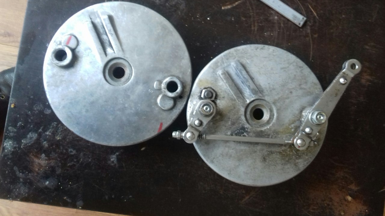

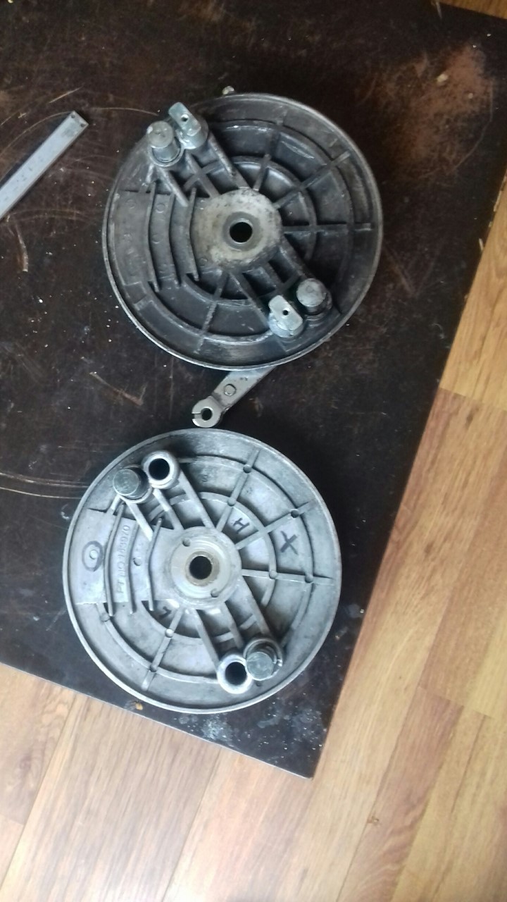

The pivots in the older type brake plate are scewed in and secured with a bolt on the other side, maybe this is sturdier?
Pic of the older and 'new and improved' type side by side..
