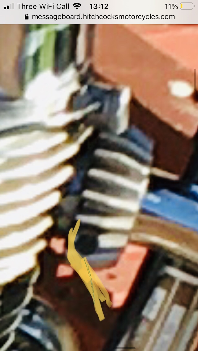

Hi my 2007 royal Enfield bullet 350cc has started to drip oil from the exhaust cooling ring bolt where the exhaust goes into the head I have tightened the Allen bolt up but not sure if these have a seal or it needs something to stop it
Photo attached showing where oil leaks from

Can you tell us which 350 Bullet you have that has the exhaust pipe fitted with an exhaust ring with bolts?
It's not possible to tell much from the photo.

If it's a standard classic iron barrel 350 the exhaust header is just a push fit in the head. The finned collar is just clamped round the pipe and does not hold the pipe into the head.
If you have oil leaking from there it's would be coming from the combustion space and the bike will be smoking.

Yes, PeteF - I can see now the orientation of the photo.
And agreed - oil from the exhaust pipe will be oil from the combustion chamber - which will be oil down the valve guides or blow-by from piston/piston-rings.
