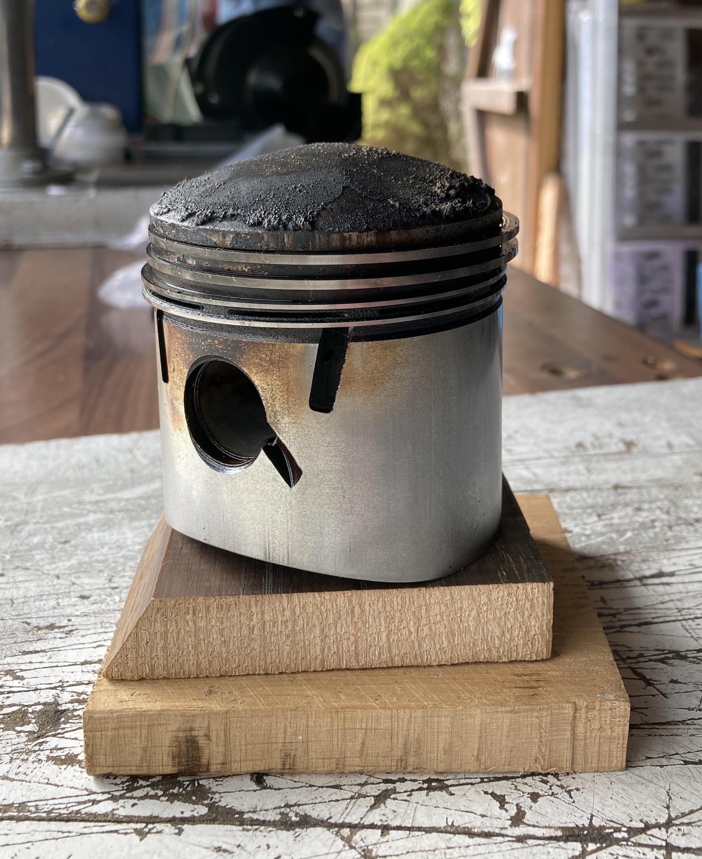

Fitted the meteor piston and retarding the inlet cam has give me that little extra I wanted, I’ll stick there.
