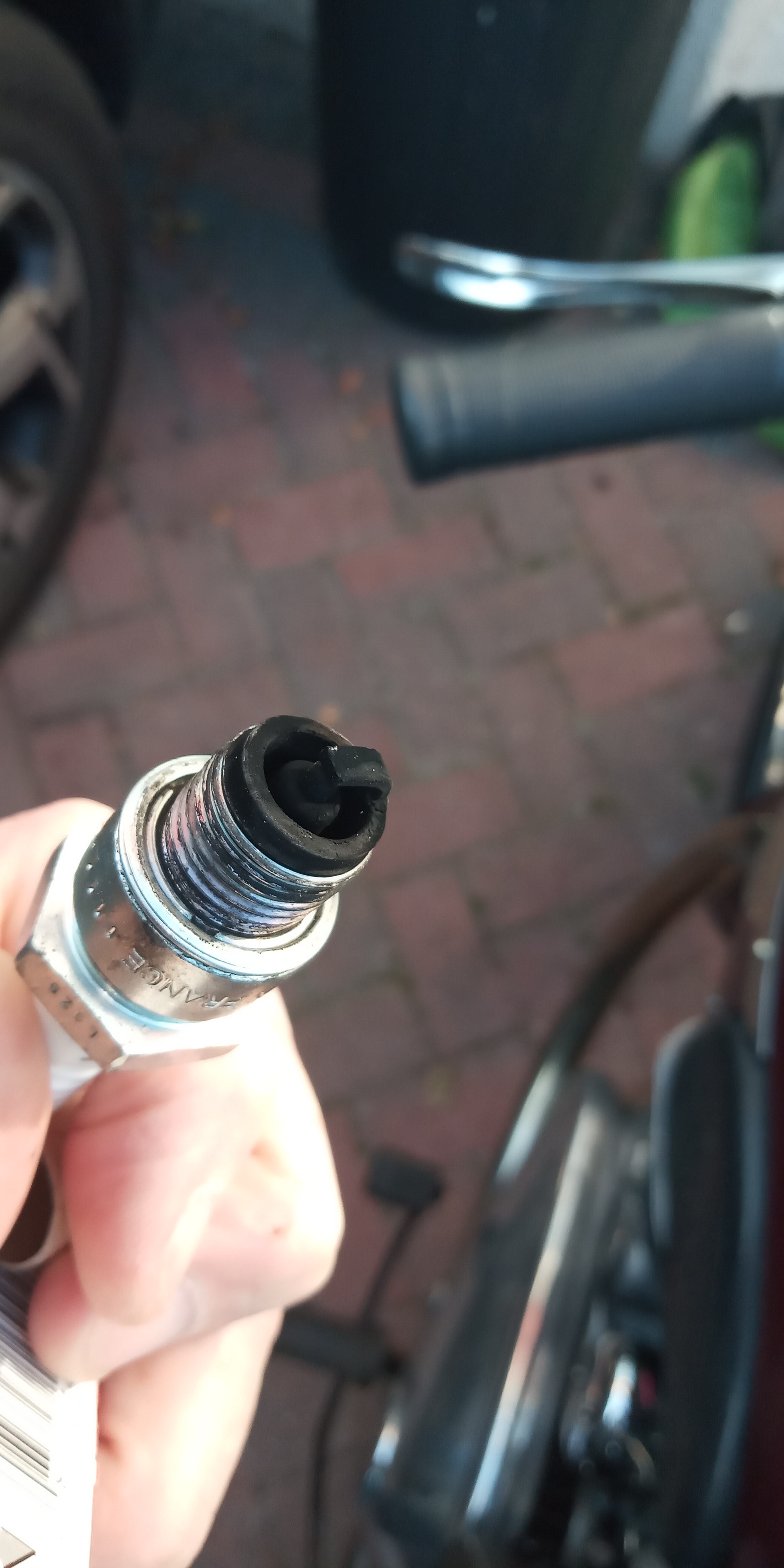

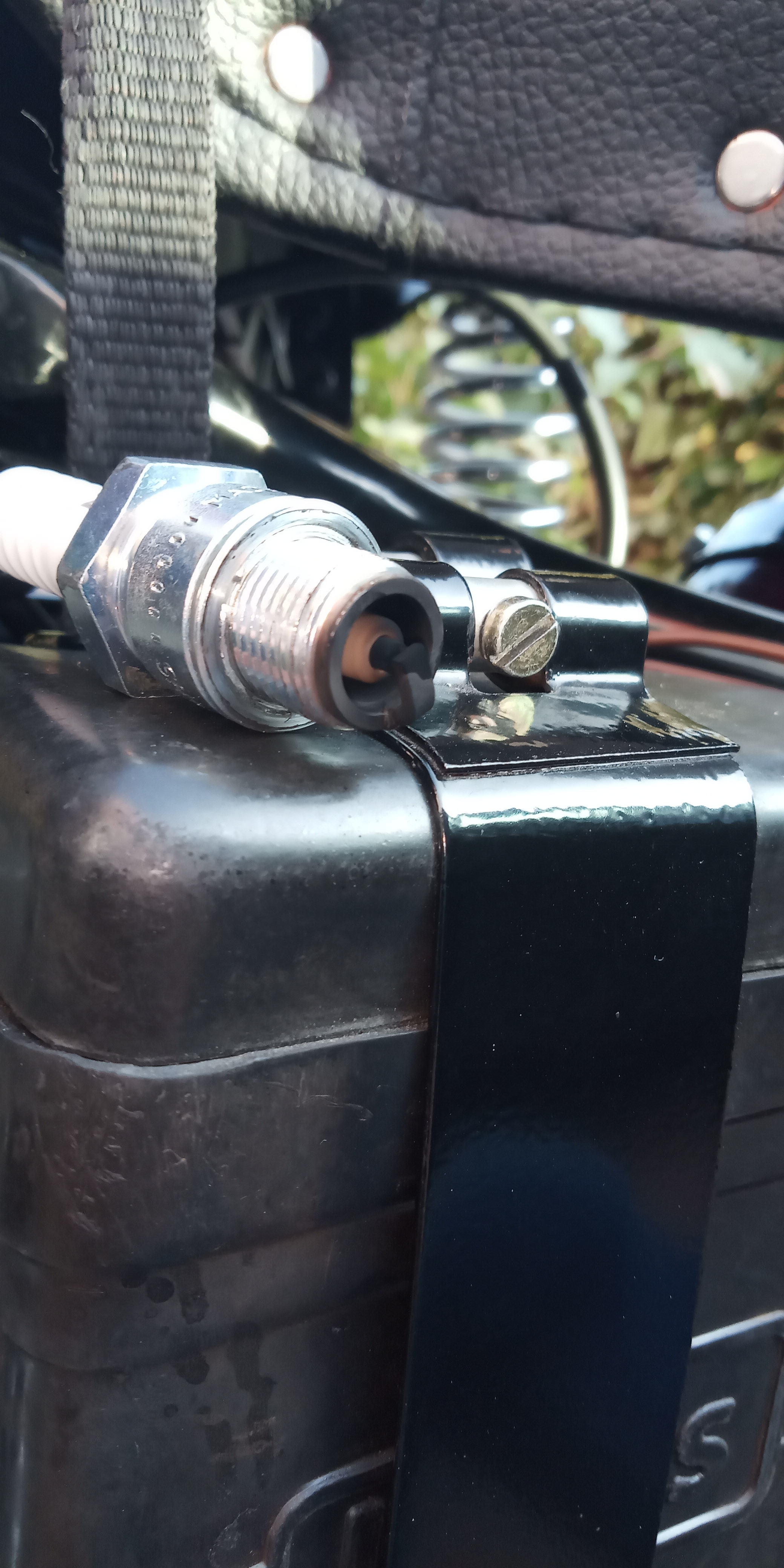

By Tomshayes1
#93129
Plugs very black and sooty.
Then just stop working..
I've dropped the needle one notch to position 4...
It was originally on mid (3) but way too lean..
I raised it to 5 but too rich. So on 4 now seems OK.. I will keep an eye on the B6HS until the BP6HS land.. I haven't tried 7s yet.
Tom
By Tomshayes1
#93133
Needle Position 4
The sooty one was on needle position 5
