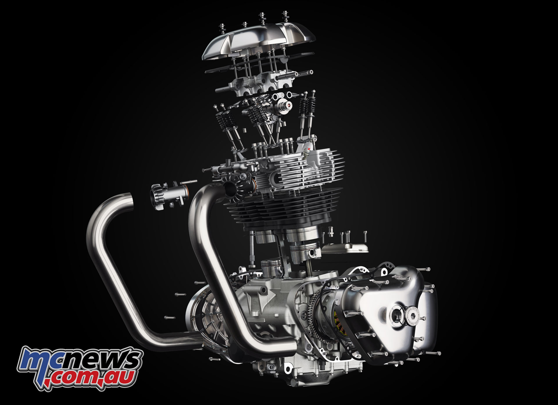

By Presto
#92988
A very nice picture of a very nice engine!
