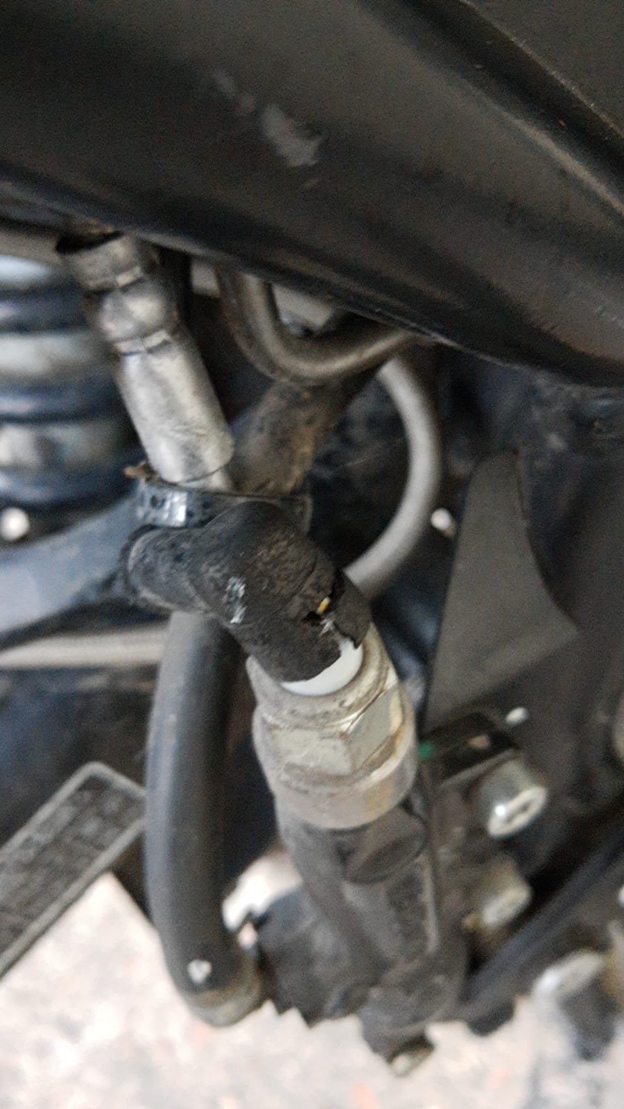

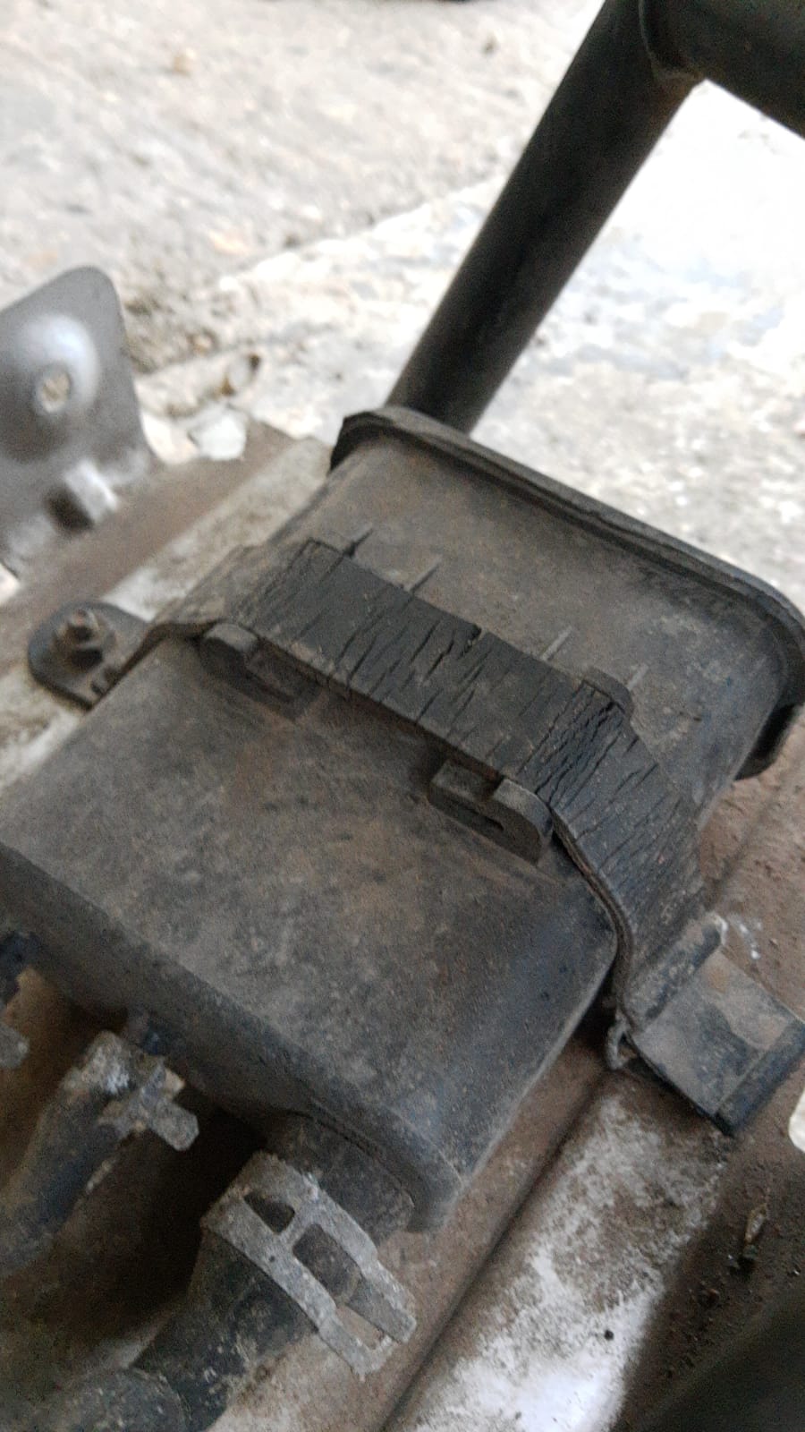

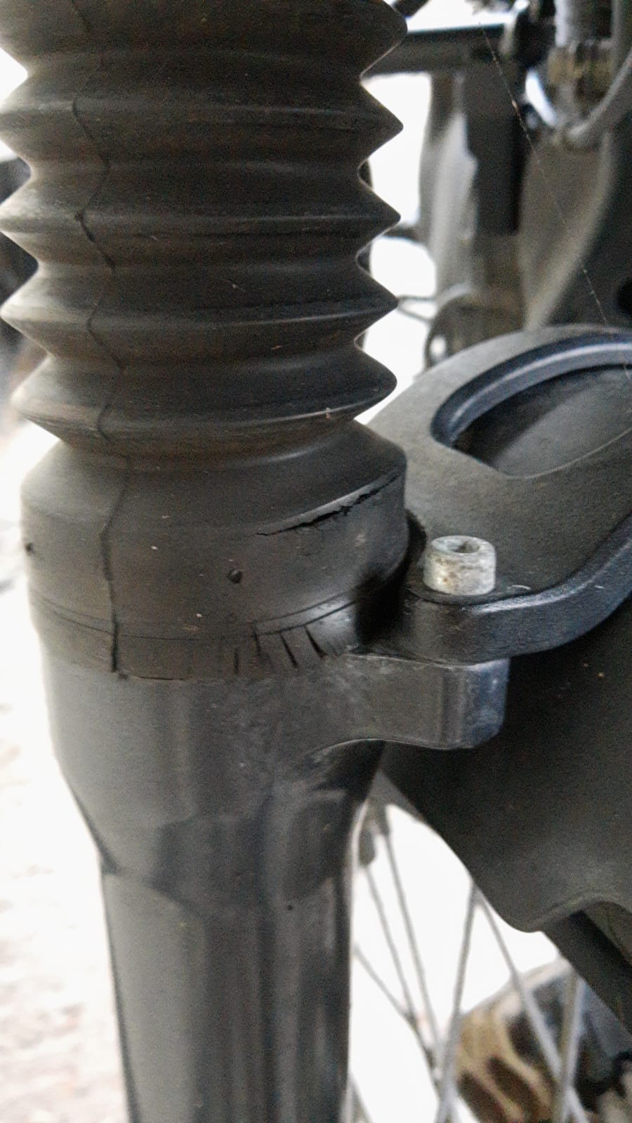

Quality of the rubbers.
Current bike is 1 year old. Anything rubber is cracking or broken. Pipes are all fine, but straps, holding everything from the battery to the PAIR system look like they came out of a pyramid. The gaiters on the forks too look like they are at least a decade old.

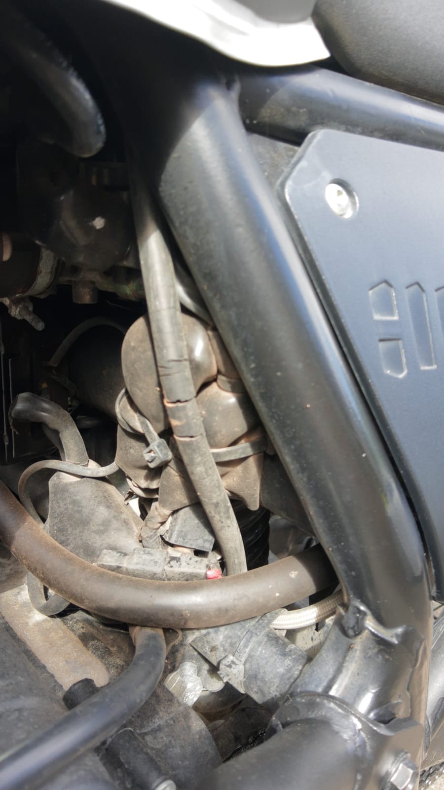

Wiring loom.
It doesn't fit. I'd accept it on the first production batch, But after 4 years of production they should have fixed it.
Everything is too tight on the bike to the point the correct mounting points for relays and such can't be reached, and they are held on with zipties.

Noodles - do you live on the coast by any chance? I am just over a year in with my Him and no problems at all.
Reason for asking if you iive on the coast is that a salty environment may be the cause of your rubber problems.
What mileage have you done? I have done just over 3000 miles on mine in the 1st year.
#92766
Is it parked outside? More likely to be UV damage to the rubbers than salt. Still unacceptable ona bike that age. maybe improperly vulcanised?
I can recommend giving any replacement rubbers a good spray of Aerospace 303 liquid to protect them from UV damage.

I use silicone spray on a occasional basis on all rubber. Don’t know about RE rubber, but the gaiters on my R65 were as new after seven years.
Bike was kept outside under a cover and used all year round.

Various rubber bits have cracked and perished on my C5 too. They used silver paint after playing the exhaust on the Continental GT; that looked awful. Wiring loom on my C5 is a joke and many suffered from broken earth lead and dodgy connectors. When my C5 had the EFI fitted it too would stumble or cut out on idle; you could try raising the tick over a little. It's a Royal Enfield thing. The best ones by far are the new twins, designed by ex-Triumph employees.
