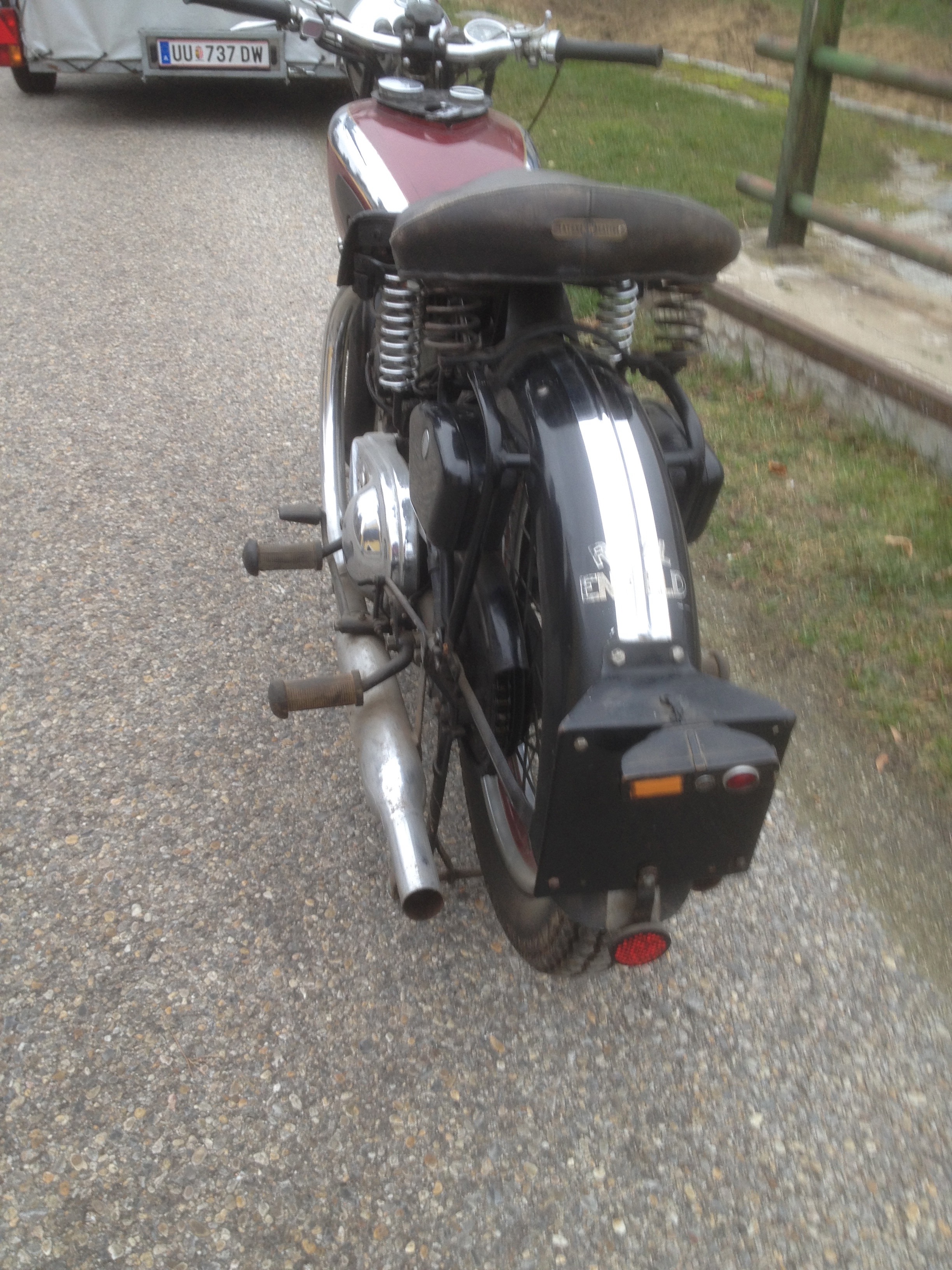

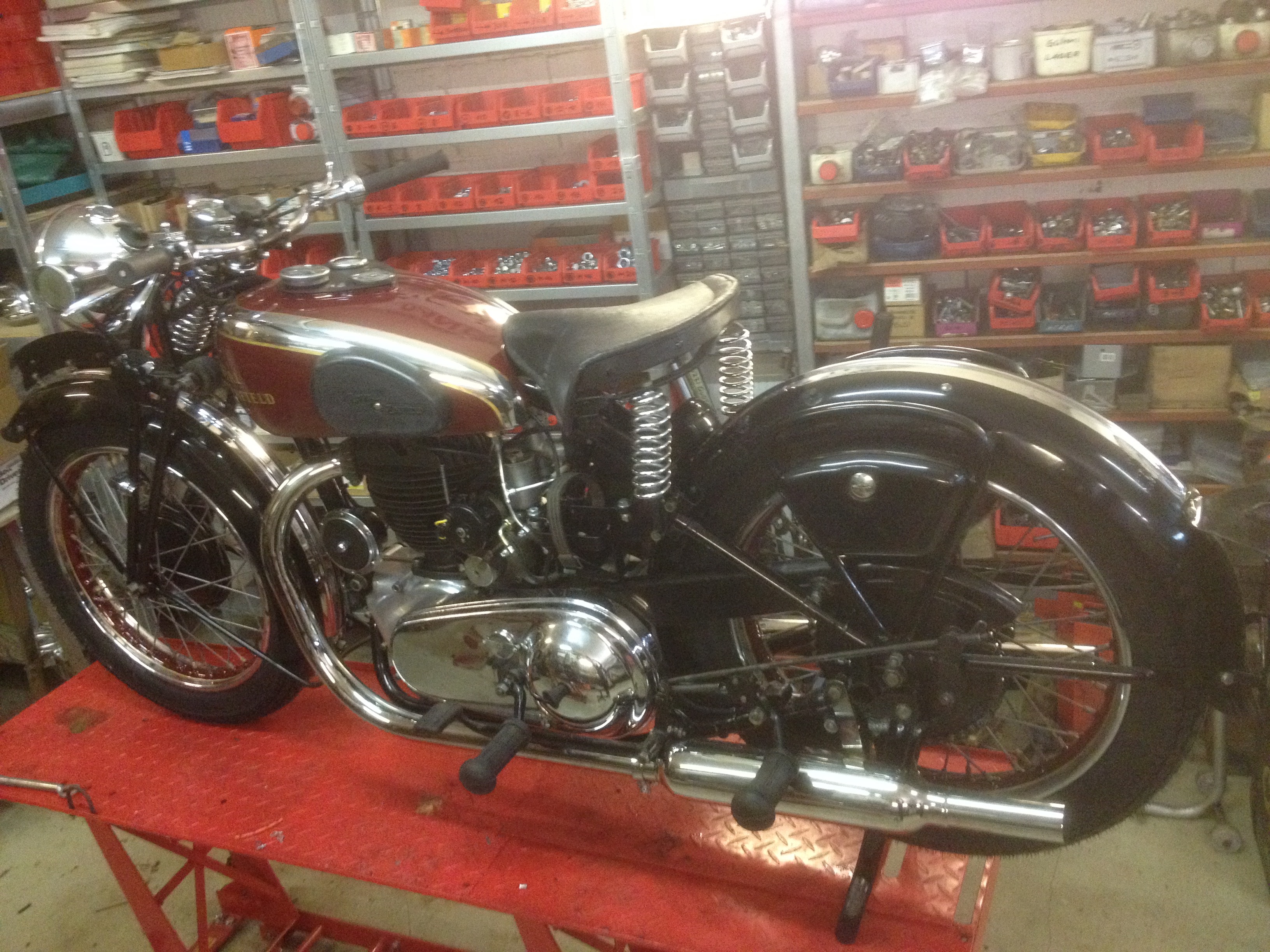

Sorry for so many questions , but my brain is squeezed since days about this topic and I don't find good answers on the net as this is an oldie! Attached some pics, which should explain.[
