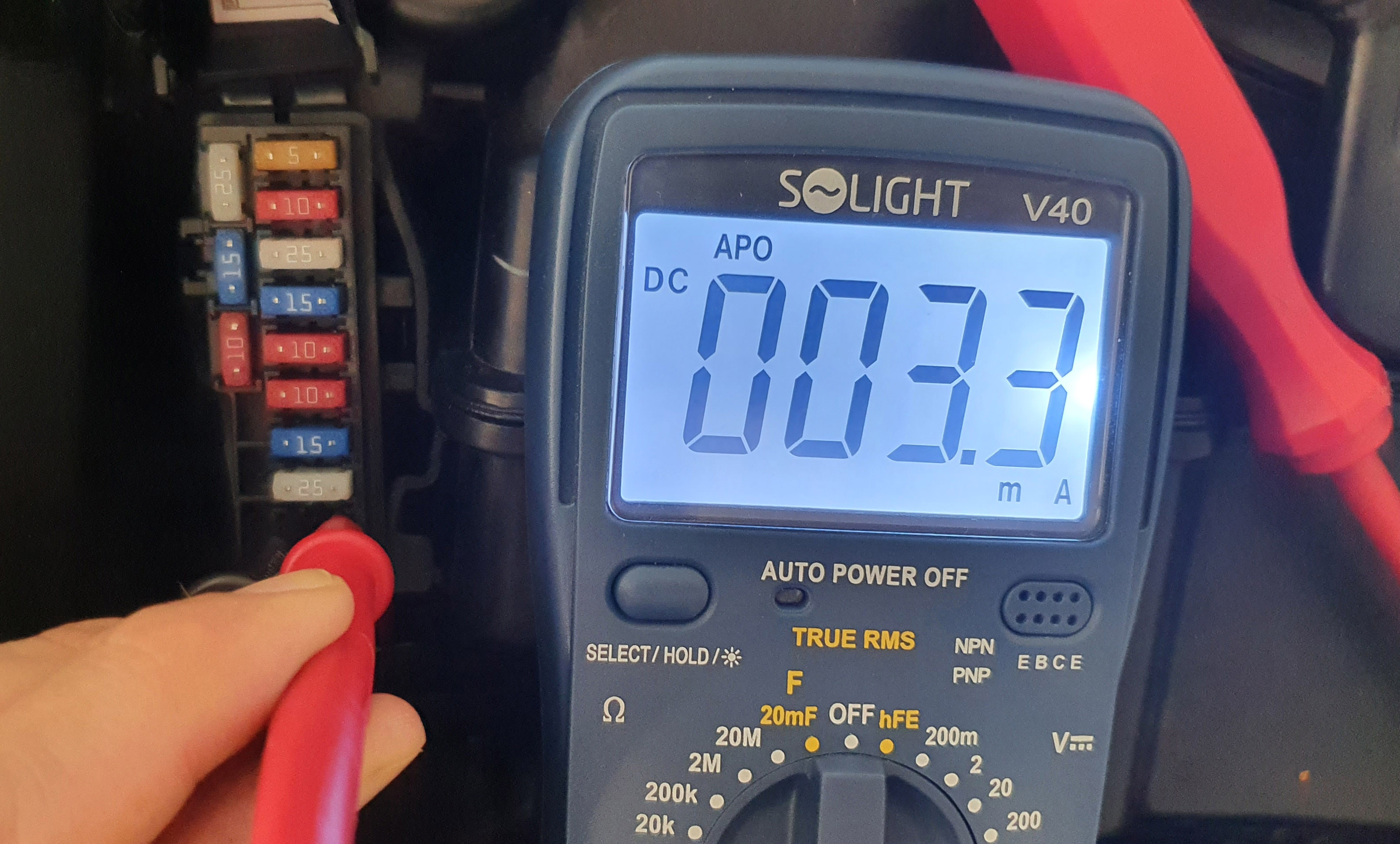

Hello, fellow Himalayan owners. I think I have a problem with a parasitic draw of my Himalayan 2018. The problem seems to be in the Recharging circuit (this houses the RR unit). Even when the bike is completely off, this circuit draws 3.3 mA, as seen on the picture. I'm not completely sure, but the circuit shouldn't draw anything, it should read 0 mA. Can somebody help me, and check what kind of draw is on your Himalayan?
The measurement is easy. Just grab your multimeter, and set it on mA (direct current). With the bike off, open the fuse box, and remove the bottom 25A white fuse (it's called F1 fuse in manual). Measure the exposed contacts in the fuse box (polarity doesn't matter). Exactly like I measured it on the picture. What kind of mA reading do you get? Thanks for the help!

So I completely removed the RR Unit from the bike and it still shows 3.3 mA draw. Maybe it's completely normal, and I'm just needlessly panicking :) It's just my battery goes dead after a few days without starting the bike, so maybe the battery is the culprit. It keeps the 12.36 V after a full recharge, which I guess it's not 100% healthy battery.
Anyways, there are only two circuits drawing the power while bike is off:
F1 (Charging circuit) - 3.3 mA
F2 (Main fuse) - 0.7 mA
Other circuits, like Instrument Cluster, Horn, Lights, ABS etc. draws 0 mA. I think logical place for clock or processor keeping track of mileage would be connected to Instrument Cluster Circuit, but I may be wrong. I compared it to my friend's RE Classic 500 EFI, which draws 0.3 mA altogether. Altough, it doesn't have any fancy digital clocks, odometers and such :)

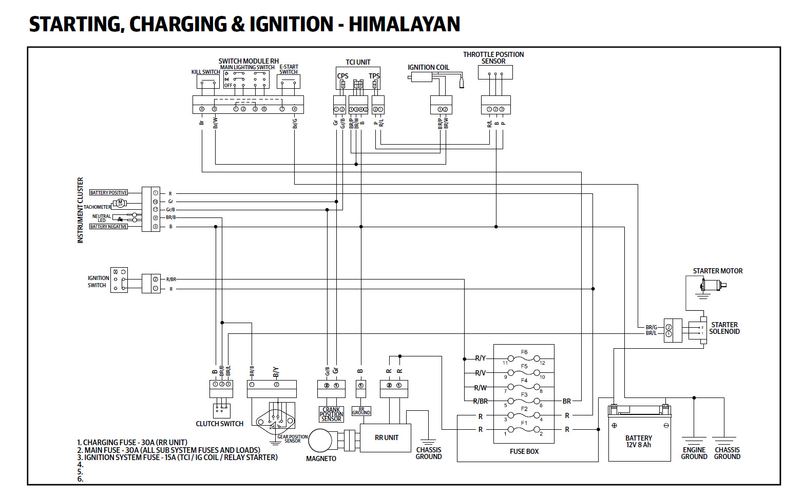

I'm enclosing the wiring diagram for Charging circuit (F1 fuse), it seems that it's only connected on RR Unit or am I wrong?

I’m no auto electrician but I did once manage to trace the source of so-called “dark current” that was flattening the battery on my MX-5. I didn’t use a wiring diagram to do so. I disconnected the +ve battery lead and connected the multi- meter between the battery +ve terminal and the positive lead and took the reading. I then simply removed each fuse in turn until the dark current reduced significantly. It turned out to be the aerial, which on my (much missed) Mk 2.5 MX-5 automatically extended when the ignition was turned on.
I’d be inclined to adopt the same approach. It is of course entirely possible that a 3.3ma discharge is normal, which is why I imagine you are asking another Himalayan owner to check theirs, but if nobody confirms or disproves this then my suggested way of testing may be of help. Like I said, I’m no expert but I believe dark current is an unexpected source of current drain, over and above what is normal. BTW I think that the ECU probably draws a small current to maintain any stored fault codes. It’s a long time since we all had to replace the CMOS battery in our PCs.....No doubt a competent person will correct me, but the method I used in ignorance did work. Good luck.
